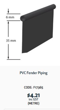

  7. Try the local rubber supplies (U.E.S.), they have branches in most states. They have the black PVC? type, it hangs in there well.

    Thanks for that info ..... I've been using UES for many years and never thought of them to have it.
    Gratefully appreciated.
