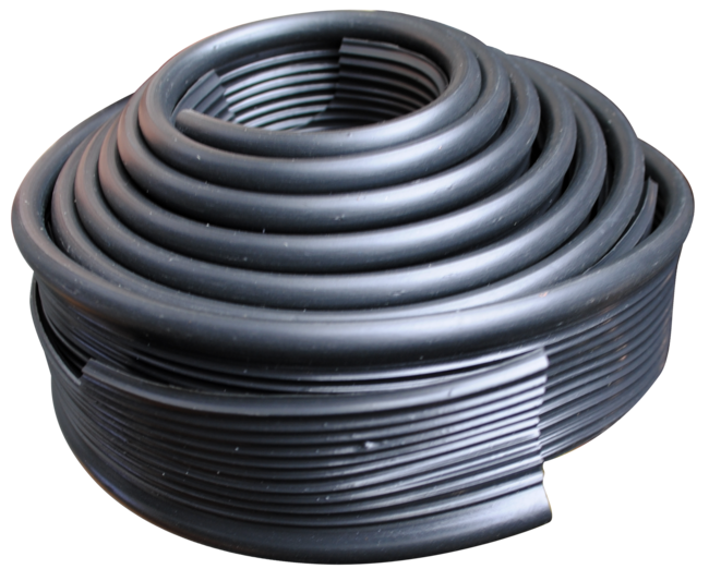

    I bought a spool of heavy rubber welting years ago when I put fender flares on my OT Bronco. Bought it at a 4X4 truck outlet. It is a full inch wide with a 3/16" hollow bead. It is easy to use, conforming to curves much better than the cloth covered restoration type sold. Still have some, in fact enough to do my A coupe. DSC06816.JPG

    ^^^ This Is what we use. A trick is if you are trying to get it to conform to a tight corner etc, Insert bailing wire in the hollow core and shape it-wife came up with that one when we were trying to get it to conform on a tight radius on a 37 woodie front sheet metal. Use that method now in places where it does'nt want to conform just right
