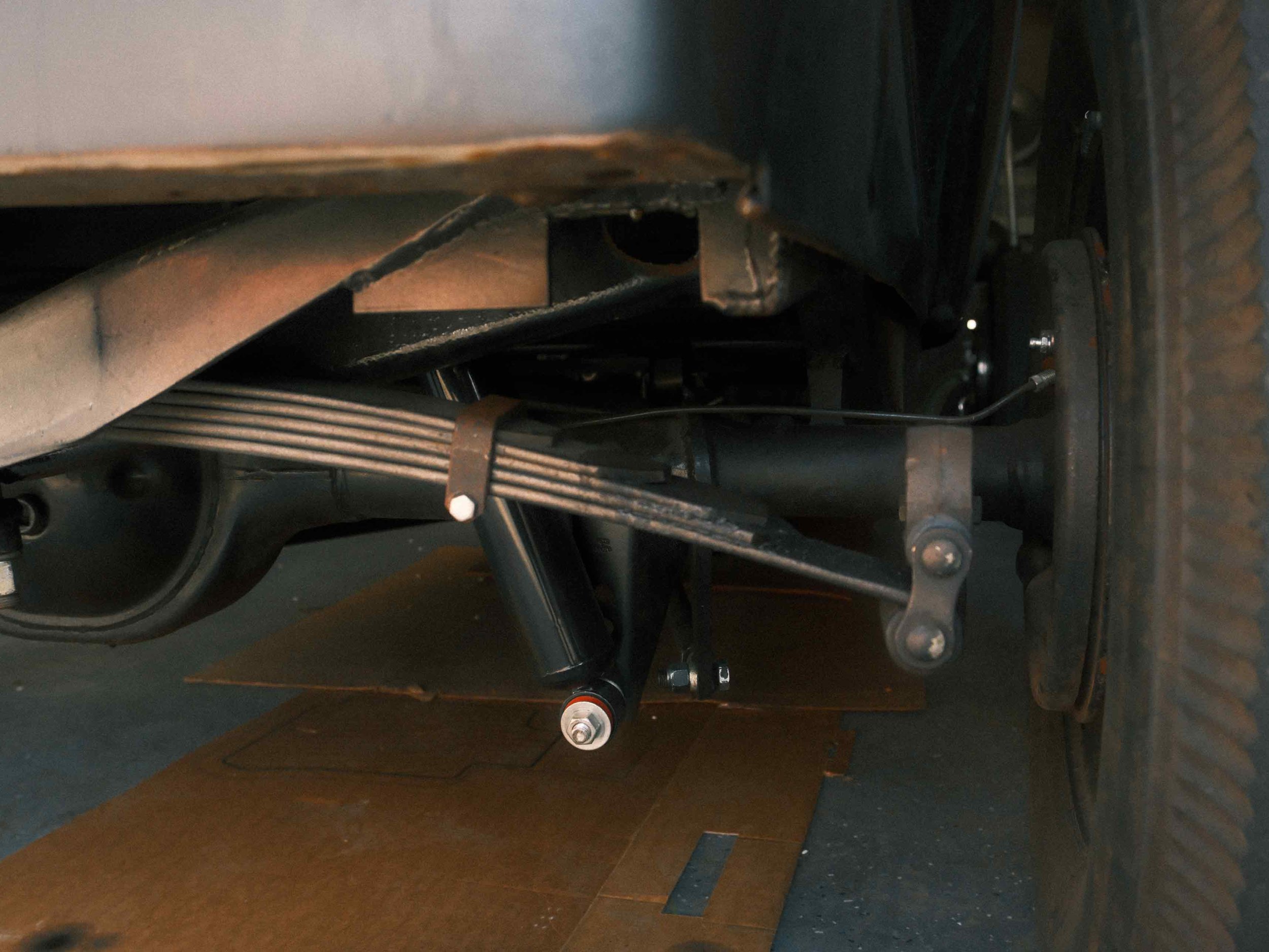

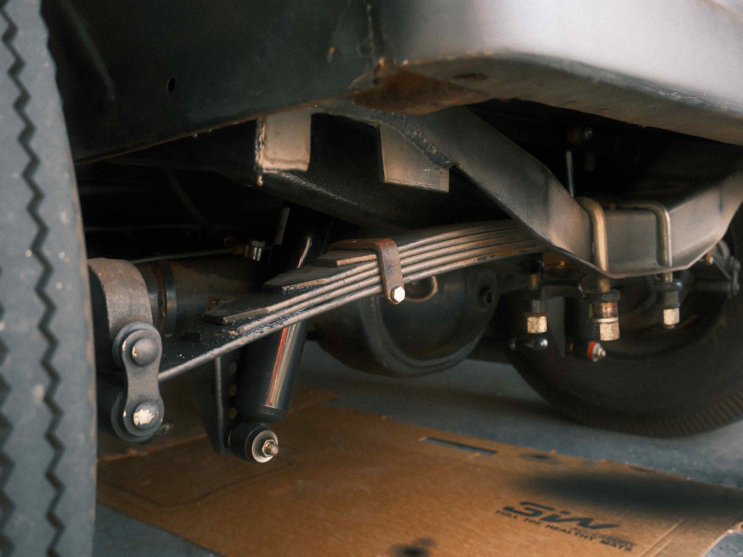

    Ok so bellow are the rear suspension images. As you can see a lot of leafs were removed, and I do not have reversed eyes, so if I was to go with springs I could go with reversed to lower about 1.5in. So when I got the car, the leaf following the main leaf (the second one) was actually touching the end, so I actual cut off about 2 inches off and while doing that I added some grease in between leafs. Question... is the shackles suppose to be at a 90degree or is this also wrong. Right now the gap is about 3 inches between tires and top fender line.
    Last night I was watching a show (Hotrods by Troy) that gave me an idea, they were talking about rear suspensions and how he sets them to ride comfortably. He says he usually sets the coil or spring with no shocks and makes sure he can compress the spring by simply pushing down the car, once he gets the right softness/stifness he then introduces the shock, so it got me thinking my shocks might be too stiff for this light car... they are new gas charged. I do remember when I replaced them I was able to push my car down by hand, and I actually drove the car with no shocks at around 30mph just to feel the springs, soooo it got me thinking. I will take my shocks off again and drive in an uneven road not too fast and see how it feels and maybe. .. maybe ... search for really soft shocks, with very low compression resistance so my springs can compress easier.
    DSCF1244.jpg DSCF1246.jpg DSCF1247.jpg DSCF1248.jpg DSCF1249.jpg DSCF1250.jpg

    Well right away I can see that main spring is to long. Look at your shackle angle! Those should be 45 deg or close. I bet it’s bottoming out the spring at the shackles when it compresses. Does the car have a pan hard bar? With the shackles nearly vertical it would make it want to sway some as well.

  22. With a spring behind the axle you should be able to get it pretty comfortable. The spring is too long, you could go with an aftermarket spring (the right width) and then play with the number of leaves to your liking. I personally don't like coil overs on As (or anything else).

    Is that a 2", 2.25" or 2.5" wide spring? What is the width between the hangers centre to centre? What is the width of the spring when it is off the hangers? The spring width should be about 3" less then the hanger width. If that is a 2" wide spring, you should probably be running 9-10 leaves. A good spring shop should be able to reverse the arch on your main leaf and there are hangers for the 2" spring that are 2.5" pin to pin compared to the normal 1.5". Posies or Speedway sell that hanger, part #2057. The second leaf from the bottom appears to have been cut short taking tension from the end of the main leaf. I just did all this with a 37 front spring to go in the back of my 30 Tudor. I have an aftermarket frame that did not have the spring kick to take a Model A rear spring. I just removed the coil overs which in my opinion looked terrible. All will be finished this week and hopefully it all works.

    That's not a model a rear spring. So swapping for a t spring isn't happening. It's possibly something like a 40 front spring. Panhard, good, so shackle angles aren't an issue as long as they don't bottom out. Gas shocks usually way too hard for a light car. Oil filled is what you need. I like the way the car sits as it is.

    Adding leafs isn’t going to fix the shackle angle it needs a shorter main leaf.
    can you measure how far apart the hangers are? From center to center of the mount on the rear axle side of the shackle.
  27. Maybe my eyes but this looks like a generic aftermarket modern spring. The leaves do not stack tight, it's too long and the shackles are the wrong angle. A spring when it squats will get wider eye to eye and the shackles have to swing to do that. I would look around for a good used original spring, sandblast it and set it up right. Also check the maker of the shackles. Long time ago the only ones available were made in Argentina. Totally wrong dimensions. But then that was a long time ago, I am dating myself again.
    Looks like this is one of those mail order spring mount kits on the rear end. The spring is just not up to quality, the mounts mounted on the rear end may be welded in the wrong place for this installation. The mounts will work, the spring just is not right.
    If the coupe was perfect, all you could do is put gas in it and drive around. That gets boring after a short while. The fun is working on it and figuring out how things work. Then guys like us get to chatter on the internet telling stories while watching you do it. So in the end we all get to have fun while watching you work/have fun. Think about it. Not the destination but the road getting there !

    Yeah I cannot even see an arch on these so I'm not sure where they came off, and yes the shackles still work this way, I just order some cheap oil filled shocks, hopefully soft so the springs can do their thing

    Totally agree, these are not Model A leafs.. honestly who knows from which car they came from, and yes you are right, this is not the original rear end so the mounts could be welded on wrong too, modified cars are like box of chocolates .. you never know what you're gonna get. lol anyways, I just ordered some cheap oil filled cl***ic VW shocks, this might be the easy fix, because I just took the shocks off and its much softer.. my new gas charged shocks are too stiff on this light car and its not letting it compress, hopefully this works, I will update once the shocks arrive next week.

    It’s not uncommon to see a 40’s ford front spring mounted in the back like that. I was asking hanger measurements just to compare with what springs are available at that size/ measurement.
    that being said if better tires and different shocks makes it feel acceptable I wouldn’t see any reason to mess with what’s there any further.
