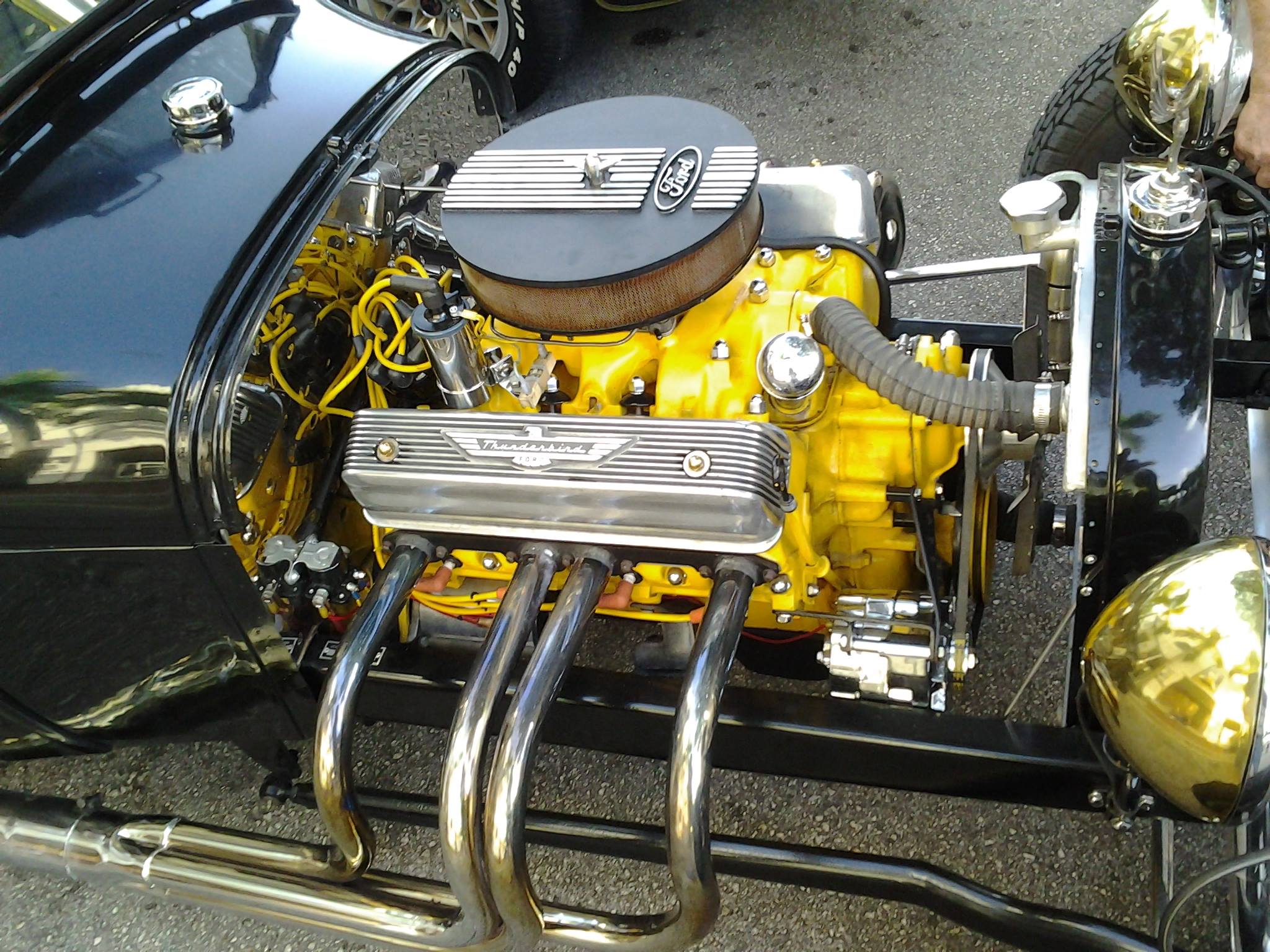

  10. dana barlow
    Joined: May 30, 2006
    Posts: 5,459
    dana barlow
    from Miami Fla.
    DejaVu292Y.jpg I often don't get it,when guys say just be sloopy cuz it's how it was done<big bull ****. I've always had repect for real hotrod builders,those that had pride enough in there stuff to make it look good as it ran! The others are just beater builders{if it an't shiny it an't done.
    Take the time to hide your wires and make stuff look like it was thought out,not just bolted together,but smoothed and shined. Some wires just need to show a little,but make them neat and clean,I put my headlight wires inside my frame in 1959 when I first built my hotrod,I updated to a onewire alt a few years ago,I still drive it,so its always getting something refreshed.

    I don't agree that if the wires aren't hidden they're sloppy.
    I'll bet you're plug wires are driving you nutz...........especially with that firewall reflection.

  19. dana barlow
    Posts: 5,459
    dana barlow
    from Miami Fla.
    Sorry your failed to read what I posted,you read it with your own way per idea that I didn't mean as you though. That happens,could be my bad writing also. I said nothing about hiding all wires,was only talking about headlight as OP.
    The point of "sloopy" was just that few were that way.
