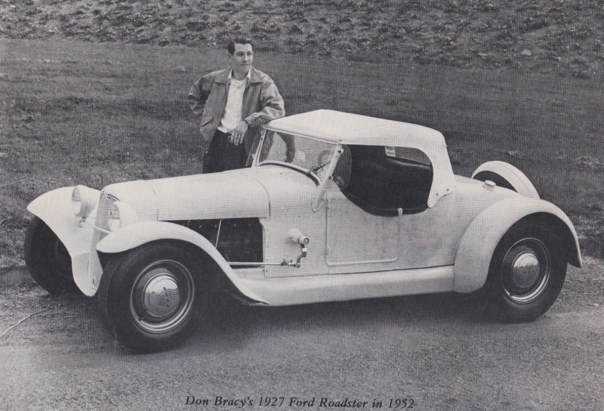

    These are few of my favorite things...

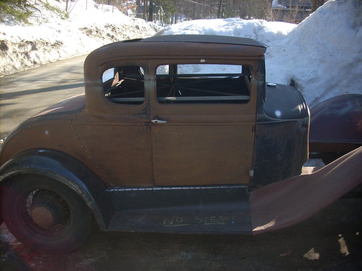

    a project i started: 31 buick 6 inch channel full fender. a shot of it now and a photoshop by moose. DSCF5071.JPG 22.jpg

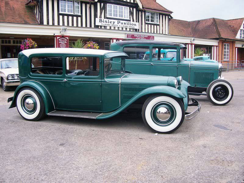

    I was around the blue Model A sedan in the middle of Georges photos above. George Jezek of Waco Tx built it in the 70's but it had different wheels on it when I was around it.
    It was a great looking and extremely well built Car. I remember it sitting a lot lower though.

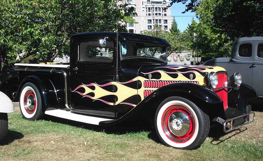

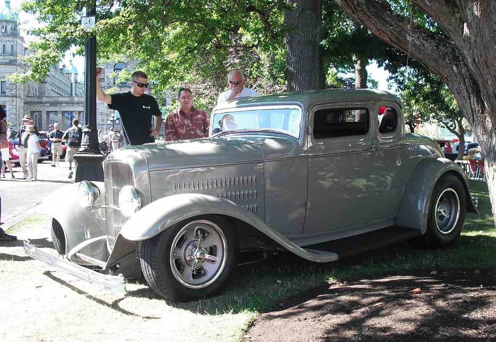

    That blue model A is exactly what I am thinking of doing. I guess I would "section" the body side of the fender "bump" that is, the bead rolled rolled into the rear quarter that accentuates the meeting between the fender and body, up so it is saved.
    I really like the idea of fenders on, and little or no chop for what I am picturing so these all REALLY helped.

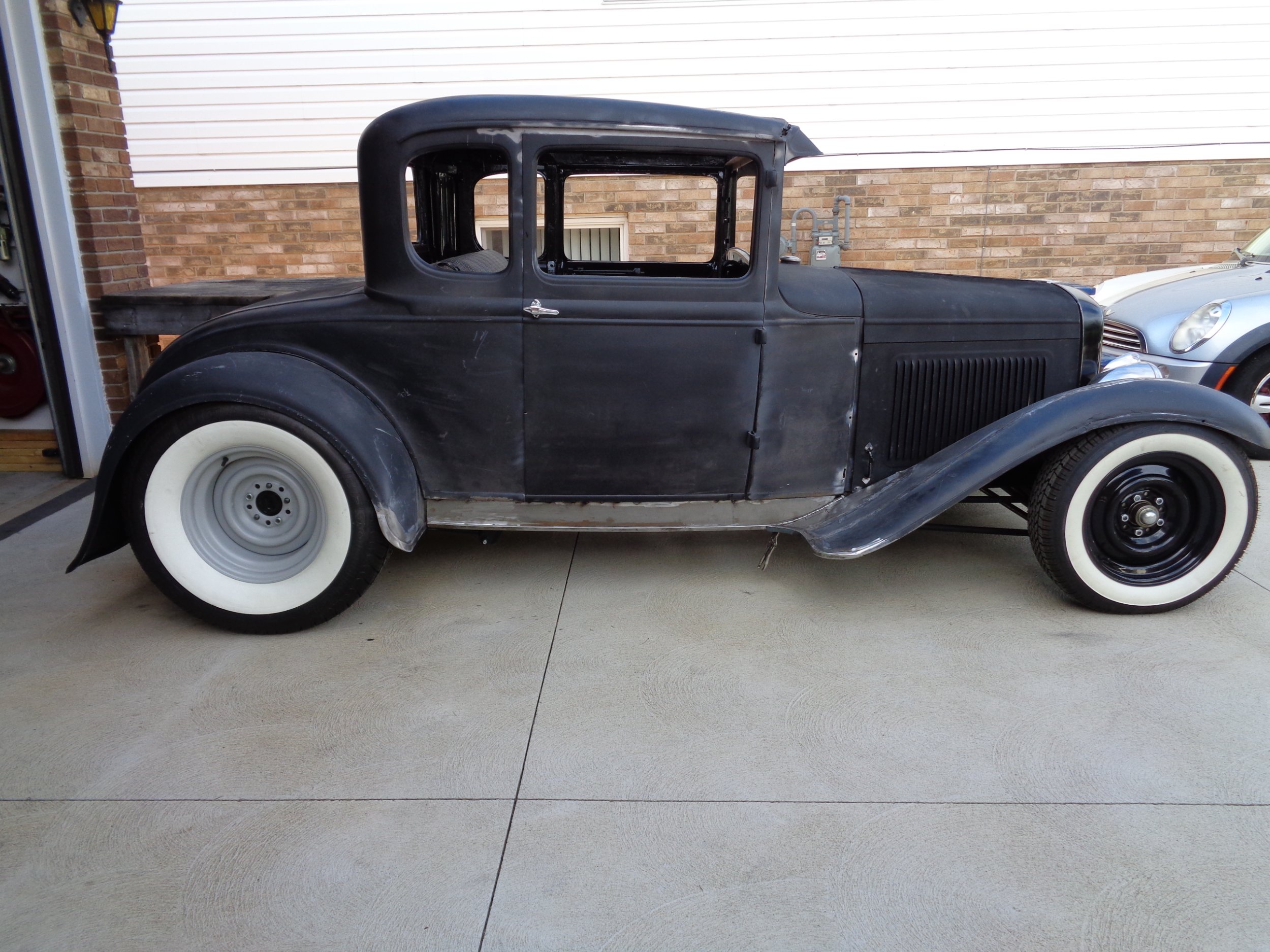

    My avatar is an old stalled project pic of my non-chopped '30 Model A coupe that has been lowered, frame is stepped 6" in the rear, channeled the width of the frame, rear fenders and mini tubs were raised an equal amount and the front fenders narrowed 3". It was too hard to enter and exit the car with the running boards, so I reverted to our motto, " we don't fix it, we eliminate it". A set of rocker panels were made to tie it together. Hope to prep and paint when it warms up in the weeks to come.. Always liked the look on the sedans as well.
    I see you are in Ontario. I have heard the law is being enforced requiring fenders and a requirement for plating the vehicle? DSC06940.JPG
