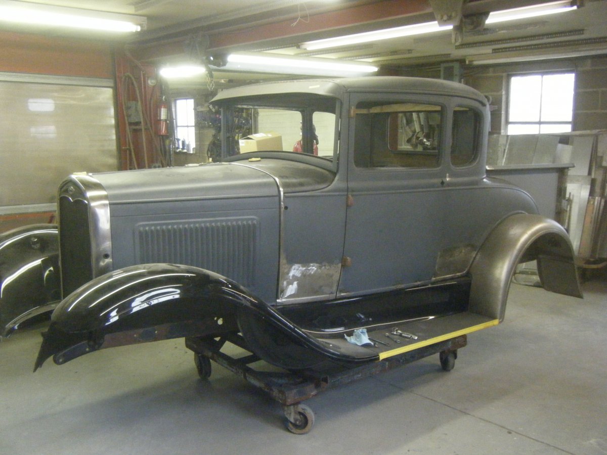

    before putting paint on anything be sure to completely fit all the aprons and fenders. repro's ****, you WILL have to cut and trim. originals have been around too many years to keep them straight. DSCF0002.JPG before i got this one they had painted 3 brand new fenders and an original without test fitting. i will be repainting them over now that i have fit them correctly.

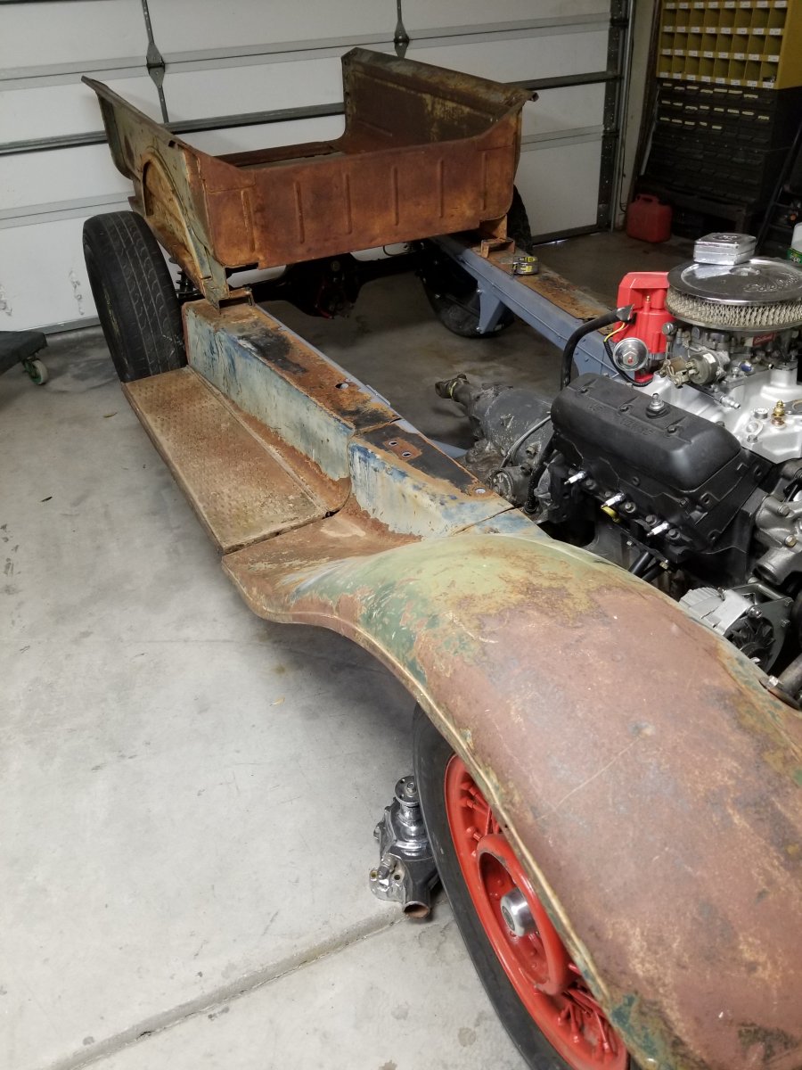

    20180327_142305.jpg 20180327_142305.jpg 20180327_142305.jpg 20180327_142305.jpg this will give you an idea.
    Tim and tb33anda3rd like this.
