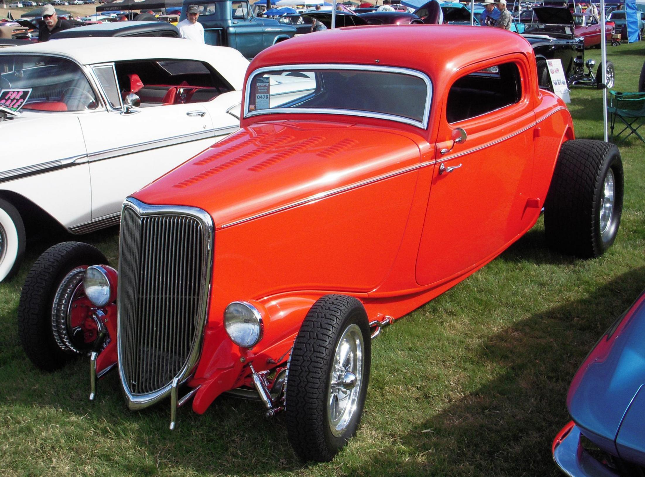

    This is a fenderless car made after 1932 that looks pretty bad ***:

    "Most anything after 1932 is much tougher to make look good without fenders. 33/4's can sometimes "make it work" if you get rid of the stock inner fenders and pay close attention to the headlights and hood sides.
    35 and later become very difficult to flow without fenders."
    Haven't been under a rock but been studying 34's for decades and am real picky about what "works" Same as a Hiboy roadster or hammered Merc; don't pay attention to components and proportions and you'll have less than perfect results.
    I'll be the first to tell you the Poteet 34 is one of my fav's!, because it addresses components in my above quote. He ditched the stock 'bubble' inner fenders, used the right axle, wishbones, wheels/tires, and hood/grille, headlight treatment to make it flow. All stuff that's much different than Stone 33 fenderless version. That's not knocking his car-just stating they're two complete different formulas with the Poteet car thought out fenderless from the ground up build vs. converting a fendered car to fenderless. Just yanking the fenders off a 33/4 without considering your now exposed wheels, suspension, etc. can kill the effect. You can "make it work" on some 33/4's ( hammered coupes and Tudors), but beyond that, I stand by my original statement that it's a real chore.
