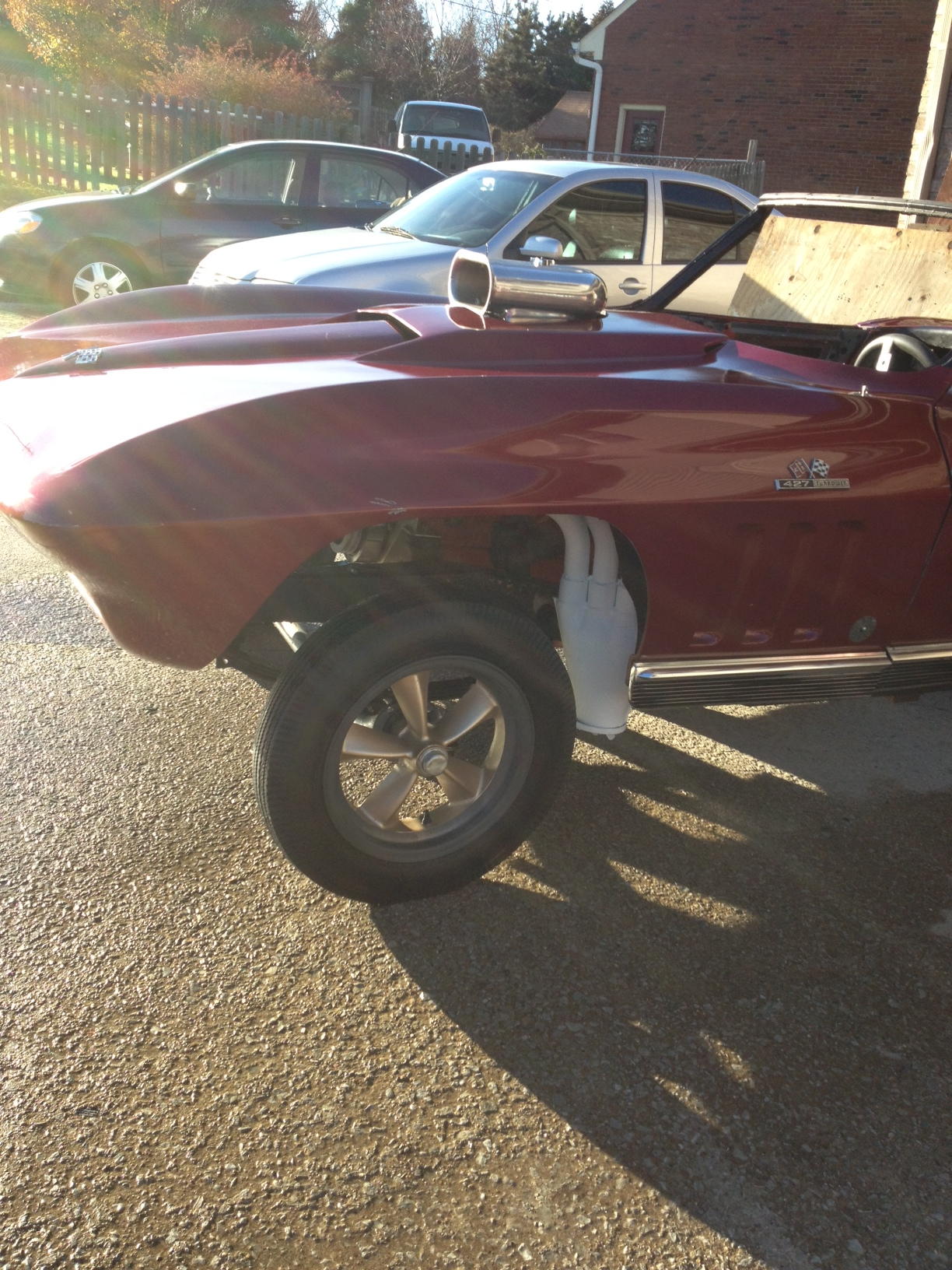

    Here is how I got it from the previous owner, now you see why I
    Need ideas! I wanna ditch the p-trap look
  3. 231ramona
    Joined: Feb 7, 2007
    Posts: 274
    231ramona
    Can't really see it in these pics but the bottoms have removeable caps and there's a tube exiting on the back side.

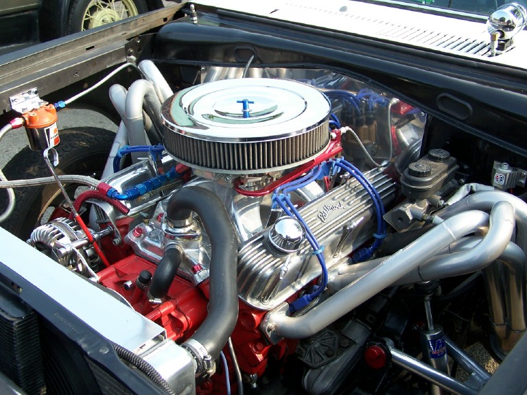

    Headman hustler fender well headers on a '66 valiant with a 360.

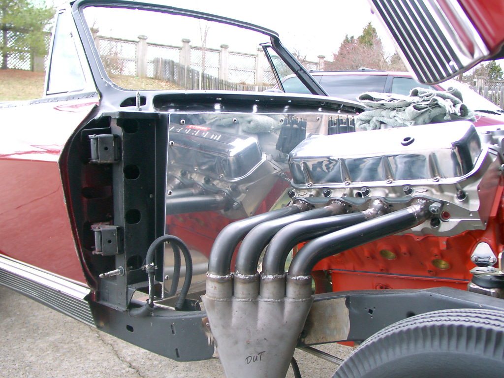

    2 1/4 x 3 1/2 custom by Dougs Headers.
    Then welded 90's & a flange on the ends.
    Exhaust is loud- 3 1/2" W/ Magnaflows, exit out side of body behind doors.
  11. lrs30
    Joined: Jan 30, 2007
    Posts: 2,214
    lrs30
    from Kentucky
    That's a beautiful thing there!

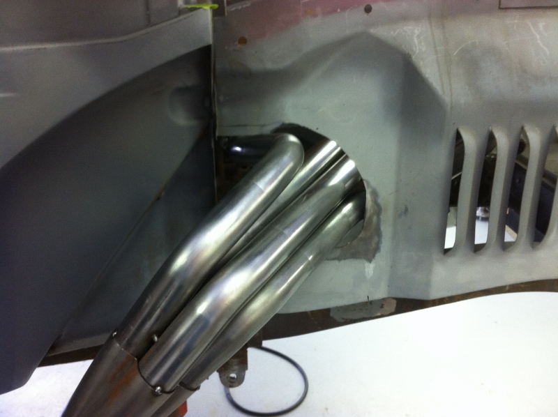

    Headers on the 1940 Willys project.:D
