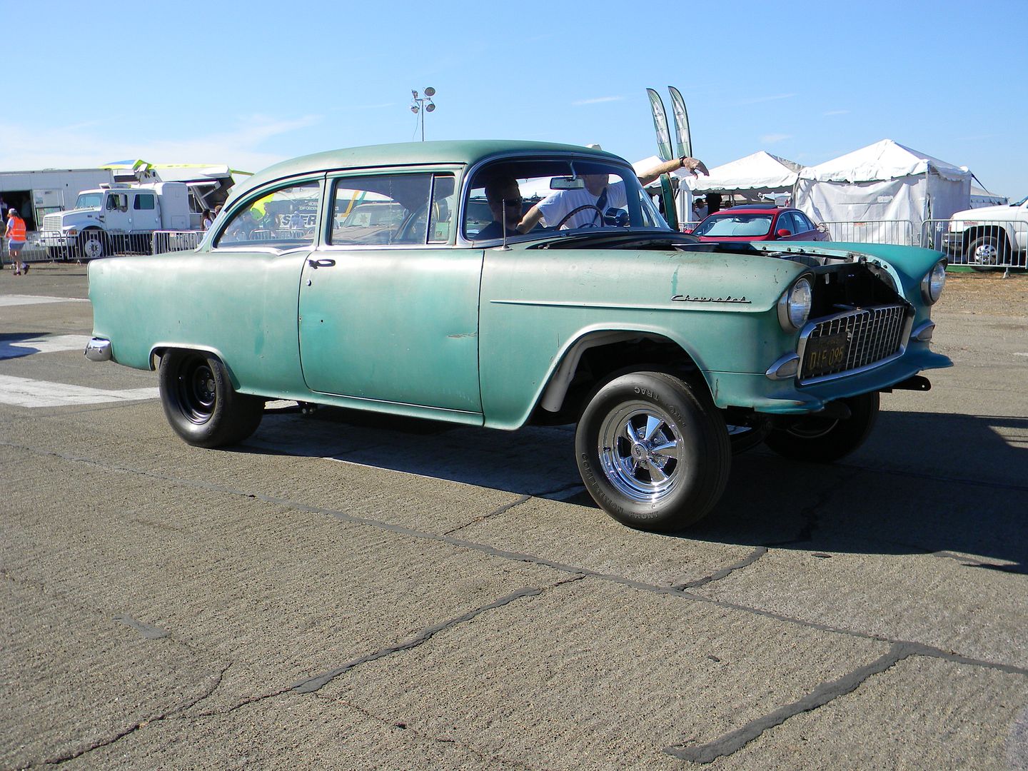

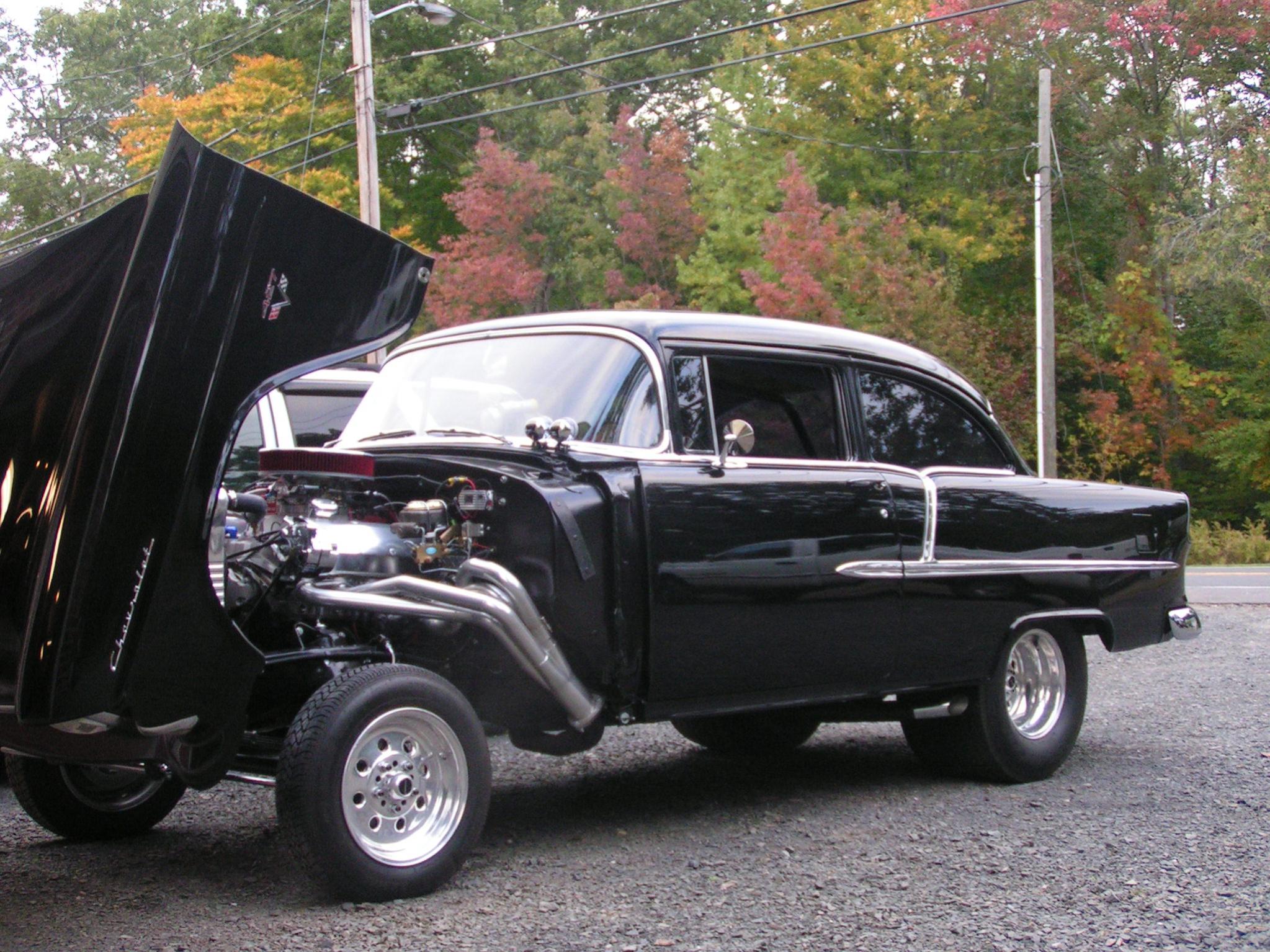

    Is that picture new...?
    Cause if it is,you NAILED that car!That thing looks like it just rolled out of a time machine from 1963/1964!!!!
    Nice job!
    Now tell us it's a 4-speed car and make everyone's day!!:D

    That '55 is one of my favorites. Not over done, Not lifted too the moon. If I remember right it does have a 4 speed. We raced each other a couple times at the Lodi Ca airstrip (kingdon) best match race of the day I thought.And yes headers are just RIGHT!!!!

    Hell yeah it's a 4 speed!!

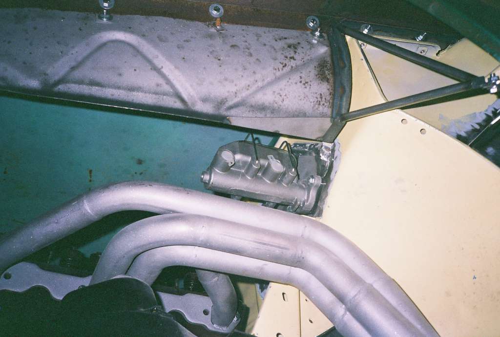

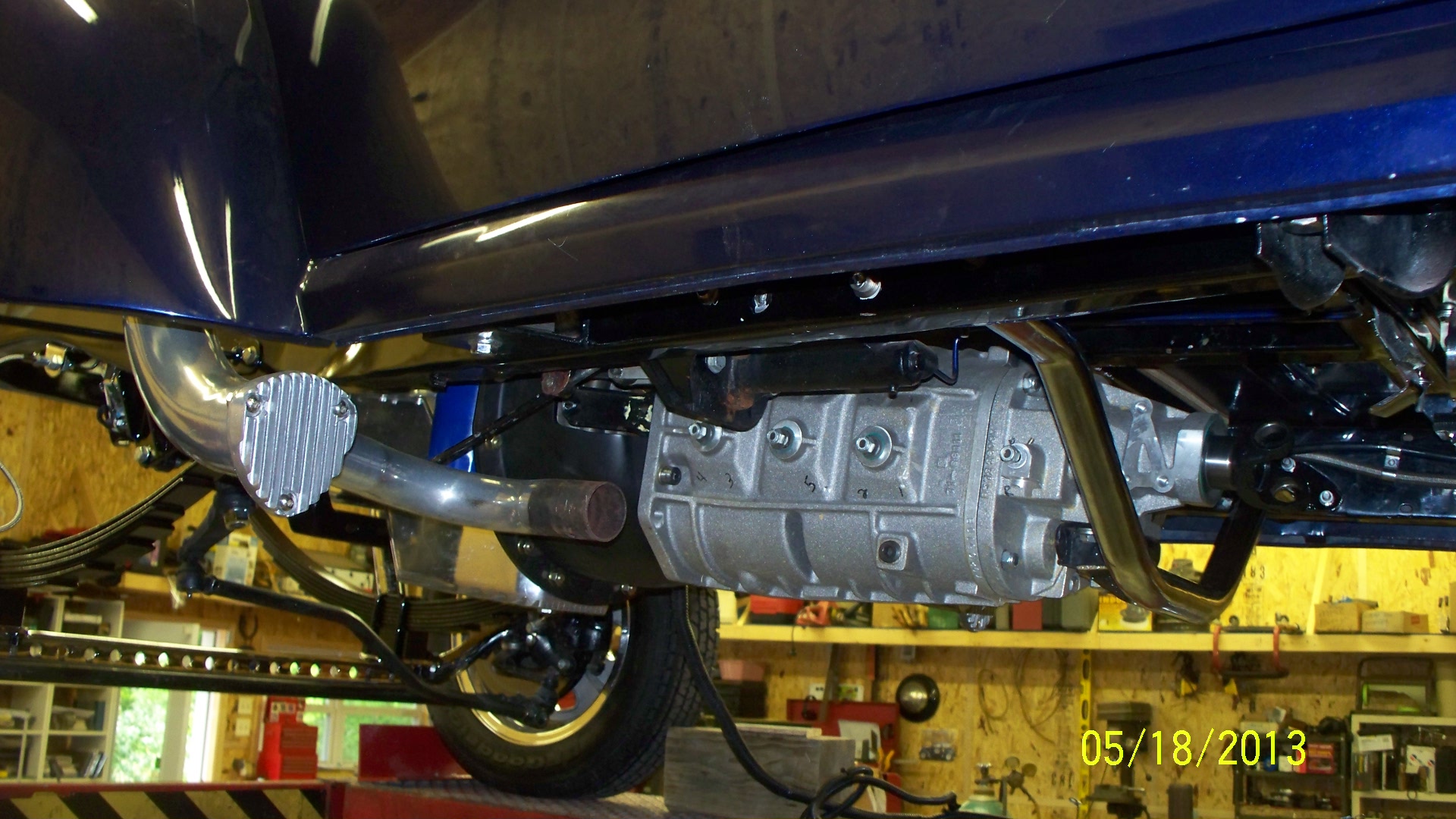

    Click on the picture for a closer look. Exhaust turn out exits right behind/below the front fender.
    Plumbbid built them as the coupe had plenty of inside fender clearance so he added a couple of 180 degree pipes off the header to add a muffler similar to the old hopped up VW sets ups.
    Sanitary Fabricated and a Great sound.

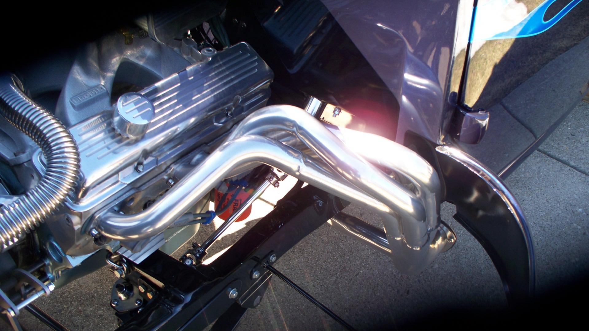

    Steve Centracchio fabbed the headers on the '31. he also built the entire car.

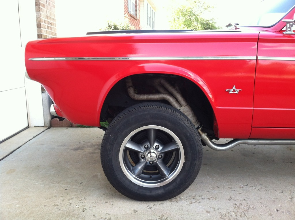

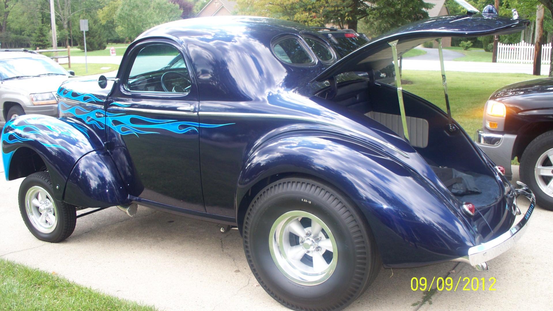

    I'm gonna try to put a little length into the collector and try to
    Baffle it some how so I can get rid of the P trap style exhaust the previous owner put on it.

    If those were on my car I'd cut the collector flange off and lengthen the collector long enough to get the new flange a few inches lower than the floor pan. Then I'd come off the inside of the collector with an outlet for the exhaust system. That way you could have a collector cap on the end of the collector and make it easy to open the fenderwell headers without having to drop the exhaust each time.

    That's kinda what I was thinking i love your mod you did to yours it's clean and simple solution! All your knowledge and input didn't fall upon deaf ears that's for sure!

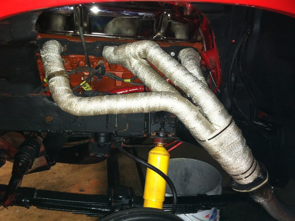

    So with what pics that are posted, my question is should I keep them wrapped or remove it? Any disadvantages other than them
    Not being white? Lol

    I'd remove it, especially if you want them to look period. Nobody wrapped headers back in the 50's and 60's. I've heard tell of moisture being trapped in header wrap, and causing pitting or corrosion on the tubes. I've never had any wrapped, so can't speak personally whether that is fact or not.

    I've done it on my bikes in the past basically for looks lol one of them I raced so it was kinda a pourpose! I am sure I will remove it but I wanted to see if there was a upside to keeping it on there.

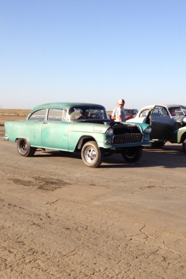

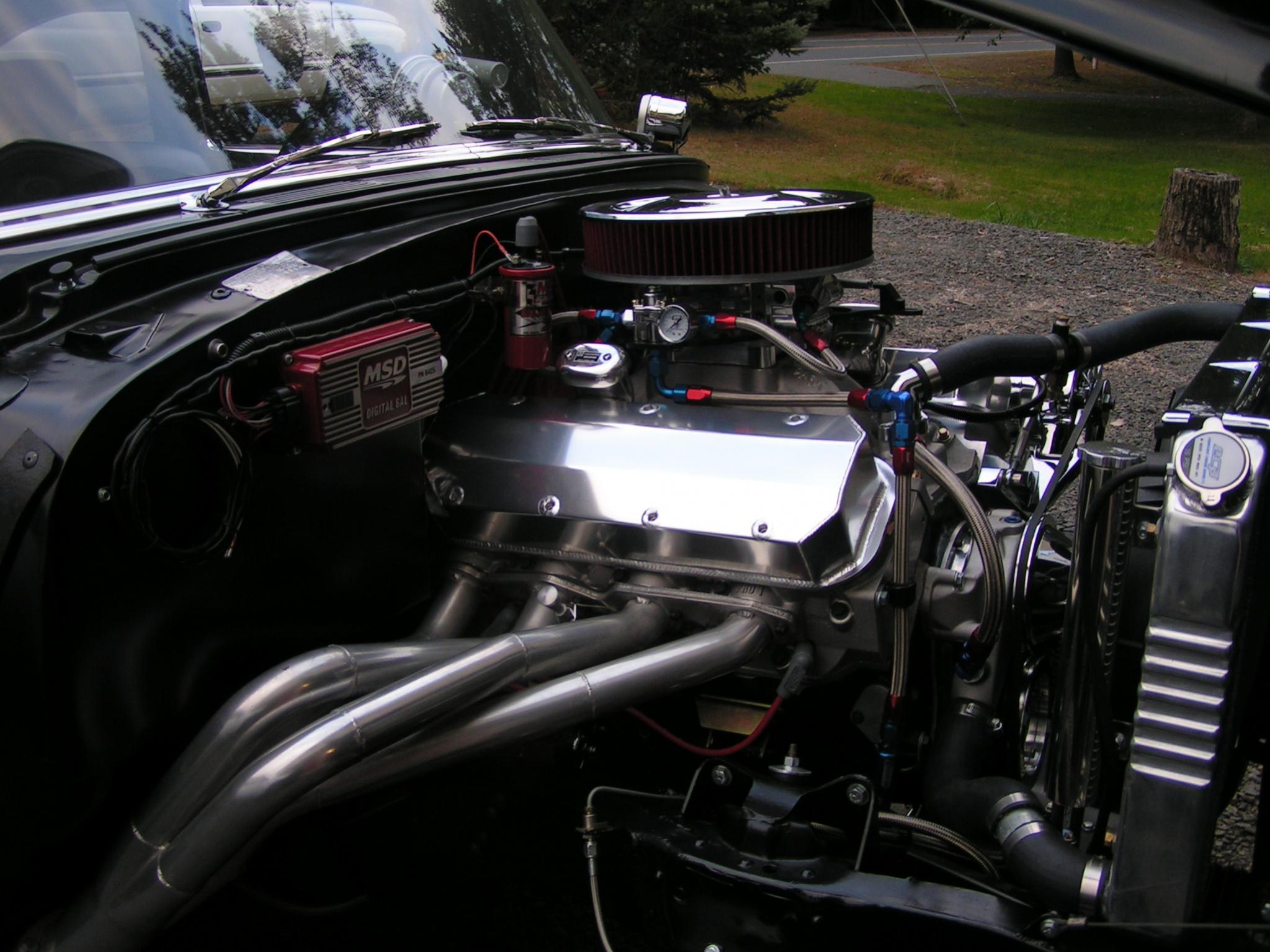

    33 Dodge, Cool headers on a tough looking 55!

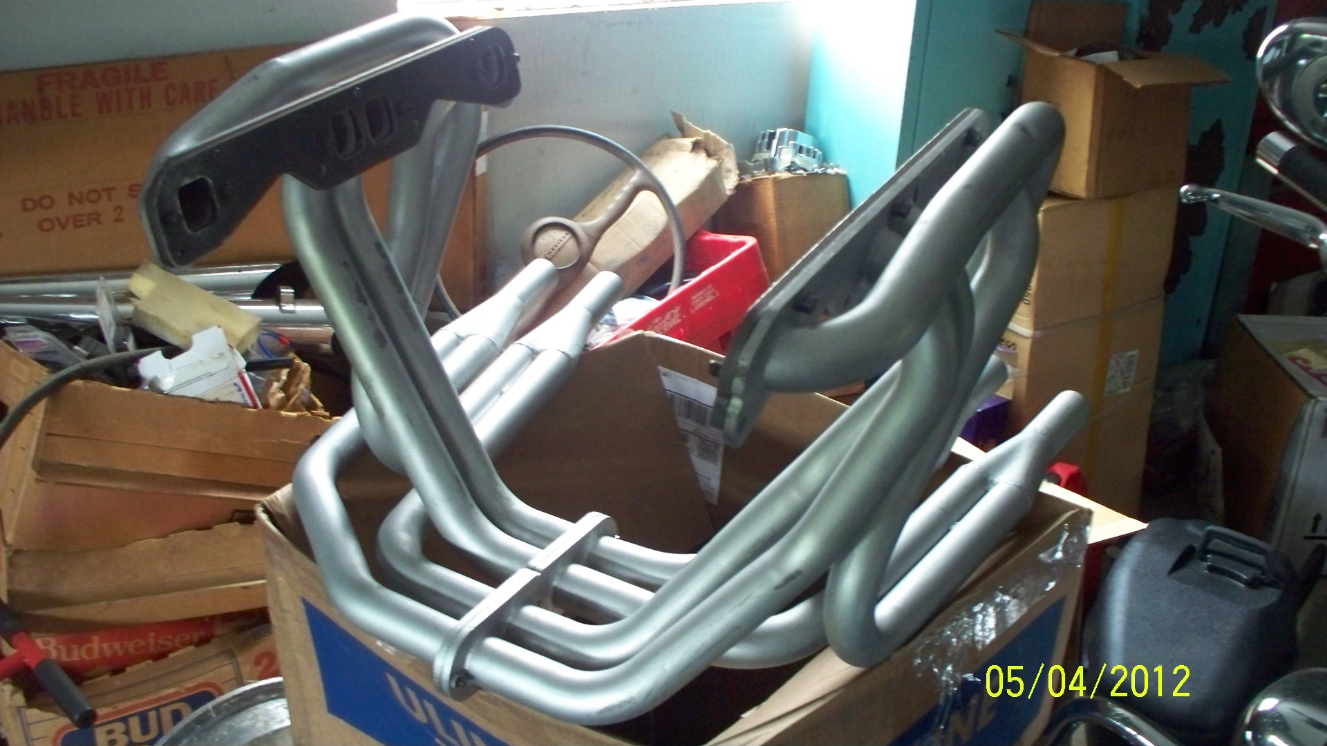

    Made these a while back

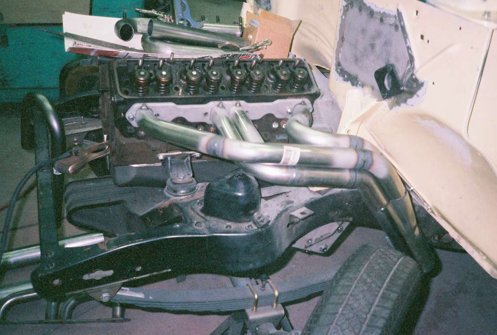

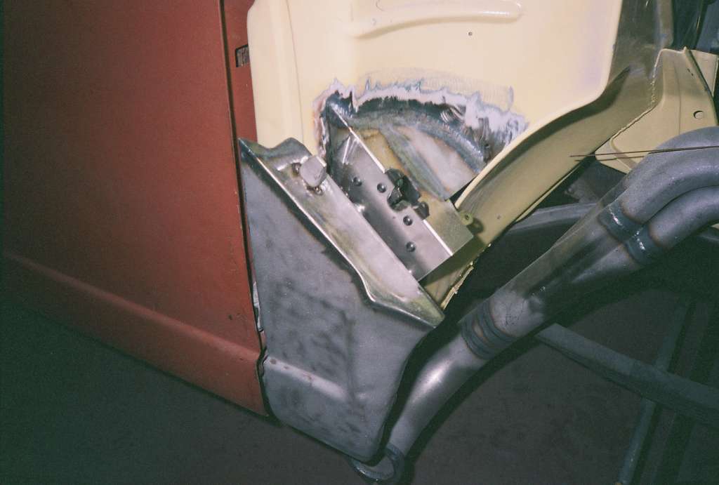

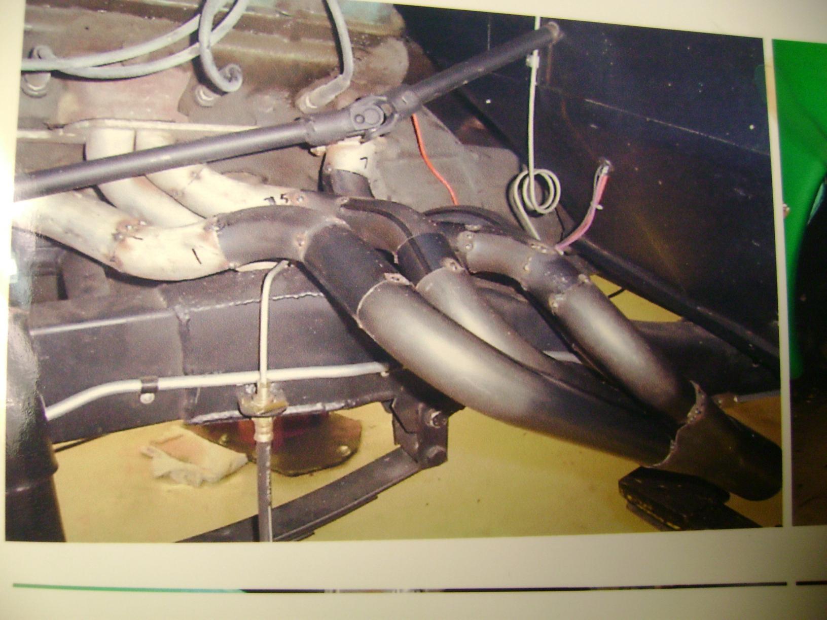

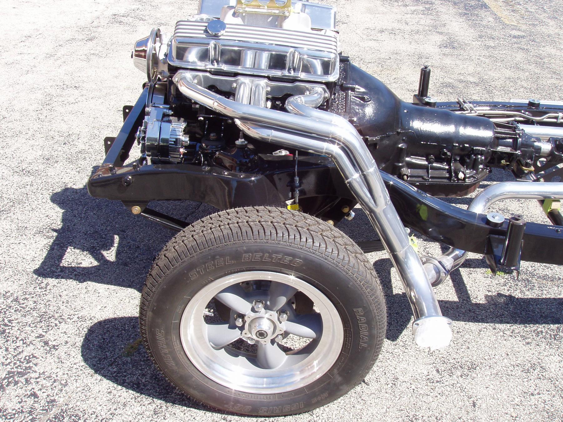

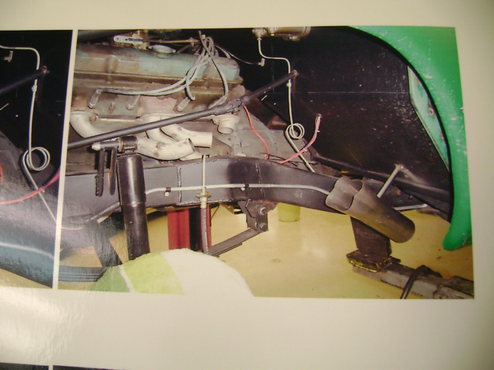

  20. Here are a couple shots of my Henry J headers under construction
    along with a shot of the headers on the finished ch***is with the
    head pipes that sweep under the frame and then back up over the
    transmission crossmember.
    John

    --------------------------look up he nailed it!------------- Killer job on the O'Henry

    John,
    That is a really nice job on the layout and fabrication!
    Me likey!:D
