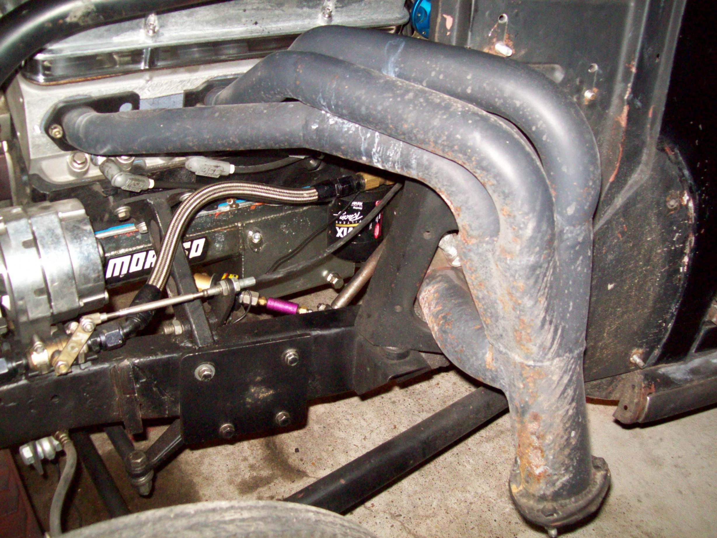

    The headers on my dart, after unwrapping them are in need of a re-paint. I will post pics of before and after and will let you know how well they will hold up after the paint job

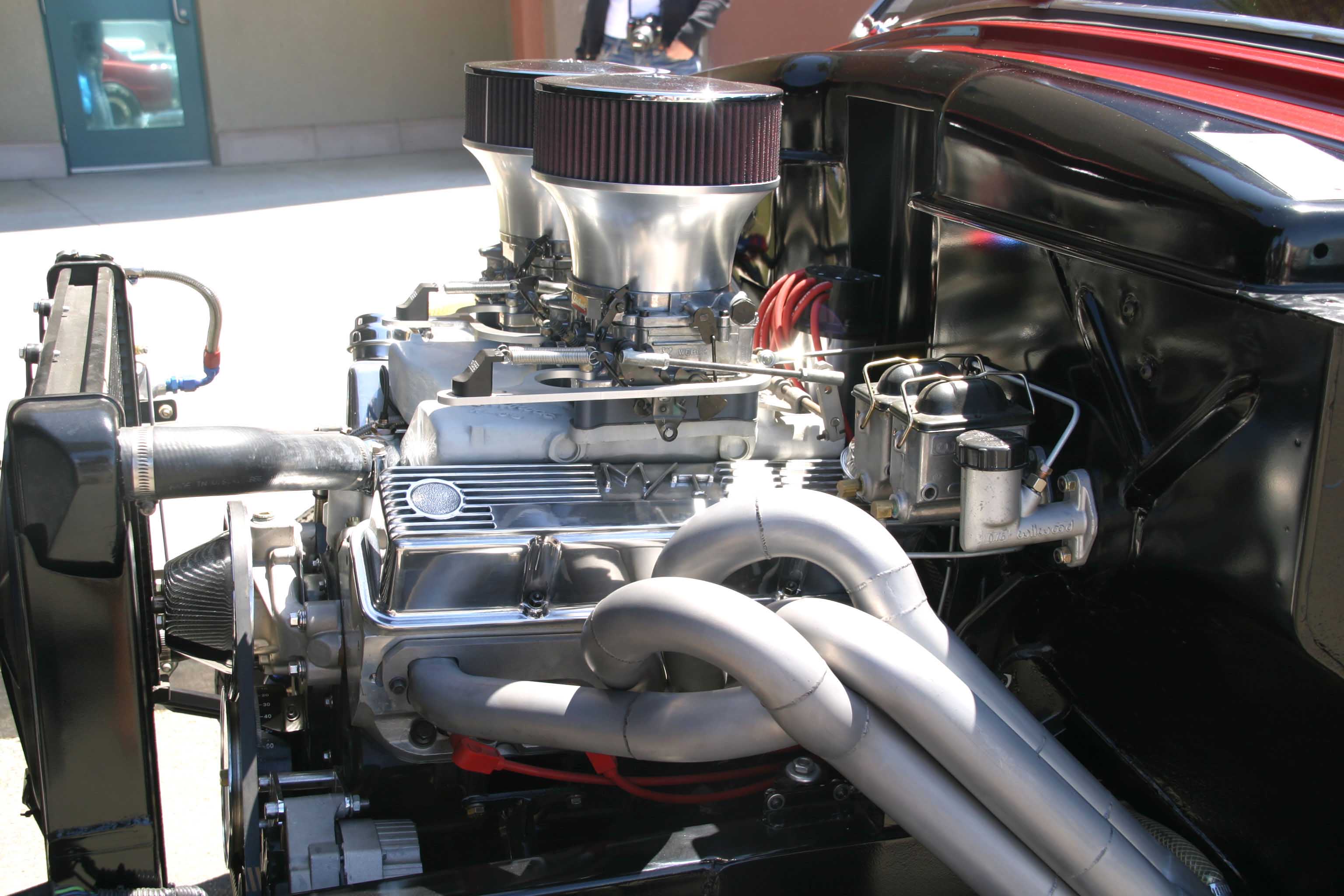

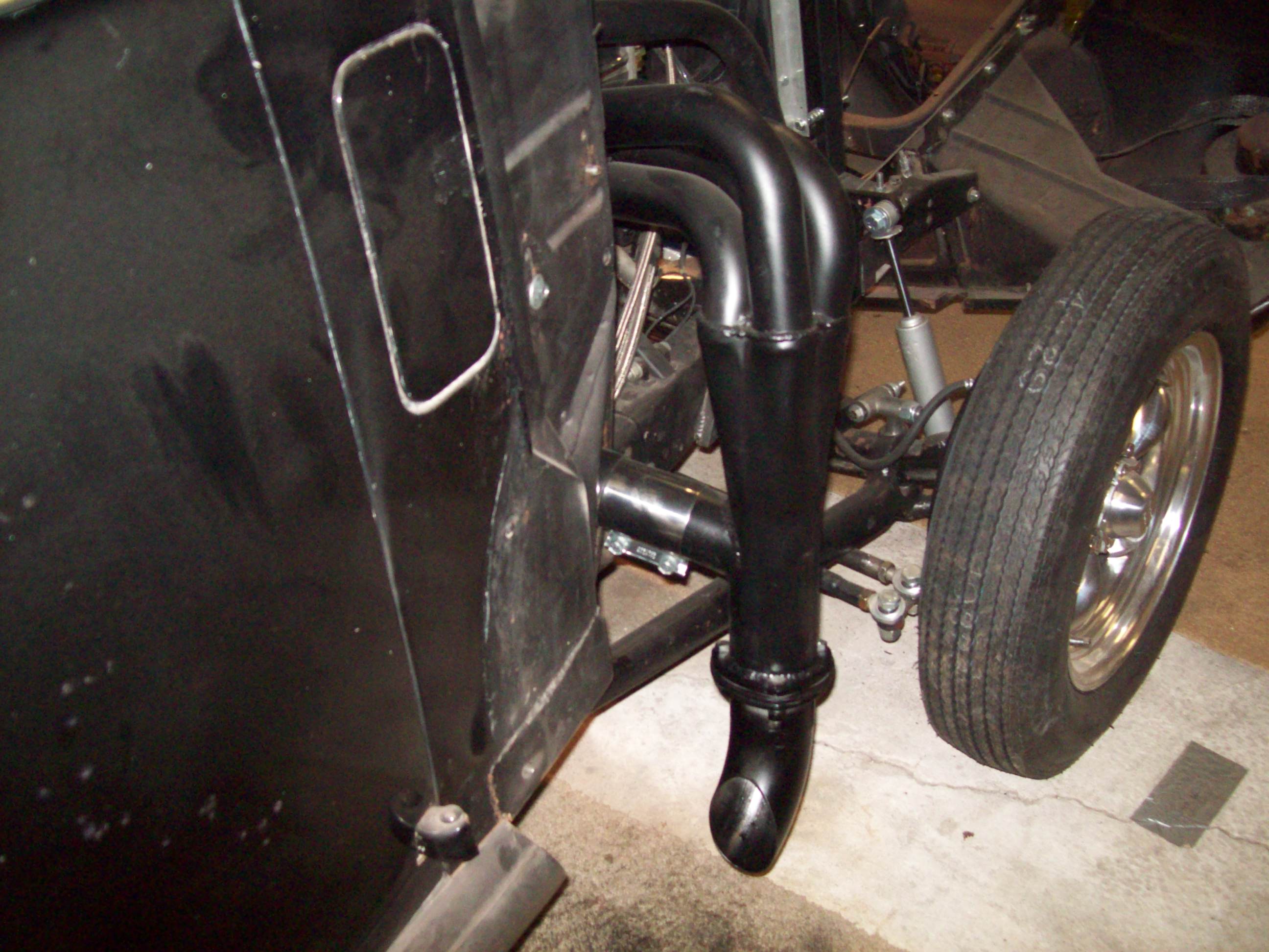

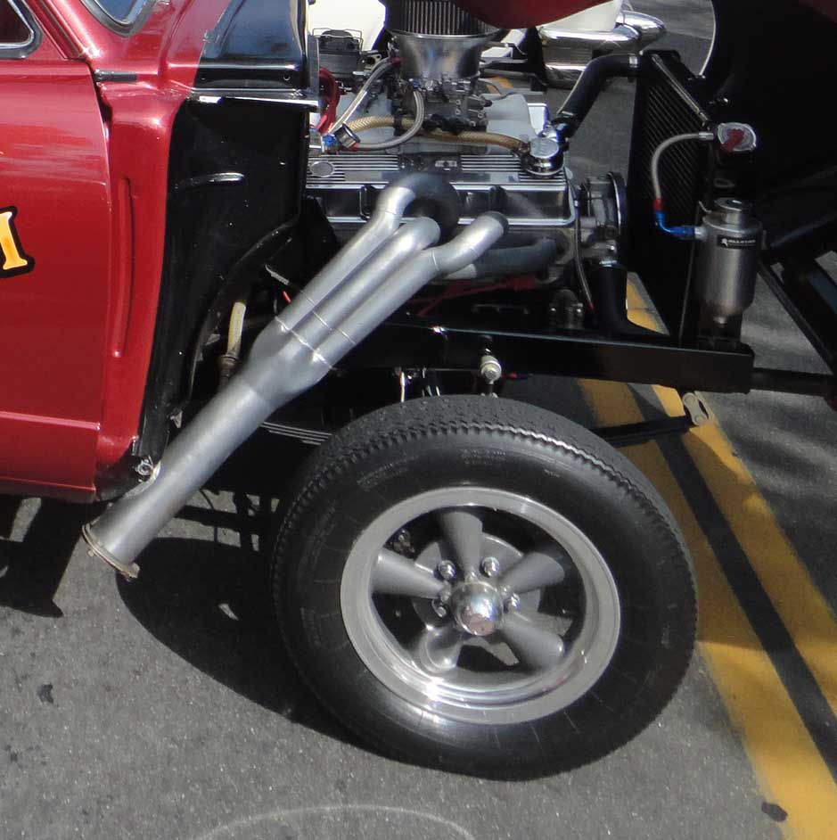

    Scott, here're a couple shots of the headers with ultra long collectors. These headers are built by Little People Cars in Ventura, CA. Drive train consists of a Dart 434" SBC with Edelbrock XRam. Unique feature is the B&M clutch Turbo 400 trans from the early 70's - a hoot to drive on the street! This car was featured in the Nov. '12 Street Rodder magazine so if you can find a copy, it'll give more info (or I can PM you so not to hijack this thread) along with a bunch of other G***ers. Windows are a bit too dark so constantly watching for cops when on the street...:( Enjoy, Vic

    On my 55, the reason I extended the collectors to under the car is so I'd be able to stuff a 12" baffle in it without building an exhaust system. You can see the baffle on the rear shot of the 55 in the collector. On the Henry J, it came like that. How you determine what length collector you want is to run a long collector and paint it. Do full throttle runs and see where the paint burns up to. Anything beyond that is excessive so you can cut the excess off after the burn mark. Never had shorter collectors to compare to so can't really give you a comparison. Vic

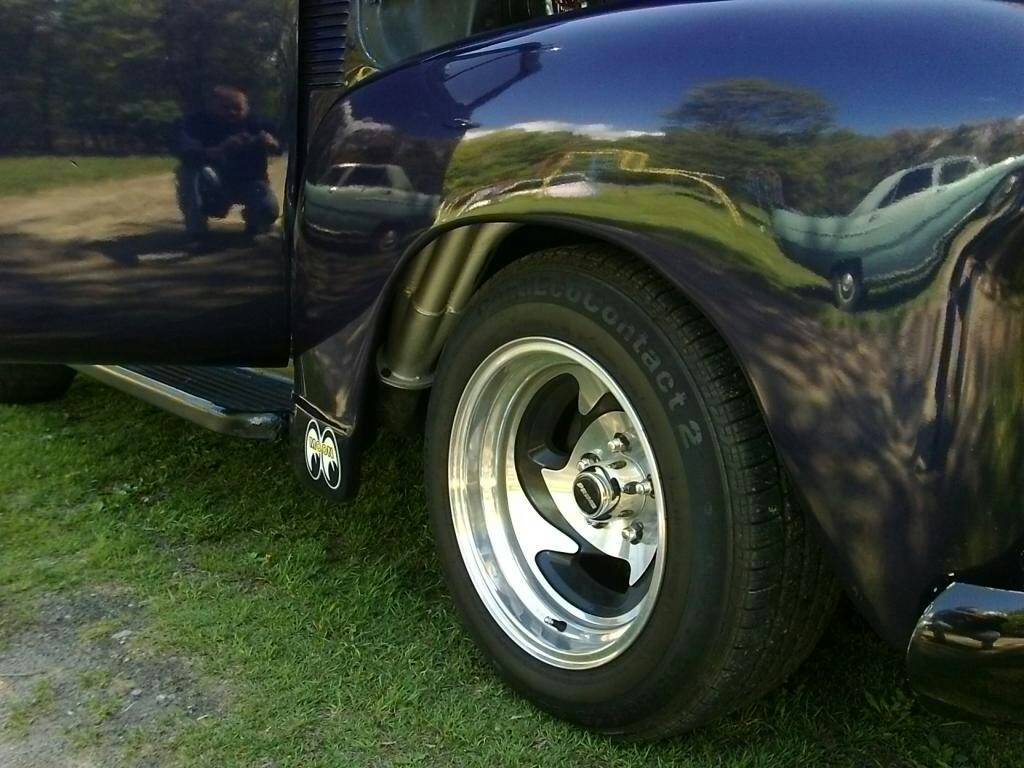

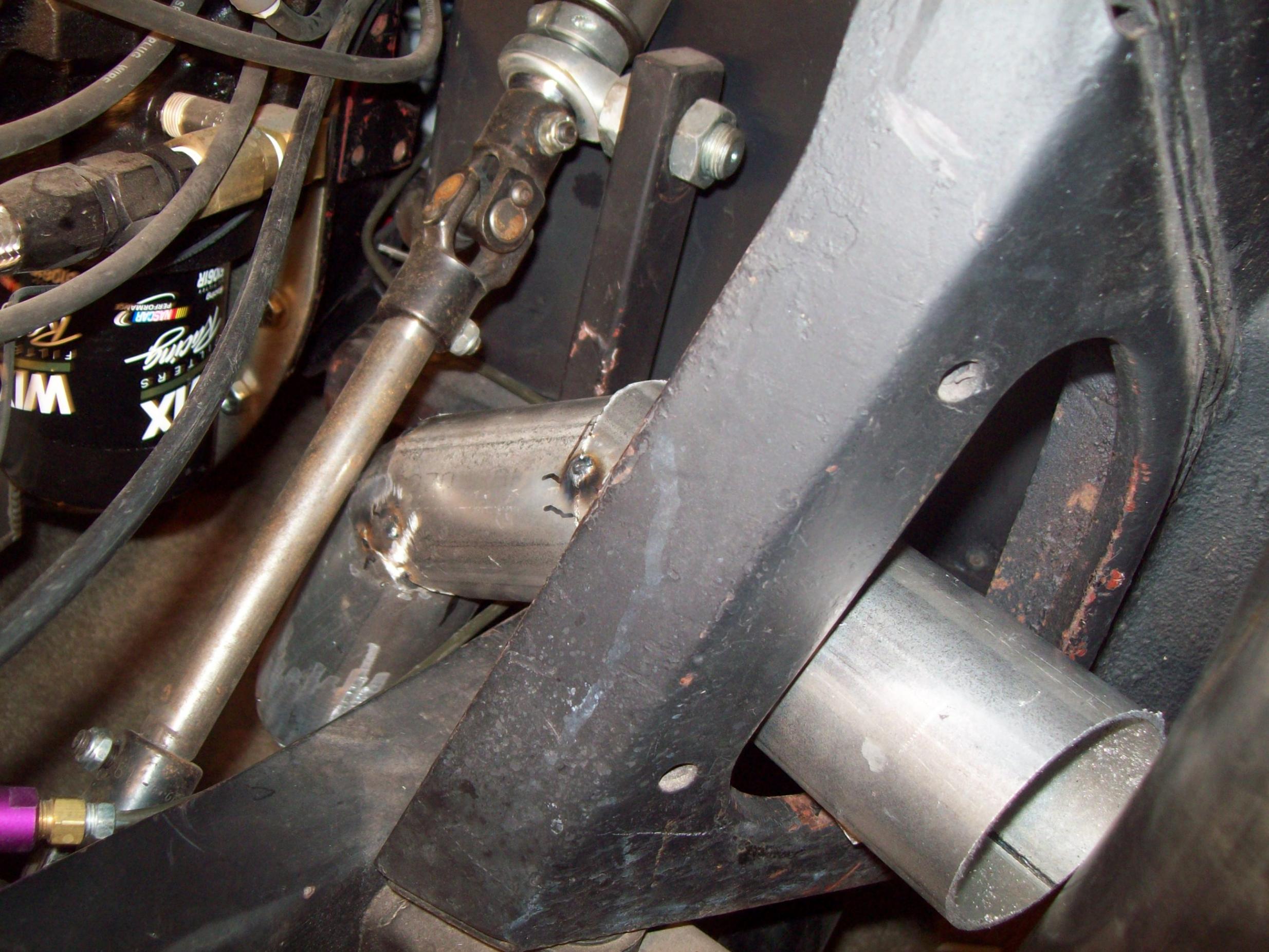

    51 chevy truck mustang 2 front suspension . ****** fenderwell headers , heated then tweaked after installed . Then the exhaust pipe and flowmaster mufflers on outside of frame . A clean look.
