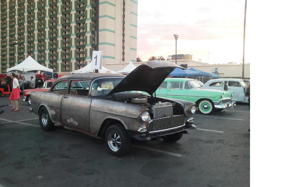

    Thats what I did, Wanted it simple as could be. But not hanging as low as alotta fenderwells you see out there. worked good.
    This is a 3'' system from headers back chambered mufflers. It breathes unapologetically, I love it

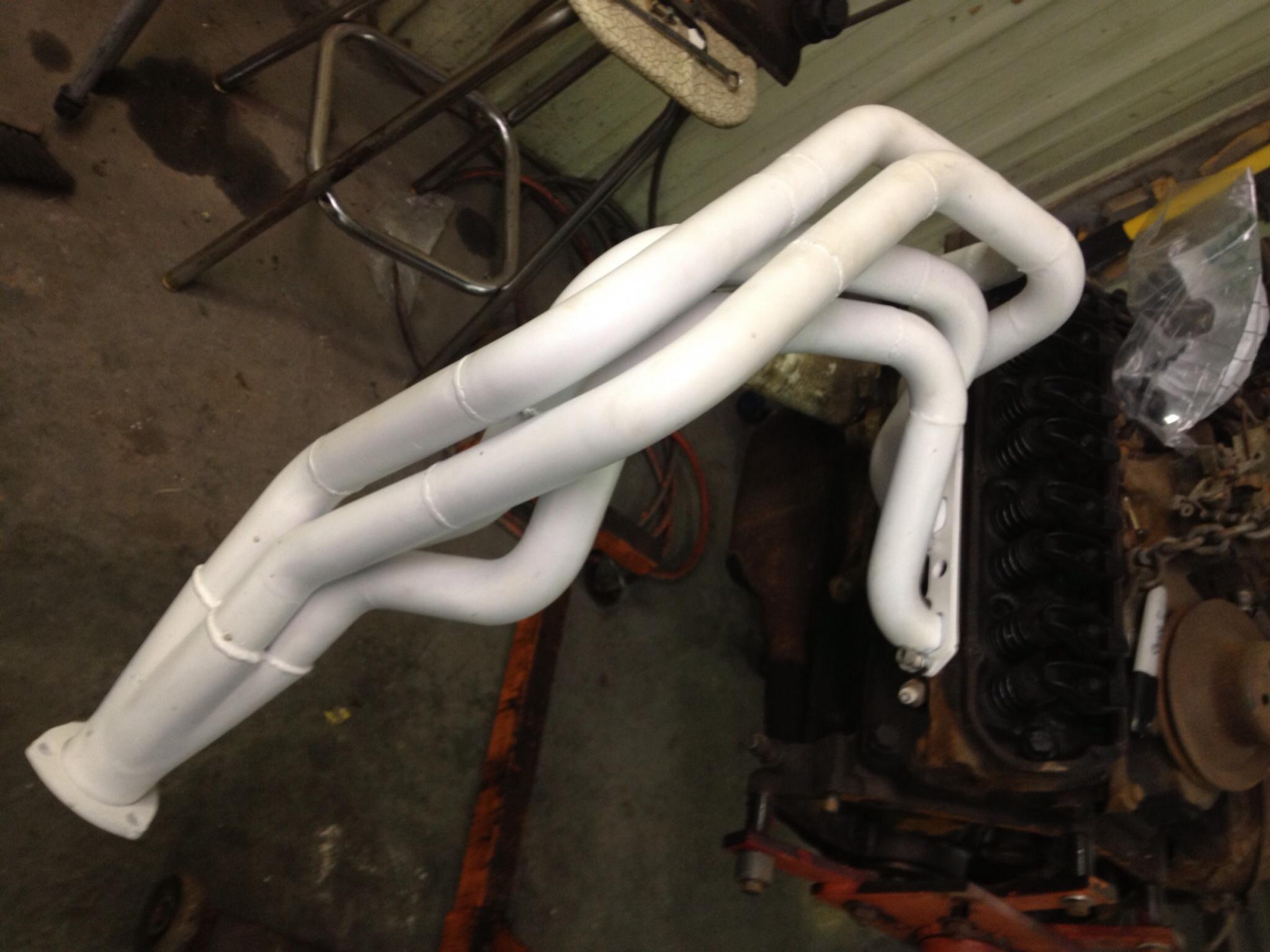

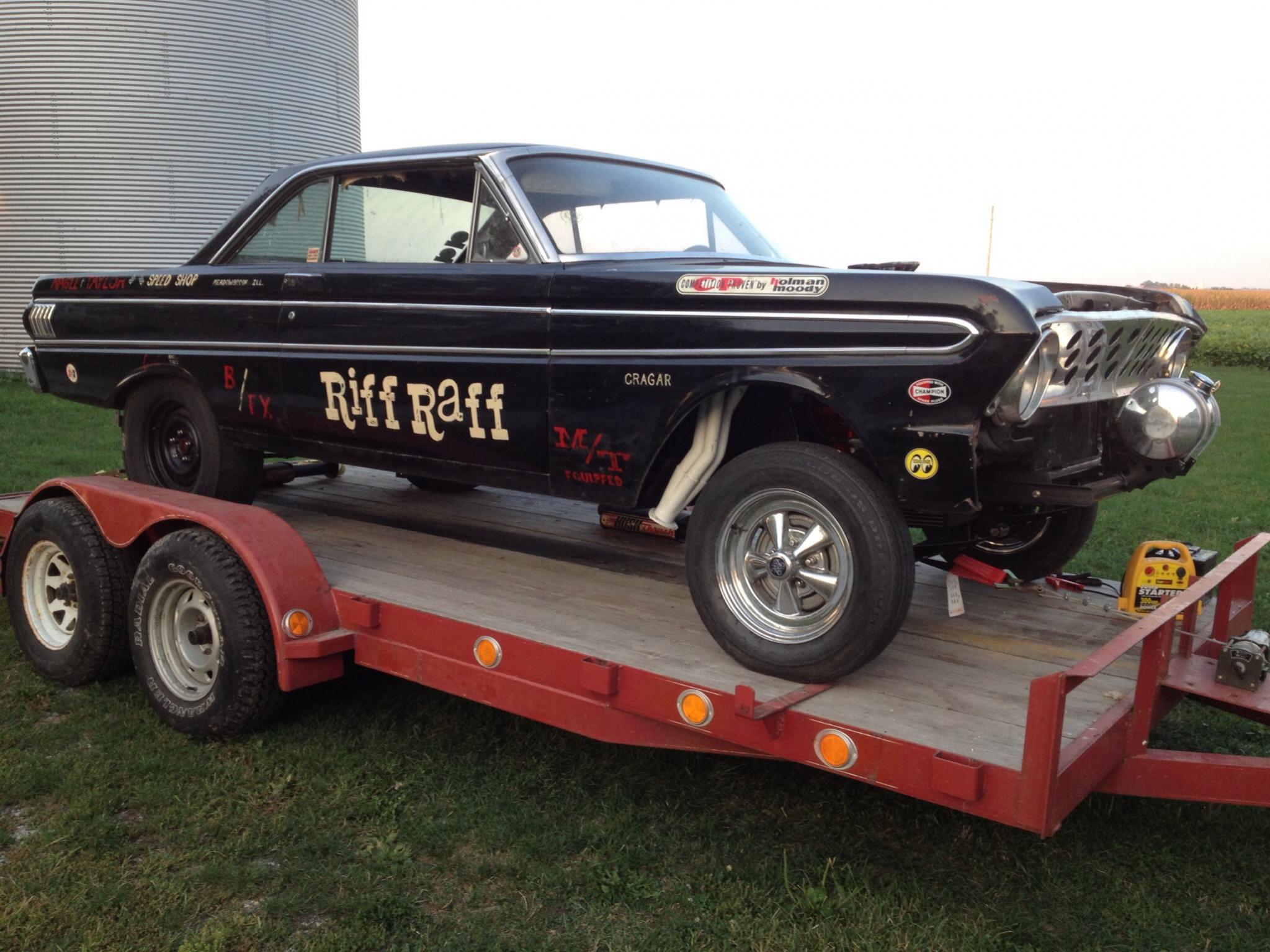

    I made this outta some ******s that might have been for an early bronco. I need to fab up an outlet for exhaust. I got some old *** thrush hush mufflers to run outside the frame connectors. If I ever get it done!! VHT paint.

    Do you have issues with the floorpan getting really hot since the exhaust is tucked up so close?

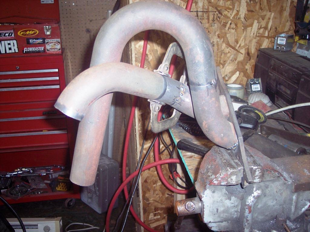

    Here's a shot of one of them out of the car

    It is warmer running along that section of floor. Not hot per-say. I considered making heat shelds once upon a time for the floor pan, But it hasn't been enough of an issue to mess with it. I did use peel-n-seal (think cheap-o dynamat) on the floorboard all over, so that probally helped. on the other hand i also have NO carpet or padding etc, So im sure it would be even less of an issue if i did.
    Just hasn't been an issue for me yet. But then again, in Vegas the whole F'in car is hot most of the time...
    I still wouldn't change it, I hate seeing a tube going straight into the side of the collector, the 90* direction change for the exhaust g***es... it erks me.
    I rarely run open exhaust, so i wanted it to run best in "normal mode" if you get my drift. not choked up untill its uncorked. For mostly drag car thats great. But lord knows whenever a quick car rolls up next to me at a stoplight i dont have time to drop the exhaust caps, and i just didn't want that excuse in my head.

    That's the reason I asked about the heat. Mine will be carpeted and I was just concerned about damaging the carpeting.

    Oh no, i dont think it would ever get that hot. Due to the frame mounts you could only come within, lets say 2-3'' of the body at the closest. so its not touching or anything. This is 3" exhuast, if your running 2.5 it would be even better.
    I plan on padding & carpeting mine as well. I forsee no issues.

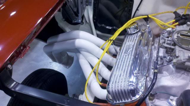

    This is the right side of the Patriot Headers that I did for Woody's Hot Rodz, the guys with the new 57 Chevy Steel Body's. The White is ceramic Coating

    That is some nice looking work Don.

    Rocketsled59:
    That Falcon looks great!Thats very close to the look I'm shooting for with one of my projects.Black paint,rear steel wheels with slicks,lettering,etc.
    Nice job!

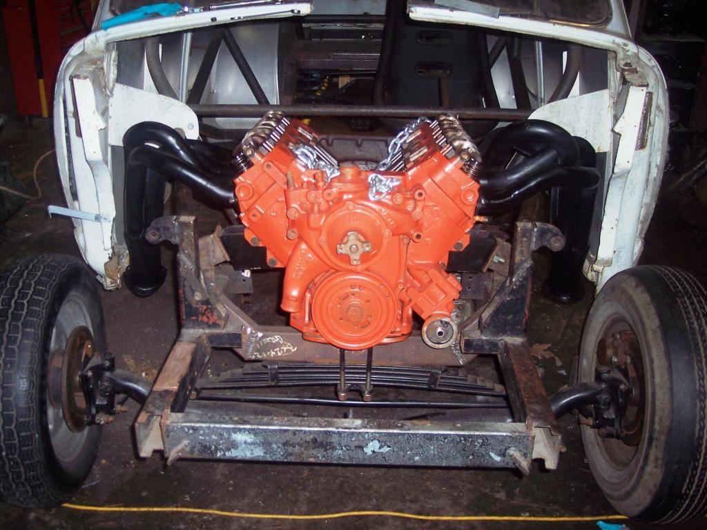

  23. I took a set of crunched BB Dart fenderwell headers and cut them up, reshaped them to fit my Henry J. I called Summit and Jegs and tried to order a set, I told them 51 Henry, with a 68 440 set back 14 inches in a 70 Alston ch***is and gl*** flip front, and want the ones that go up and over the upper frame support. They said no one makes them. I was stunned. Not quite equal length, but within an inch, and the longest tubes have the most bend, so backpressure is likely close to equal.

    Nice use of the wedge motor in the Henry J
  26. I used the 440 because my cuda got hit in the back and was awaiting repairs(still is) and that was what was available. Someone over on moparts.com sent me a pic they found of the car racing in the mid 70s, and lo and behold, right on the front fender it says 440 Dodge, so I guess it stays.

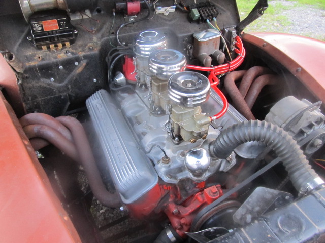

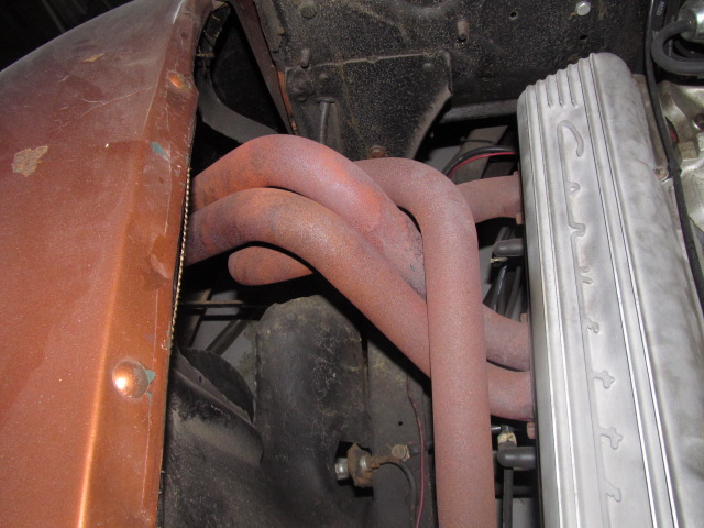

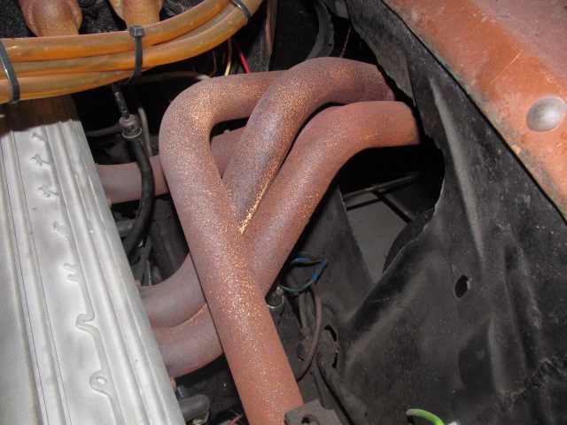

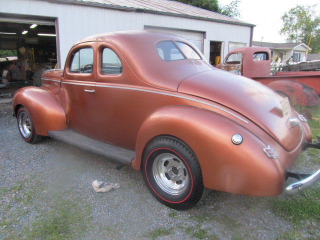

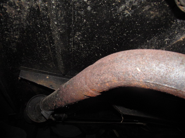

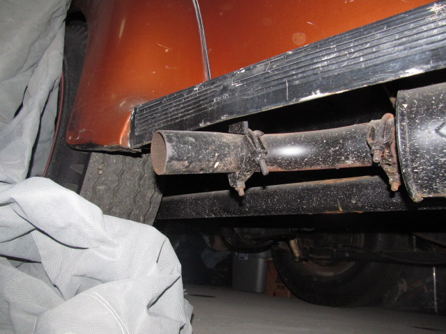

    Just found this thread and find it very interesting. I know there has been some discussion on "how they did it back then" inside the frame or outside the frame. Heres pics of my 40 ford coupe, and for the record these pipes have been on this coupe since 1965..... Im not sure of the brand, or if they are meant to fit the 40 or something else..... it almost looks the small block was installed with a kit of some kind.... but do they sound sweet.... when you launch this thing it sounds like Steve Falfa's 55 out on Paradise rd...... its like havein a wife that never ages!

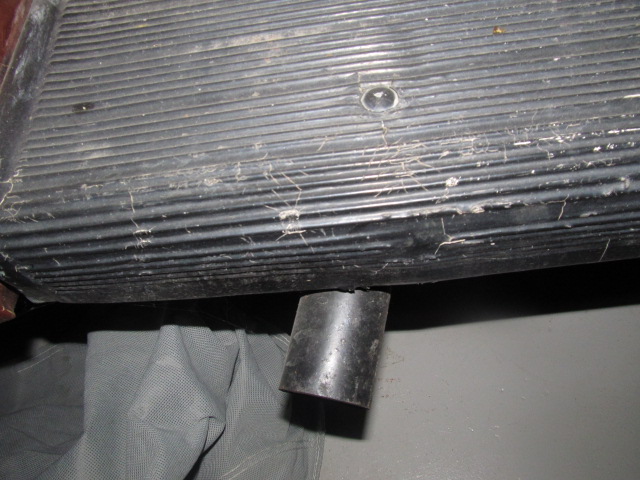

    heres a pic of the engine mounts and a couple of the car too.... thoughts and comments are welcome
