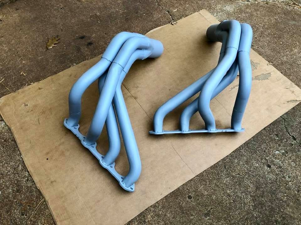

    I have a Ford 351W in my 48 Austin that I am building. I looked all over for SBF fender well headers. I got creative and bought these stock clip 351W stock car headers from Schoenfeld and also a set of their angled slip on collectors. I cut the header collector off at where the tubes straighten out to go to the collector and put the slip on collector on to bring the angle more straight down. The stock clip headers sweep back at an angle behind the back port and I need them to come more straight down. Instead of buying the complete headers pictured I bought the same header in a raw un-welded kit that had all of the mandrel bends made. This allowed me to m***age some of the tubes to fit my Austin's ch***is. I moved the 2nd, 3rd and 4th primary tubes up to the 1st, 2nd and 3rd port on the flange and used the 1st primary tube tube to build the tube for the 4th port. This allowed the slip on collector to come straight down from the back port. I have about half the cost of what it would have cost me to build the headers from scratch. schoenfeld stock clip $300.jpg 3.jpg
