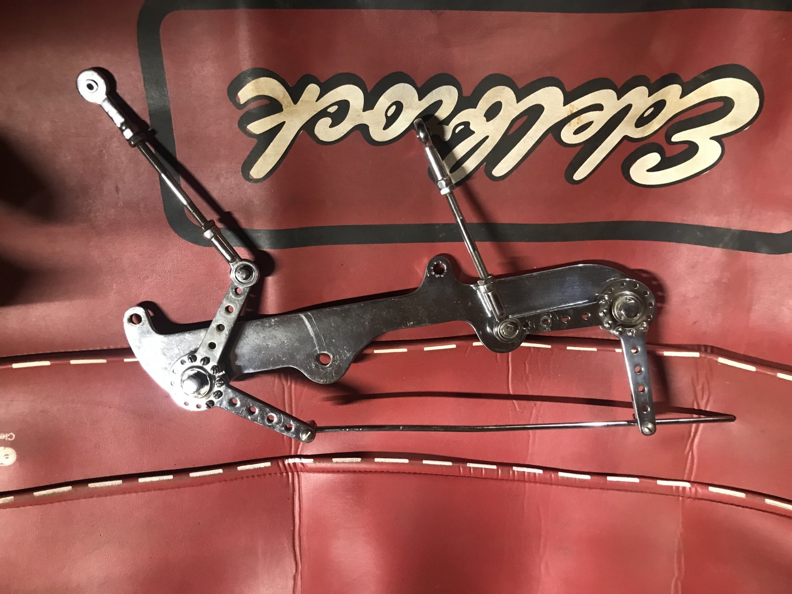

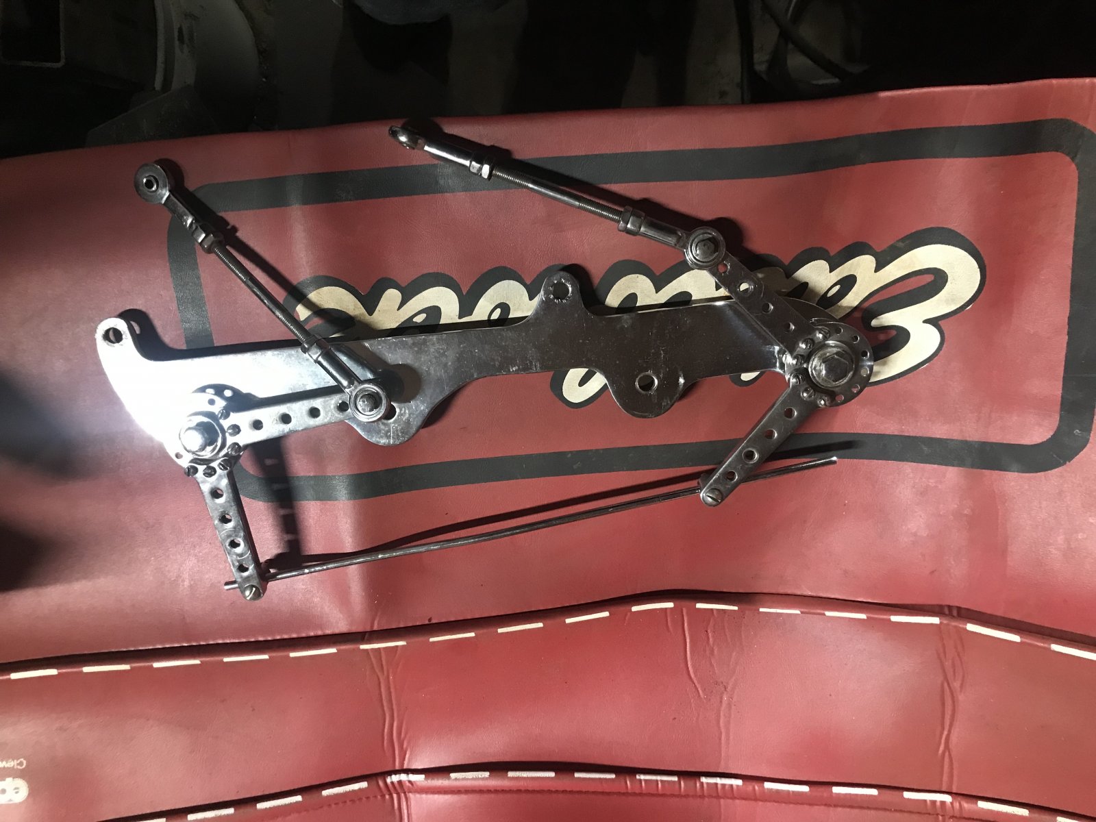

    E2123351-1E9A-4C4E-B2D5-4722FAE1902C.jpeg 6C701A94-2D24-4FC9-8524-9A52C60F3041.jpeg I have an Edelbrock dual carb set up listed , polished aluminum, polished stainless steel listed you might adapt . 72294122-2DE6-467A-AD78-741077FFE8F0.jpeg
    Robert J. Palmer likes this.
