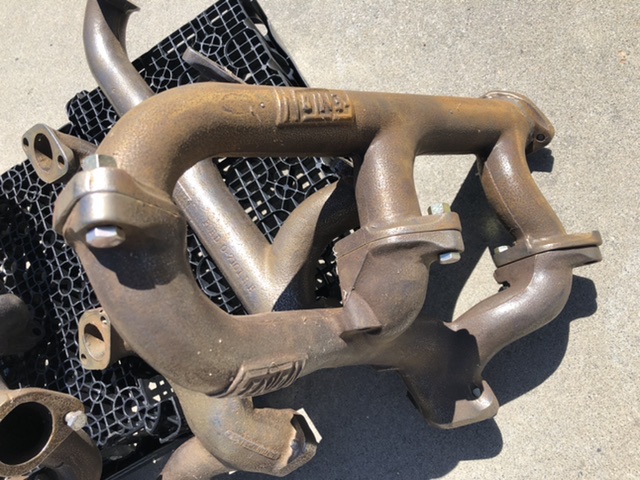

    I've heard a number of times that the Fenton headers that Speedway sells have interference issues with the steering box on LHD.
    Anyone have some specifics? Wondering if minor grinding is a fix or major with through wall grinding?
    This is what Speedway sells

    Here is a similar version of an original

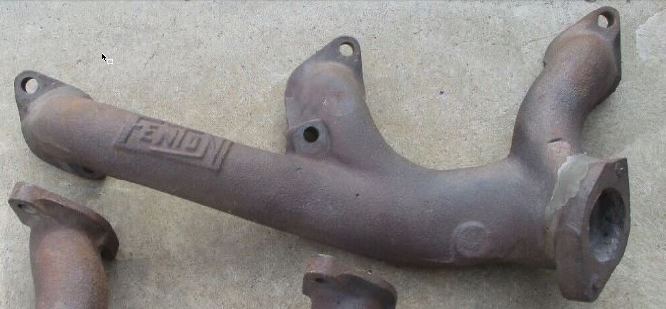

    And here is another original version with the exhaust dump facing down

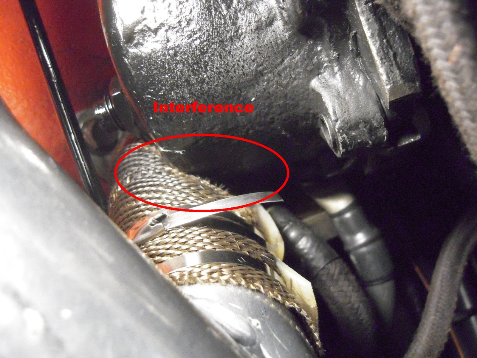

    The interference for my 59AB in a '32 roadster is on the lower corners of the steering box. There is also potential interference with the original starter switch.
    So which version of the originals has no interference and how bad is it with the Speedway and originals that are configured like Speedway's?

    I had a problem with the Fenton's on my '37 1/2 ton, had my machinist buddy angle mill the mounting flange and spot face for the mounting bolts.

  3. The second pic with pointing down has been cut and rewelded or braised. Braising WILL break. Different expansion rates.

    Yes, I just used the picture for reference.

    Hi Tom, was the facing across all three of the block mounting or just for the collector flange?
    Glenn
  6. hotcoupe
    Joined: Oct 3, 2007
    Posts: 641
    hotcoupe
    The three block mounting flanges were angle milled and the six bolt holes were spot faced. It doesn't take a lot to provide clearance for the steering box.
    Tom
  7. xix32
    Joined: Jun 12, 2008
    Posts: 627
    xix32
    Fenton ignored the most popular use of those cast headers ( the flathead ford v8 in a `32 Ford) they made them to fit something else. I've seen those flanges milled on an angle to make them miss the `32 steering box. But the flanges sure do get thin in the process. Even a set of "Red's" tubular headers aren't much better.

    Yes they're bad. That's what I have now with denting I did on the left rear.
    Glenn
  10. glennpm
    Joined: Mar 29, 2015
    Posts: 233
    glennpm
    I did some measurement this after and figure that moving the contact point inward 1" MIN, which is 7" below the top of the exhaust ports. This gives you about 8°. So if you angle the header flanges by 8°, this is about .344", a little under 3/8", ***uming the flange height is 2 1/4", a lot! I might try grinding the flanges off and re-shaping the flanges and pipe ends instead or a combination of the two.
