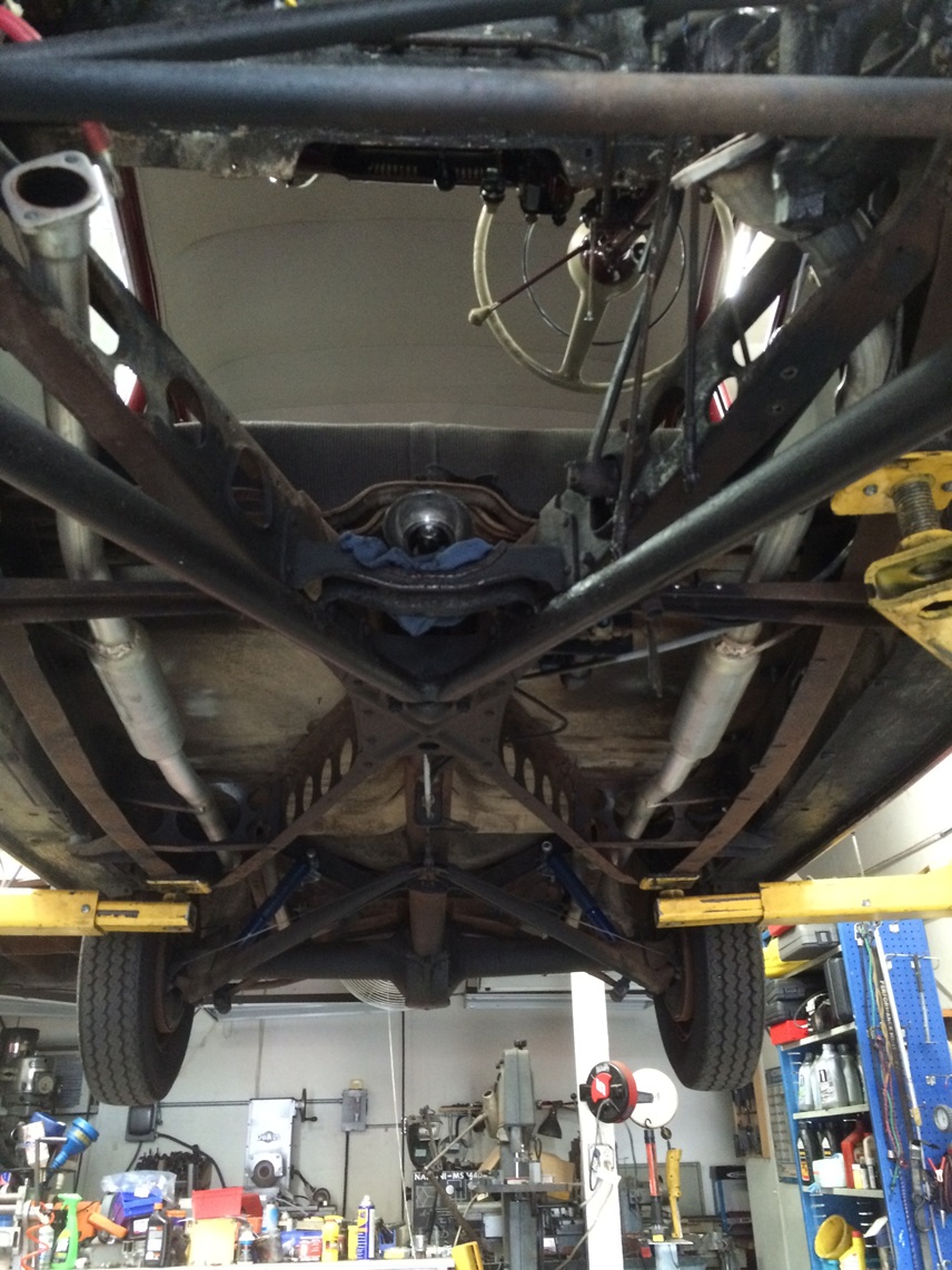

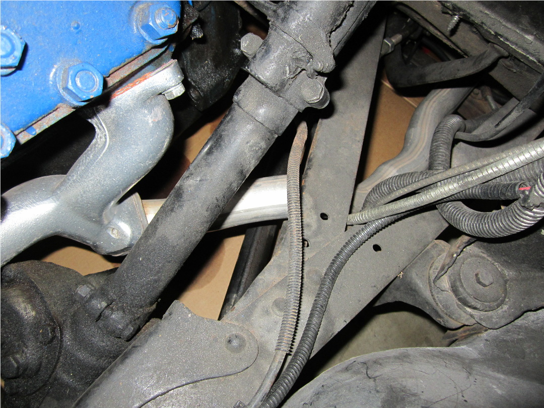

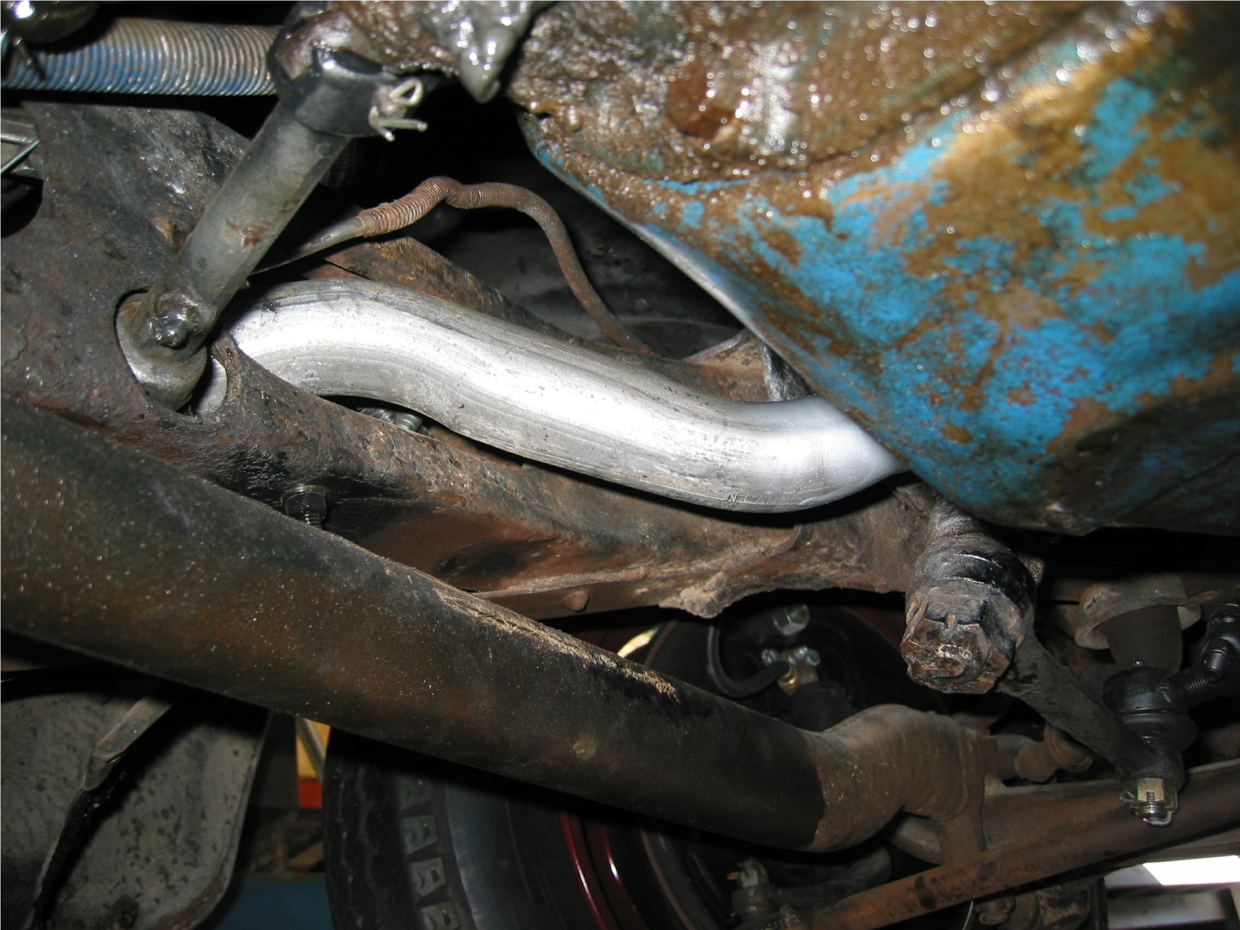

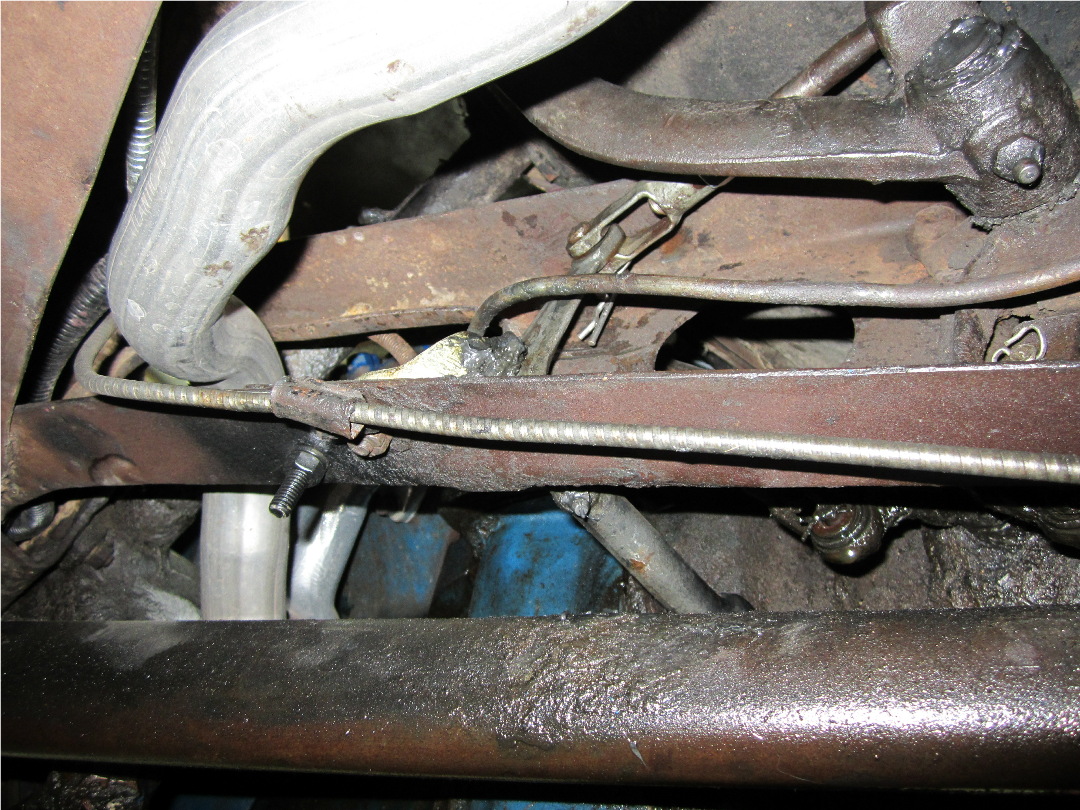

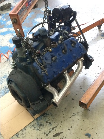

  14. Here's all the pics I have on my computer, I can get better ones or more this weekend (car is at my Moms).
    Most are from the drivers side, since that was the tricky part to get around the pedals and frame. You can see the pass header with the motor out and both pipes thought the frame with the motor out.
    exhaust-1.jpg exhaust-2.jpg exhaust-6.jpg trans rebuild-3.jpg trans rebuild-4a.jpg
    Budget36, alanp561 and warbird1 like this.

    @1oldtimer, sorry I didn't get back to you sooner. Thank you very much, those shots of the driver's side are exactly what I was looking for. The passenger side has its own problem, mainly there is only about an inch and a half from the end of the studs to the frame section I cut out.

  16. Glad to help. The shop had to do the drivers front twice, as the clutch pedal hit the pipe the first time.
    Let me know if you need more.
    alanp561 and Budget36 like this.
