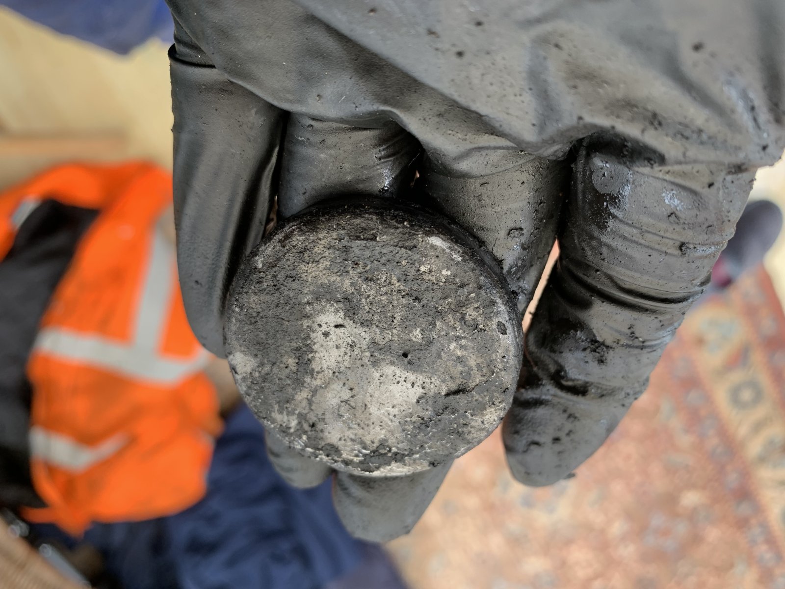

    Yes. I’ve found those bits on a couple of old engines are accumulated from years of poor use at the bottom of the water jacket and they are now find their way out, in both cases it needed a screw driver and jet wash at the bottom of the water jacket to break it up and get it out. This is the back of a core plug from a block that was previously flushed and looked clean from the top. IMG_6742.jpeg
