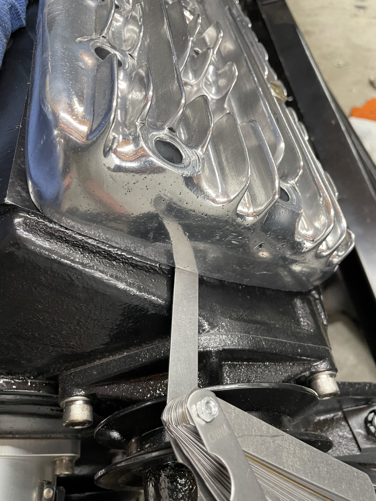

    I got my 59 short block back from the machine shop And have been working on getting it in my car.
    I put the heads on, and the Pistons are hitting the heads when I do not have a gasket on. I placed the head on loosely with a bolt holding it and turn the engine over by hand, with a thin layer of grease on the pistons the heads are moving up and down, so I have obvious an issue.
    when I loosely place a gasket between the block and the head, I do not get contact. I’m ***uming that when I torque the head down with the gasket that I will have piston contact still.
    HnH did what they call a big bore grind on the heads to get more clearance, but the pistons still hit.
    I can slip a .032 feeler gauge in the gap when the piston pushes the head up (without a gasket in place.
    What are my options to get my pistons to clear my heads?

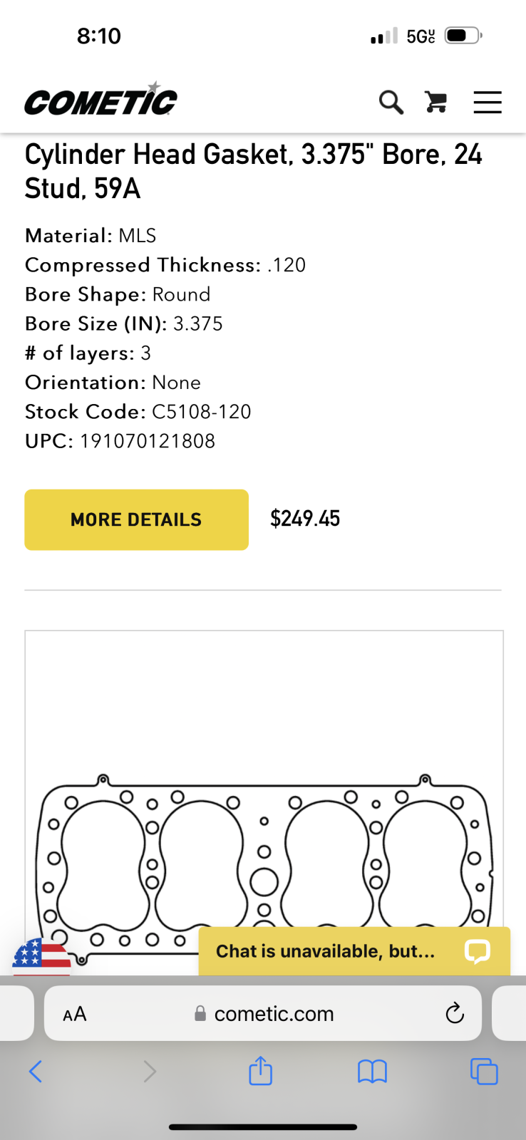

    Cometic sells a .018 to .140 compressed thickness head gasket but they aren’t cheap
    There are different thickness composite big bore gaskets from like speedway, Macs JEGS etc . Ive compared the thicknesses in the past between the brands wish I would have wrote it down.

    Thanks Tubman. I agree that those gaskets are expensive but it may be the easiest solution. Tomorrow I plan on checking clearance with clay and then need to make some hard decisions… $300 gaskets, more head machining, new heads….

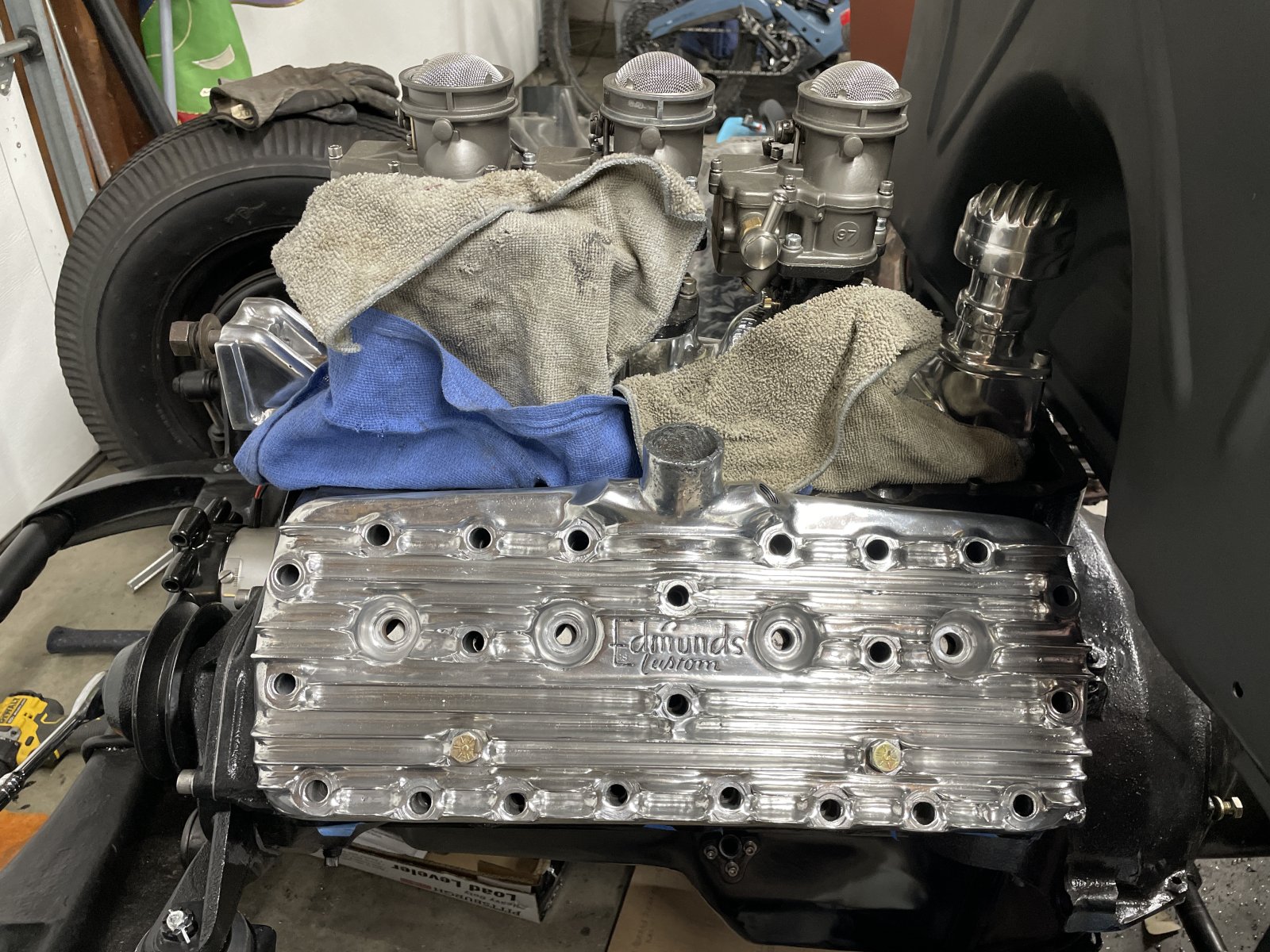

    BTW, the Edmunds heads are really the ones you want. If you look at them carefully, you can see that the spark plug has been relocated just enough so that it is not over the exhaust valve. This means that you can run extended tip plugs that really seem to help. I installed the current engine in my '51 club coupe in the summer of 2016. It has a set of reworked Edmunds heads and a set of Champion 328 (L82YC) spark plugs. I checked the original plugs last summer and they still looked perfect. The car is the best running flathead I have ever had. All other heads I have checked (both stock and aftermarket) have the plug located so that the exhaust valve will close the gap on an extended tip plug.
    Don't let those Edmunds heads get away, but if you do, I'd be interested.

    thanks for the tips. I bought them at a good price recently and check them out. They are “purdy”. After polishing, clear coat, and the HmH grind, they’ve become expensive. :).

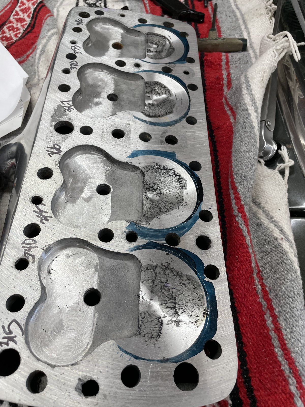

    In the 2nd picture ( cylinder head underside) the finish in the un-machined "dome"portion of the chambers looks mighty odd.
    I'm guessing all the patterns are etched in the aluminum, not missing material ?.

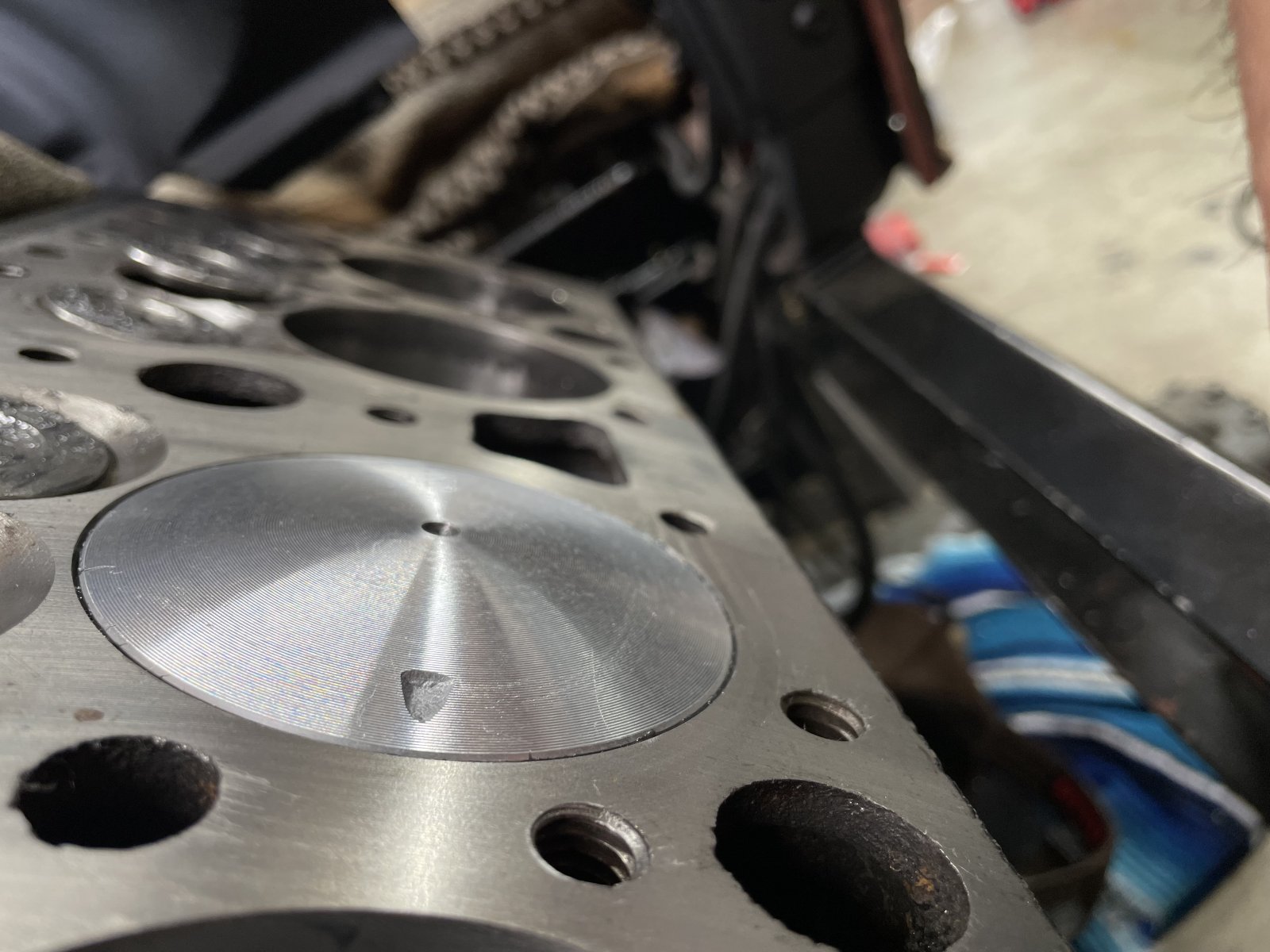

    Your third photo looks like the block has been "decked" and you can see who ever did that didn't bother to chamfer the stud holes. They may have cut way too much off for some unknown reason. Perhaps a set of custom made gasket shaped spacers can save your engine.

    are you seeing the light grease I put on the pistons that transferred to the head when the pistons touched during rotation?

    good eye. Yeah this engine has been decked probably many times

    I used clay puddy today to check the piston to head clearance with gaskets in. Clearances range between .01 and .03 so I shipped them down to HnH for a little more haircut. Fingers crossed all goes smoothly.
    Tow Truck Tom likes this.
  22. DreamerJ
    Joined: Oct 3, 2021
    Posts: 134
    DreamerJ
    To close the loop.... HnH gave the heads a little more haircut and all the clearances were clayed and checked out perfect. Big thanks to Mike for turning these around quickly for me so I could trailer the car halfway cross the country.
