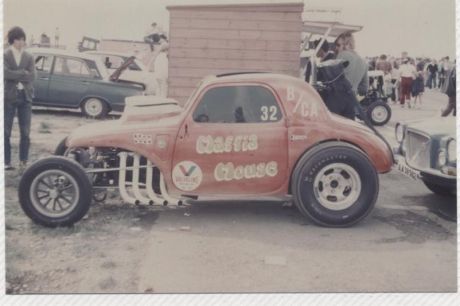

    Some more pics.

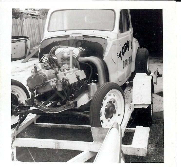

  20. Under the hood they are pretty much the same . If you cut the longer 1950s hood in half the early 1940s round nose will fit. Ofcourse you will have to cut the higher front inner panels away. The 1950s model C is not as ugly as some have stated. The trunk area is a little longer and you will see a big rear bumper panel and sparewheel door. Metalshapes 2nd pic, Outcast 1 , shows a C body with the bumper and sparewheel door removed.

    Heres a couple photos of the car in other guises. Originally from Alberta, Kelowna BC later on, IIRC.
