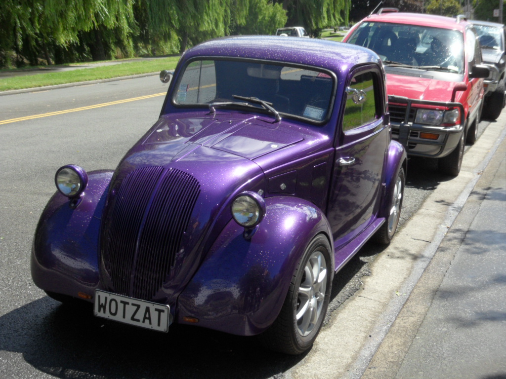

    For over 25 years I have wanted a street legal Topolino with a strong altered flavour. I ignored the fact that Im over 6 foot tall and weigh around 240 odd lbs on a good day, and about 12 years ago went out and bought one that still had guards on it, a box chassis and a 4 cylinder Jappa engine.
    My wife took a shine to it big time so we finished it and its her car, complete with its little engine.

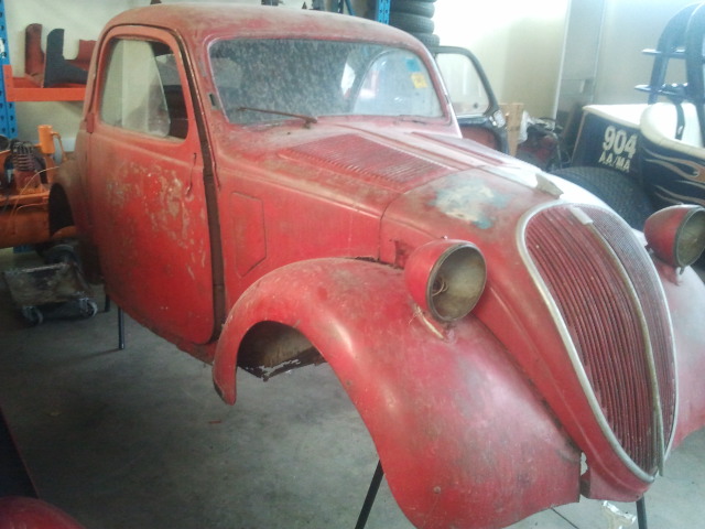

    So a few years ago I bought a pretty rusty one for my planned project, (SBC 671 Hilborn EFI glide and 9 inch) but I have big issues actually fitting into it. I can fit into my wifes one easily as it still has the footwells, but mine wont have any as the heads will be in the top of the footwell areas and the firewall will then be way back.
    Can anyone whose been involved in a Topo build offer me any guidance please. Currently its like trying to fit a 10lb chicken into a 6lb chicken bag.

  6. I figure I can get the wheelbase to around 100 inches (my blown BBC bucket is 102) by putting the front axle just in behind the grill. I can fit easily into my wifes 4 cylinder car (the purple one), primarily because the footwells are still in place. If I extend the nose I still have footwell issues, because the guard opening curve needs to follow the "guards line". Bad News (5).JPG
    This "Bad News" Topo pikky probably demonstrates my problem best. The footwell is gone.
    I reckon I could lose about 20lbs all up and I have a relatively long back and relatively short legs (I could be the worlds biggest dwarf) so the packaging issues are around seating,pedals, brakes and steering. A removable steering wheel is an easy solution to getting into and out of the car and I have abandoned the plan to put a cage into it. Ive looked at van brake pedal boxes with the bellcrank 90 degree turned master cylinder because I dont think there will be any room under the seat/floor for the master cylinder and booster.

  8. Im okay for width in my wifes purple Topo.
    The big problem is getting some footwell space for my size 12s, while also having room for the pedals. I dont think we have the ability to add a few inches of length to the main cabin area which is the other solution that we came up with.
