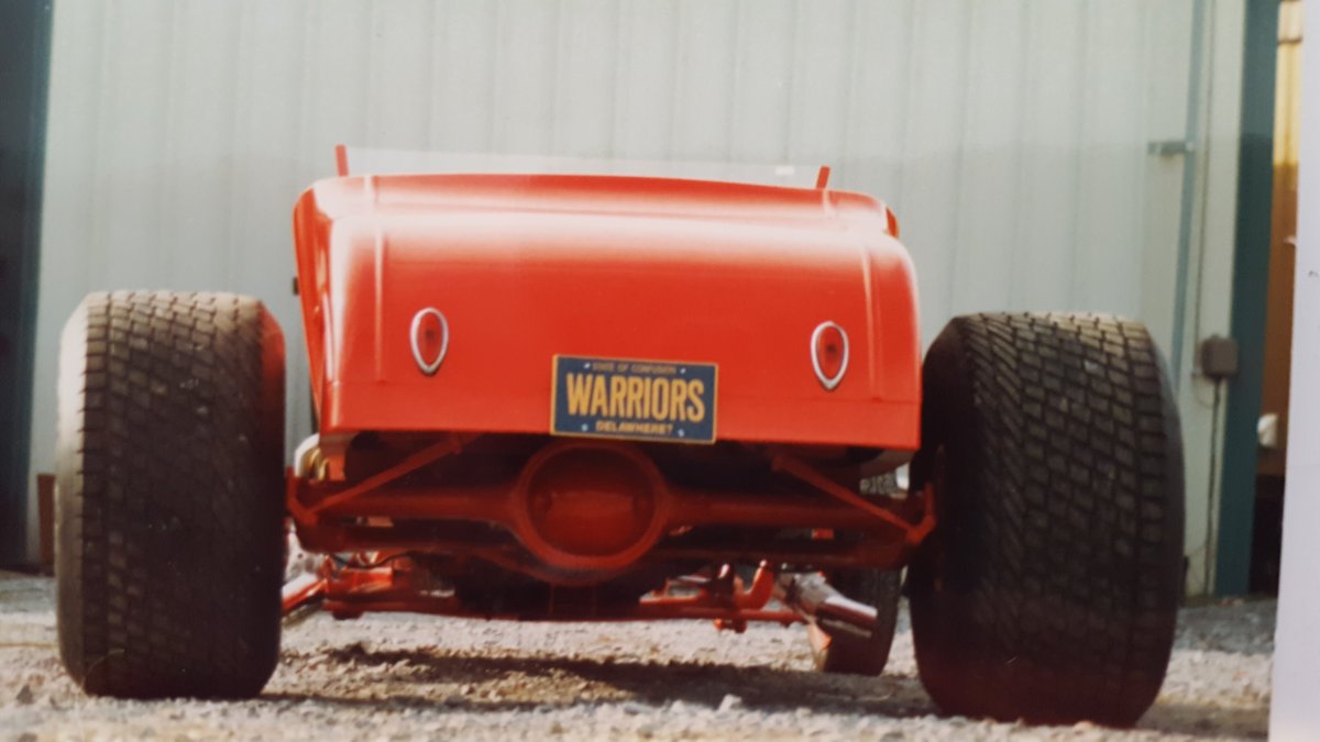

  11. 022.jpg 023.jpg Here's one we built in the 80's. It started with just a bare bones 27 body from Speedway Motors. A boxed Model A frame, dropped axle, with split bones, { front and rear} and a junkyard SBC. The seat folded forwards to fill the gas tank. Just a hop in and out, with no doors or deck lid.:rolleyes: I used 3/4'' marine plywood to gl*** in the floor. It had 36 Ford wire wheels, stock fronts with motor cycle tires, and widen rears with Firestone dirt tracks. It was a very CHEAP, and FUN little roadster. :) Ron...

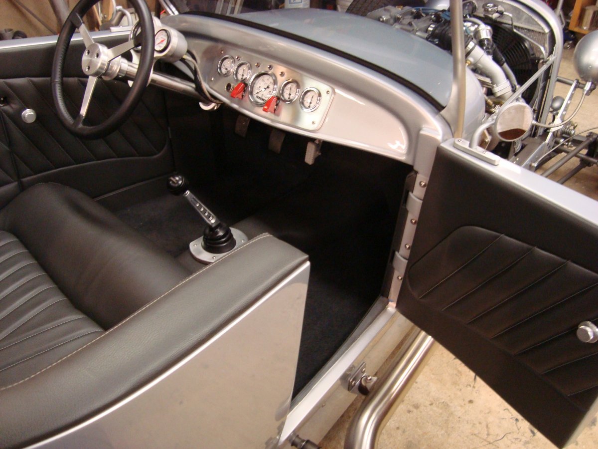

    When I built the roadster ,I started with just a body shell . The doors supplied were just skins. I ended up building a DOM tubing body frame , building complete doors, fabricating the hinges , building a complete new floorpan and reworking the dash.
    But , I learned a ton about working with fibergl***... It's not a scary as you would think and I got some great advice from a pro..To me ,a great part of any project is the skills you learn as you build it.
    Go for it !!!
