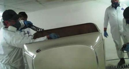

    I'm working a good spray system out of Kansas.Stude-sled on this forum is in Missouri having success with the same system.You could call our supplier directly if you would prefer referral to a closer shop.I know there are good shops in the east.The supplier web-site is goldtouchinc.com. Ph.-800-941-7874
