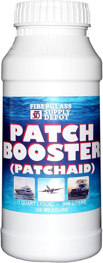

    You should not use pure gelcoat on top of body filler. You need to cut the first gelcoat coat with patchaid. Read the instructions on the sales page. Guide coat and block sand. Respray more gelcoat if you sand through. Guide and block until your happy. We don't use primer. Spray color straight on the gelcoat.
    https://fiberglasssupplydepot.com/Gelcoat-Patchaid.html
