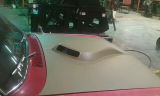

    Heres an update, I trimmed the lip up for a better fit yesterday . I also drilled some extra holes in the lip for the epoxy to seep through. I the cleaned the mating surfaces about 10 times to be sure. I drilled 1/8" holes in 10 places on the scoop and hood for sheet metal screw to hold it in place until it was set up. Today I went out and looked at it and it seems to be good. I decided to leave the screws in and cut them off flush with the hood .
    I trimmed the support for clearance for the air cleaner and tacked everything back in. and primed the center of the hood for now. As my car sits outside I have to work on it in the evenings and weekends at my work. I think it looks ok and will look alot better soon :eek: I still need to finish the welding and do the filling on the hood theres no finish work on the hood or scoop in the pics . I got the fit pretty close as you can see

    I hate to say this. I removed all self tapping screws out of fear that what was left of the screw would reflect a small crack the size of the screw in the finish later. The metal of the screw will be pretty close to the surface of the filler.
    The shape of the scoop does look good on there.

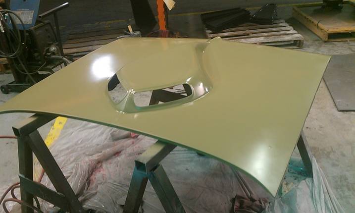

    Ok heres what I did this weekend.. Nowhere near the caliber of what most of you guys do but im pretty happy with the results. I strpped it down to bare metal. started with fiberglass reinforced putty, fished with some putty. . Blended the hood line into the scoop pretty nice and gave it a couple of coats of etching primer. Looks decent so far :D

    Don't know what you used for primer and how much. Many of the cheaper primers shrink considerably even after they feel dry to the touch. Where perfection is the goal, I have a ten day rule. I won't final wet sand the last coat of primer for ten days to make sure it has fully cured (no more solvent pop) and has shrunk to equilibrium. Assuming the primer is and the polyester is not the problem, thee different rates of expansion could be it.
  29. This may help......when bonding that scoop on the metal hood-did you leave the fiberglass edge of scoop as molded or did you grind the outer edge down [like to a featheredge?]
    If you did not grind that sharp sqared edge off it will "imprint" where the filler meets that straight edge abruptly
    [sorta like trying to paint over stripe tape for example....]
  30. Shaner's74
    Joined: Dec 19, 2011
    Posts: 76
    Shaner's74
    I used PPG K36 primer and I feathered the edges of the scoops down to paper thin. They were bonded to the hood with 3M fiberglass to metal adhesive. Sorry, I don't remember the #. The hood probably set for a week before it was sanded. I had the car at a friend's house and worked on it on Saturdays. Prime one and sand the next. The entire body was primed and long blocked a couple of times at least to make sure she was straight. Any ideas to correct this, otherwise I'm going to go back to the original hood. Thanks.
