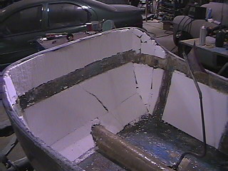

    hahahahaha No seriously. Me and my son Tyler Did some work to the T bucket satruday and a lil this morning. We made a plywood floor and glassed it in. as well as a custom wrap around dash check it out it's bitchin'.

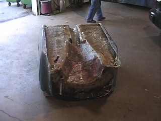

    our hamade driveshaft tunnel layered over some pipe to create the mold. about 4 layers of glass on em.

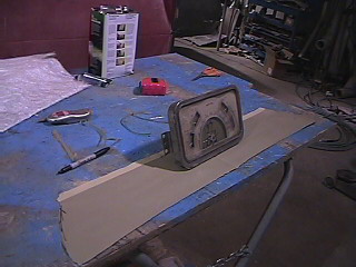

    the custom dash. we started the dash out by drawing out a template then cutting out like 3 layers of glass. The lil instrument cluster I have to install says "saftey first". lemme assure you that this car will plolly be anything from safe hahahaha

    here are some more updated pics from today. I braced up the inside and foamed the voids..

    then I glassed some steel rod to the inner to create a divider between what will be painted and what will be upholstered. and glassed that in.
