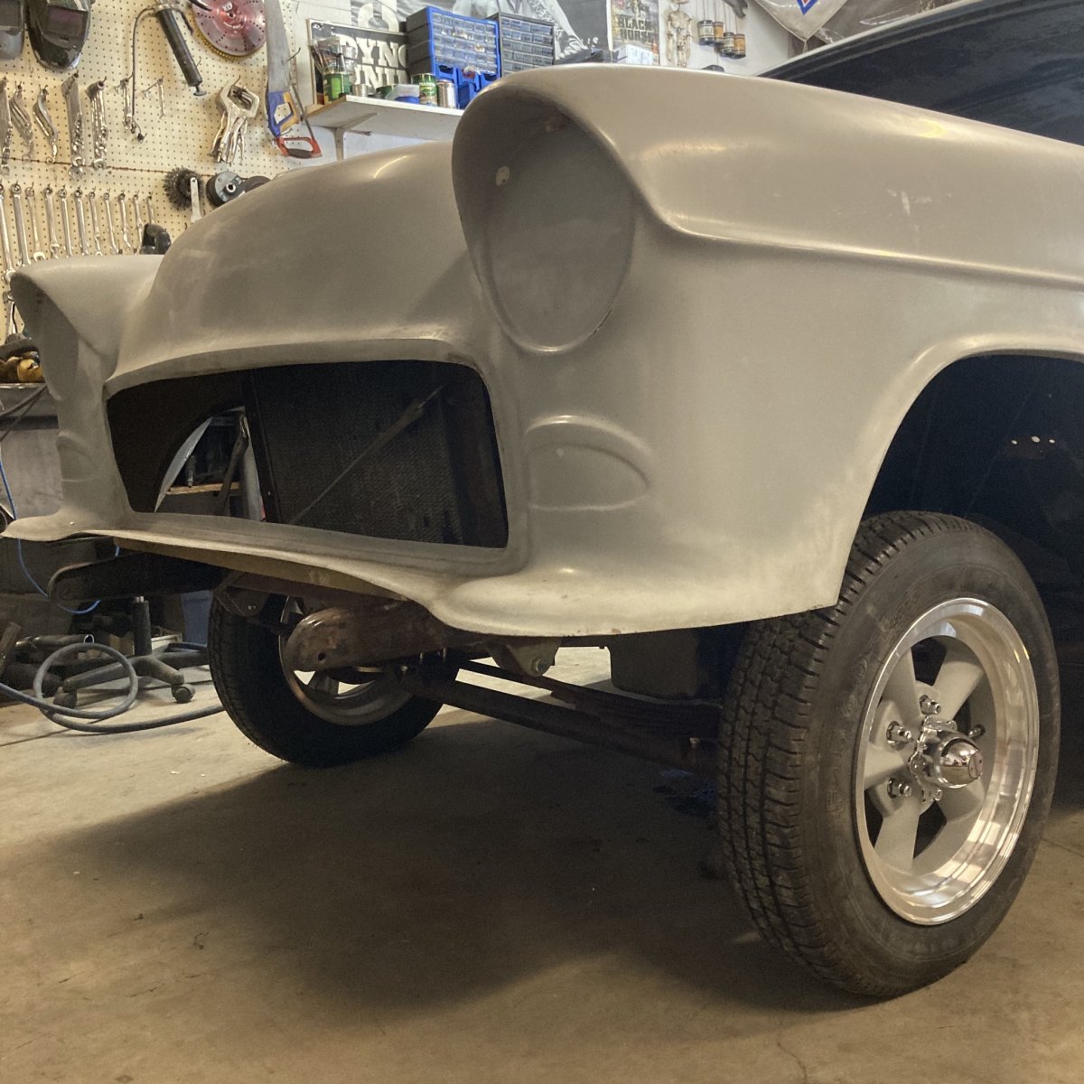

    Just wondering how others go about bracing their fibergl*** front ends?
    I have a few ideas, mainly using round tubing, just not sure what size and thickness of tubing to use.
    I usually go way to overkill on everything, so pictures or examples would be great.
    This is on a 55 Chevy with a one piece tilt front end.
    Also, where it connects to the fibergl***, normally guys just use an auto body glue to stick the metal (perforated or other) to the fibergl***? Do you leave it at that point of fibergl*** over top of the patches as well?

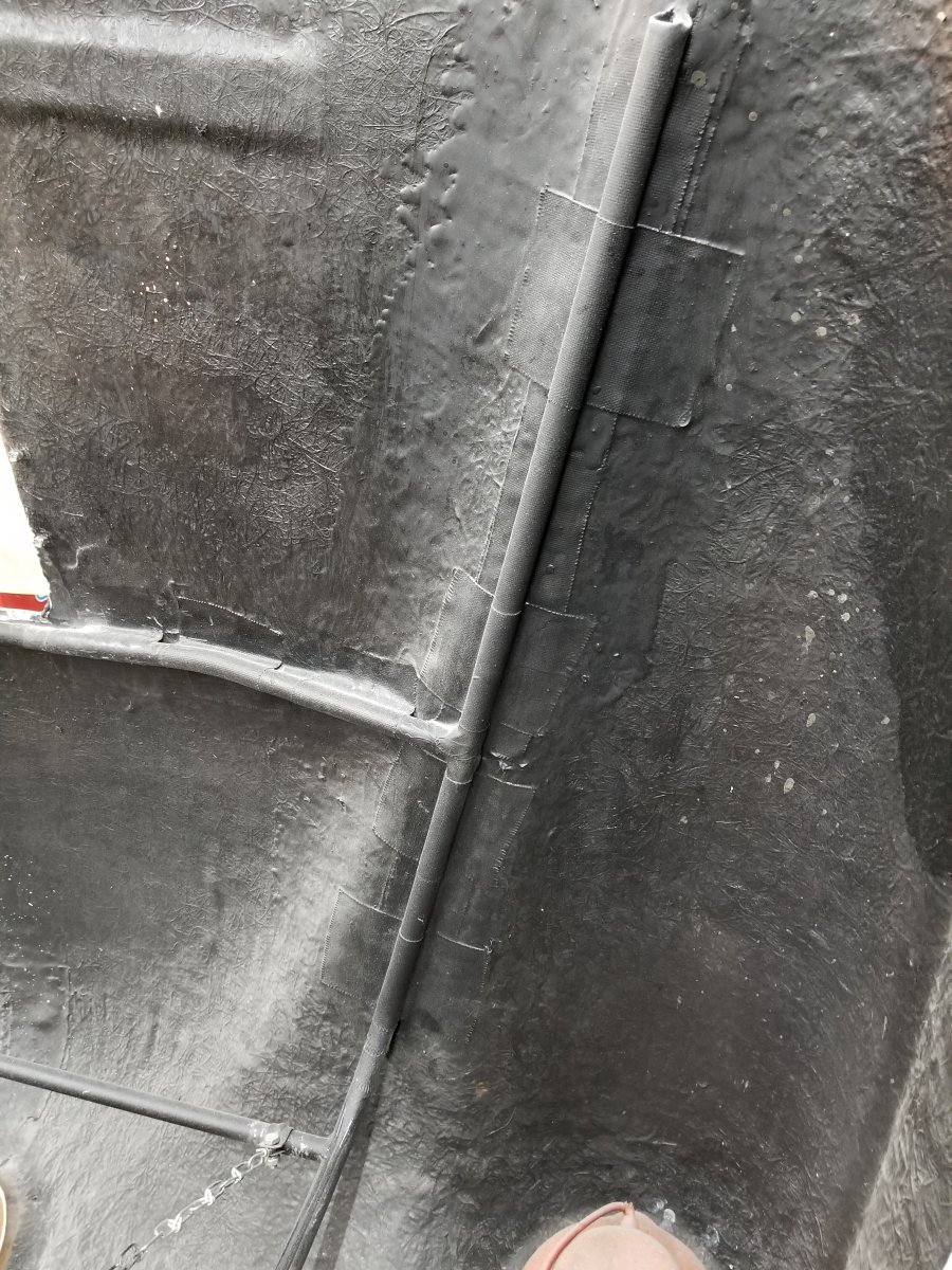

    The Willy's in my Avatar has a gl***, tilt front end. To give it strength and keep it strong I bent & glued 1/2" copper tubing all the way around the perimeter, inside wheel wheels, etc. After that we gl***ed over the copper tubing, sanded and contoured the inside lip & painted. It's very strong and now when you run your fingers underneath the wheel opening lip it feels like a steel front end the best it can, plus gives it that finished look when open. The rear wheel well radius I glued 1/2" rubber hose because it followed the contour better, kitty hair over that, finish gl***, sand, sand, sand, paint! Used bent Conduit, for the tilt part than same procedure to finish.

    I used conduit and lots of others have as well, it's a pretty common brace, I laid mat and resin over it to bond to the fibergl***. I also made sure and put a cross bar at the scoop hole opening, that's where I grab it to tilt it forward so I'm not pulling on the fibergl*** itself.

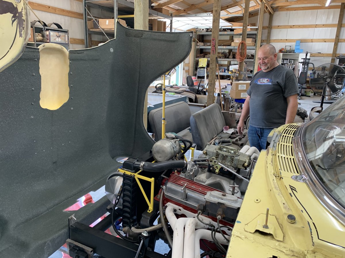

    The front end on my 1950 F1 was pretty floppy. This is what worked well for me.
