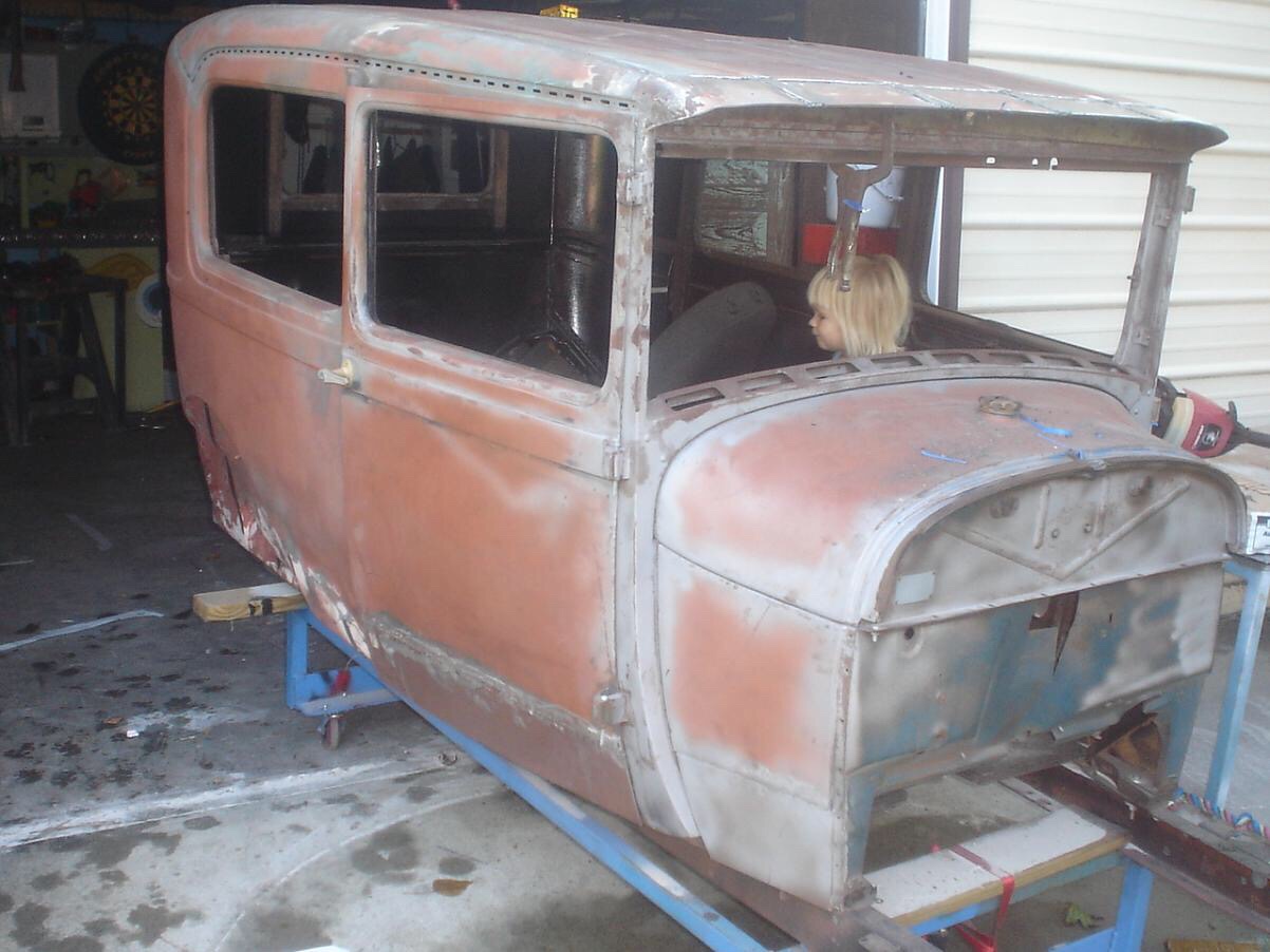

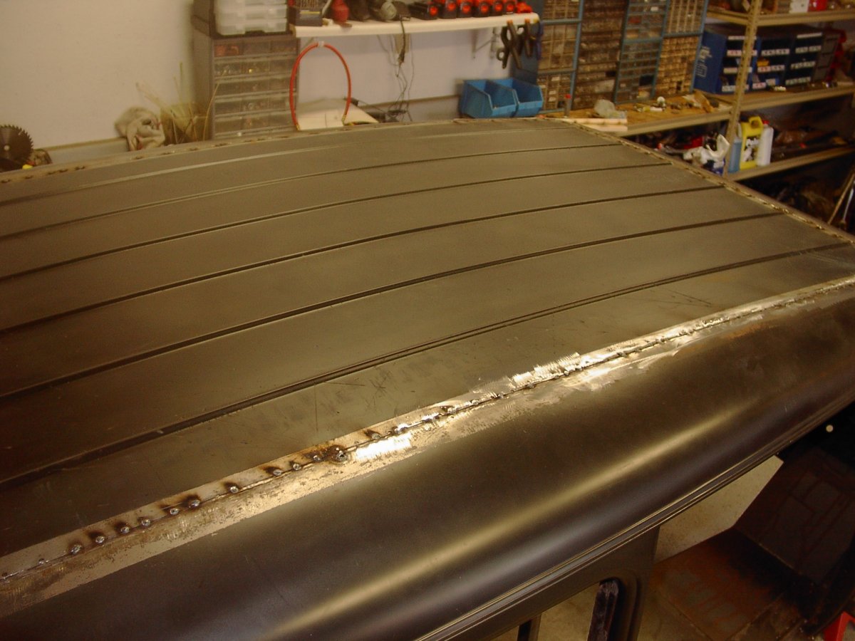

    [​IMG][​IMG]
    Used a ford Astro van roof flipped reverse

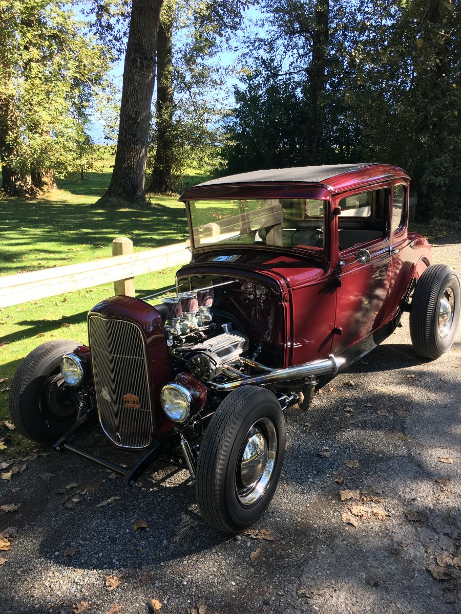

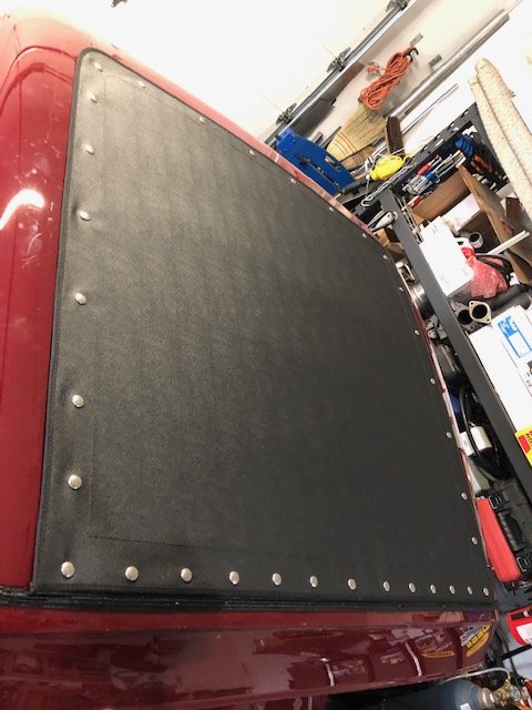

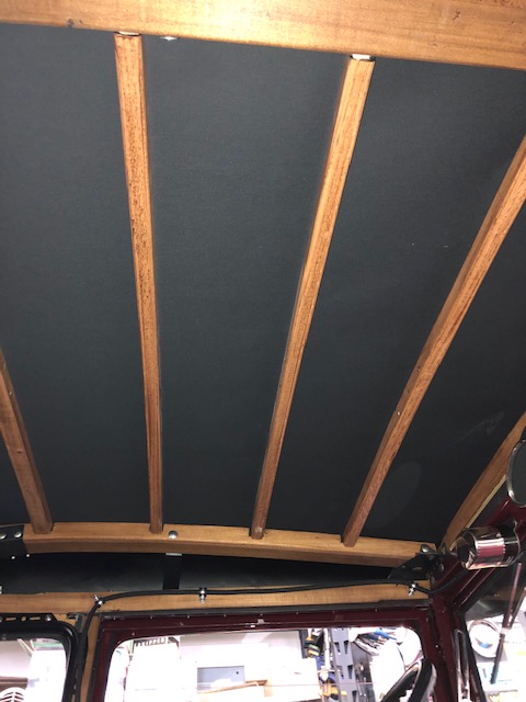

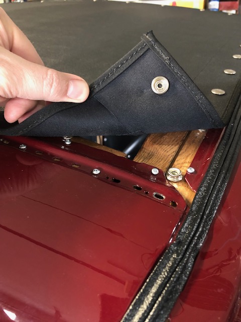

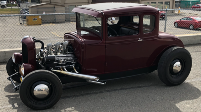

    I prefer it unfilled and showing the wood the way i did my coupe. Cover with snaps so i can remove in the summer if i want.

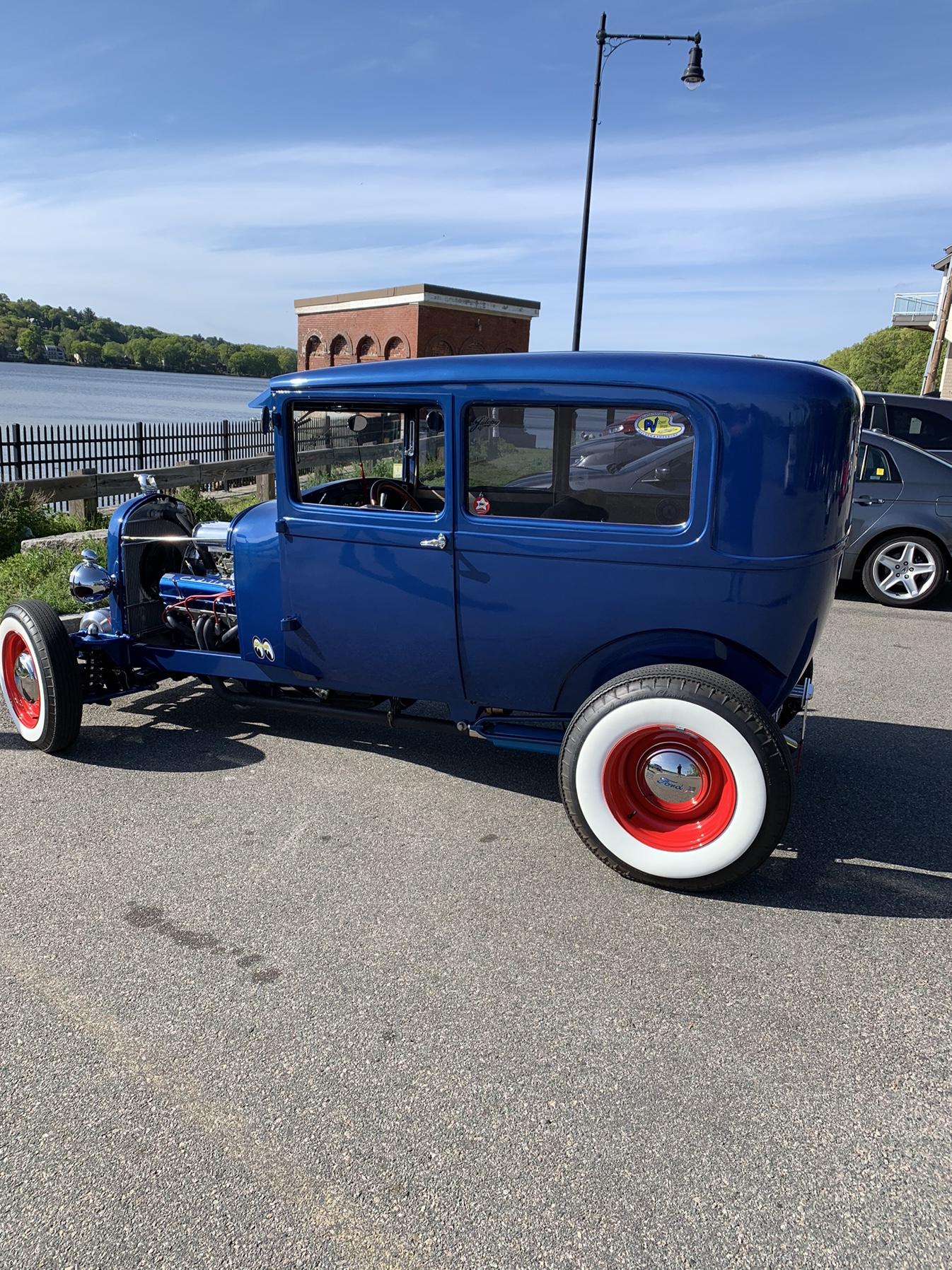

    I filled mine....Hated leaky roofs....But i left all the structure if someone ever wants to remove the metal panel.... Cruise night 5.jpg

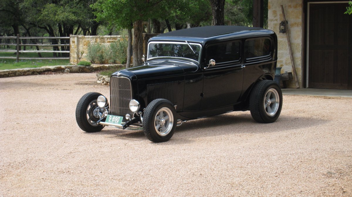

  15. I have both. I drive the U.F.O. in all kinds of weather, so I went with a filled roof. I used a metal roof from a 70 Plymouth. The others don't get driven in bad weather, so I went soft tops. I used Mercedes Benz convertible top cloth on my delivery, and the 31 A sedan. Ron........ 109.jpg 532.jpg 201.jpg
