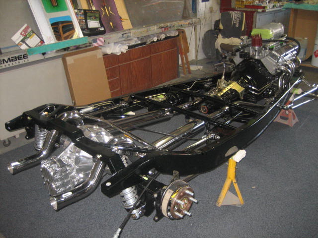

    An old 3M buffing pad fits on top of a standard floor jack lift pad really well and will protect painted suspension pieces from gettting scratched. If you don't have any, a thick layer of rags works. We also tape rags to the tops of jack stands to similarly protect the painted suspension parts.
    As for guiding a body down onto the frame, we take some very long bolts (6-10 inches) that are the same thread size as the threaded holes in the top of the frame, and we cut the heads off of the bolts, and round the cut off stub on the grinder.
    We thread these long studs into about 4 places on the top of the frame, and they act as guides when lowering the body down. We slowly lower the body down until it is just touching these studs, then we make sure they are p***ing through the holes in the body where the final body bolts will go. As the body continues down these long studs will keep the body in the exact position it needs to be until it is resting on the frame. Then we simply unscrew the long studs and insert the real body bolts in their place.
    If you don't do it this way the body is very hard to bring down onto the frame in the exact spot where it needs to go, and you will have to keep shifting it around to line it up. With the guide studs there is no guesswork.
    Don

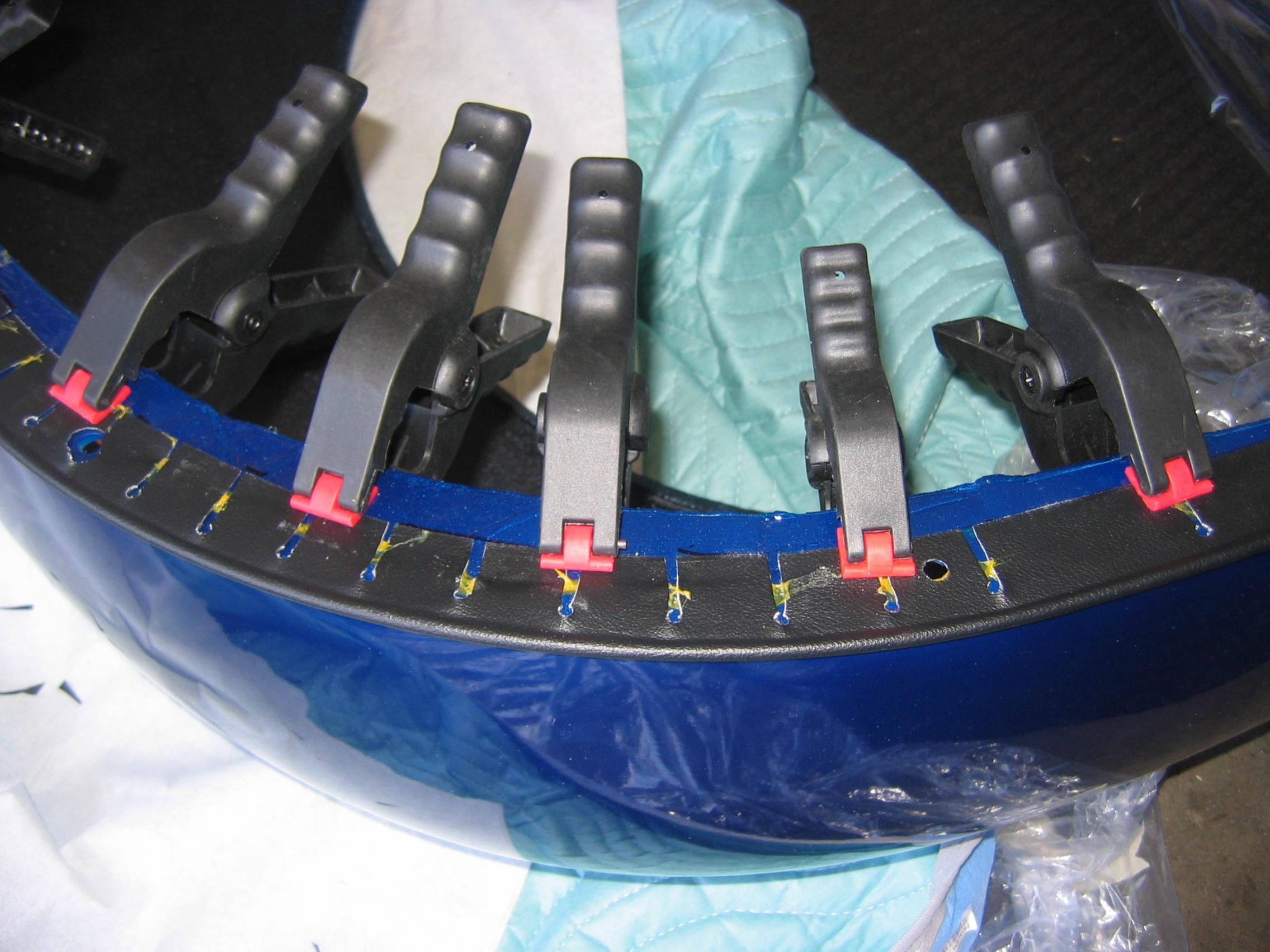

    X2 but the downside is you may miss how it looked later. Another thing I discovered was that by using a holepunch at the end of every slot in welting it became much more cooperative.
