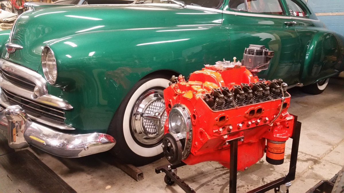

  9. low budget
    Joined: Nov 15, 2006
    Posts: 5,566
    low budget
    from Central Ky
    Wow, Nice ride! Any recent pics of just the car?
    That orange engine sitting by the car makes a fun contrast against the green, a red or orange wheel lip showing might be cool too, or not???
    chryslerfan55 and robber like this.
