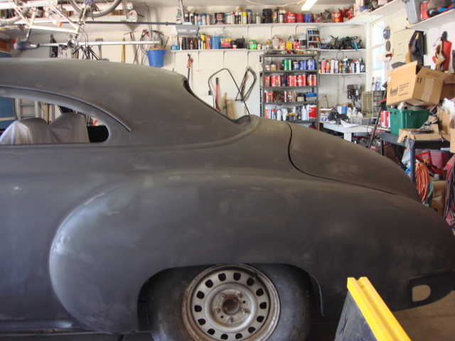

    Dang, it's been quite a while since I updated this.
    I have been working on it, filler and skirts mainly but I did hone my painting skills on my house:rolleyes:
    This long weekend was a milestone. covered the bare metal again.:eek:

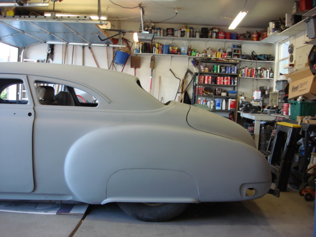

  13. Thommyknocker
    Joined: Dec 15, 2006
    Posts: 1,244
    Thommyknocker
    from Colorado
    Thanks Buddy, I can't wait to see the Flatcad. Call me next time your in town.
    The plan is to block it out this winter.
    I kinda screwed up, the roof is a bit texturie :( That and I blew up the compressor :mad: She threw sparks and let the wire smoke out:eek:

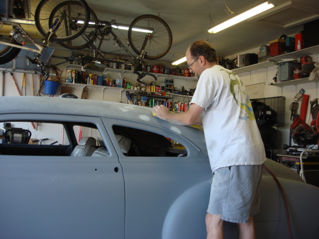

    Hey guys,
    No big updates, I'm about 1/2 way done blocking it out. I got all winter till it's warm enough to paint again

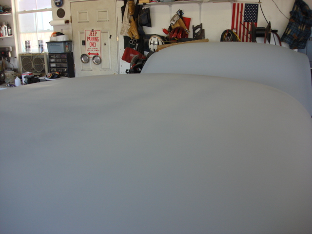

    Not to much:rolleyes:
    3 more coats of primer, and about a week and a 1/2 of wet sanding.
    I'm getting there. Just the front clip and 1 door to go.

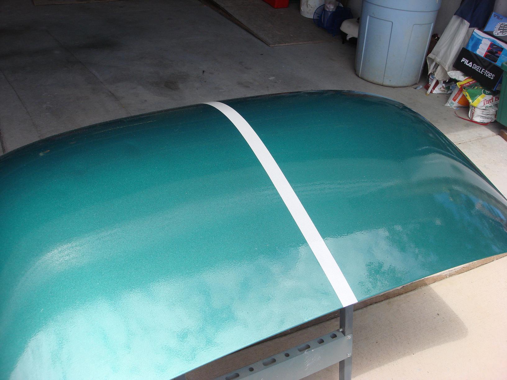

    Finally!
    I've got a shiny bit :D
    This is my spare trunk I'm practicing my paint skills on.
    I'm glad I did this, I've learned a lot from my mistakes.
    The paint is Summit Racing's Dark Jade metallic, and silver.
    The clear I shot is the high solids from summit also.
    The gun is a Harbor Freight HVLP.
    What I've learned:
    Color is easier to handle with more of a drop coat. It avoids the tiger stripes easier.
    Clear.....hose it on. It comes out so much smoother when there is a bit more material to wet out. I'll have to figure out how to color sand and buff next.

    I love the look of unbuffed clear coat just be careful no to run it lol last looks good btw
