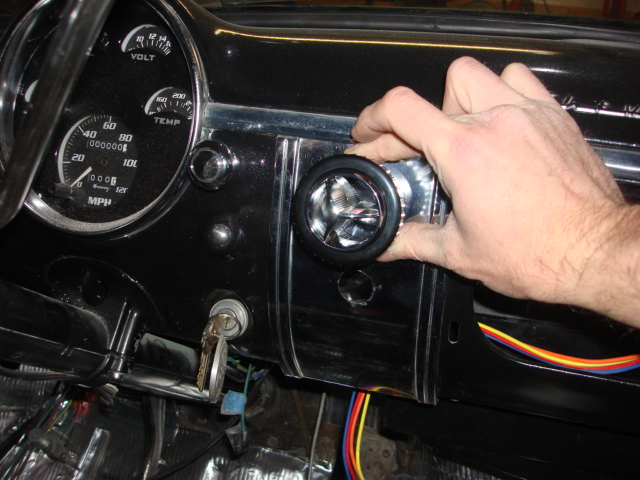

    I'm playing with a few things. I went to Lowes and picked out some drawer pulls to get all the switches to match. You can see the choke cable in this pic. I need one more pull switch for the wipers.
    I'm also planing out the dash vents. I've got 2 blank plates, no radio or ash tray. I'm thinking of putting the vent up towards the top where the trim piece is flat, but this one has another hole in it. :(
    Do you guys remember the cigarette lighters that had the map light in them? Looks like Gander mountain has them, so I'll swing by this weekend and pick one up to fill that hole with.

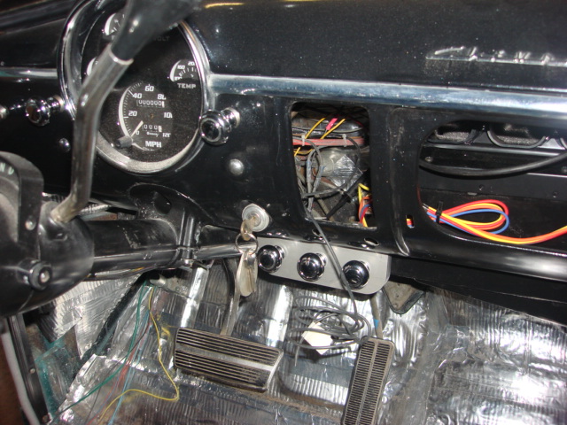

    I'm also designing a custom under dash bracket to hold the HVAC controls. The cables have a big *** 7/8" nut which I desperately want to hide somehow :confused:

    Edit: and attached is a pic of the bracket I'm going to make for the HVAC controls. The back piece will be 1/2" thk 6061 and the front piece I'll try some 14 gauge 304 SST I have here at work. I'll see how well it will buff up.
    I'll mount this under the dash, just to the right of the steering column

    I had some time on one of our milling machines Friday to whip out my little "G" job ;)
    I think I'll paint the aluminum black, and try polishing the SST.
    I've got all my wiring sorted back out, and everything tested A-OK.

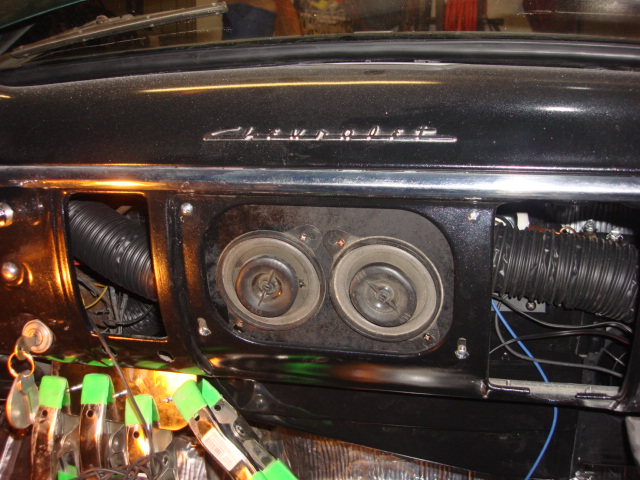

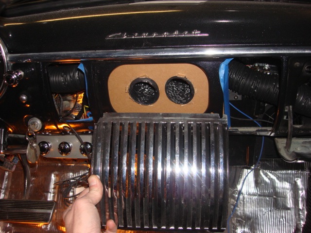

    I tried using the speaker grill for the center duct by mocking up a plenum with tape and cardboard. The grill doesn't let the air blow back far enough for you to feel in the seated position, most of it goes to the sides because of the louvers.
    Oh well, I'll poke holes in the radio delete plates.

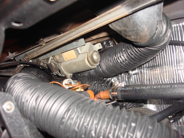

    And here's a pic of the defrost and heater ducts, tucked up behind the wiper motor. The one running in the foreground is for the outboard vent, it can tuck above the glove box. It's a tight fit :D

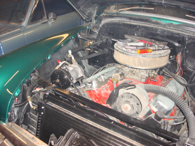

    More a/c stuff.
    And another good experience with Cl***ic Auto Air Industries.
    No one local could/would crimp my hoses, one quick call to them solved that.
    I think they crimped my hoses and shipped them back the same day, and I got a call from them saying so. Can't ask for more than that!
    Before I put the grill back on, I went ahead and pulled a vacuum on the system to look for leaks. It held 22" overnight.

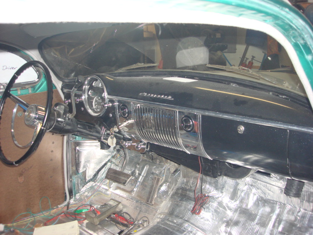

    I also finished up under the dash. I can did it. Oh, and I forgot I had these little speakers in a box, so I made a plate to mount them, worth a try at least.

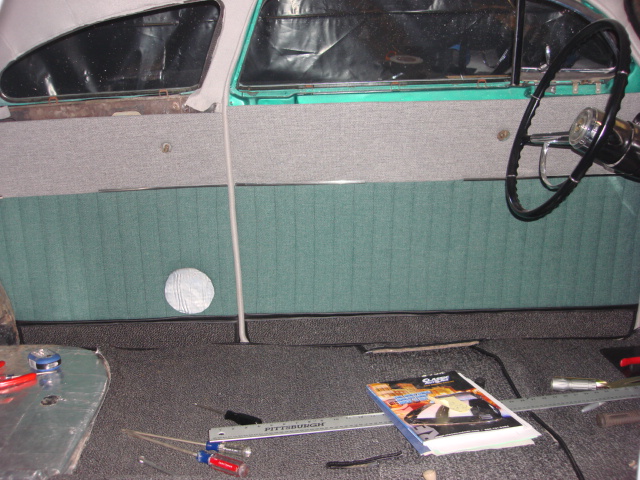

    I stayed up late last night, and finished installing the door panels.
