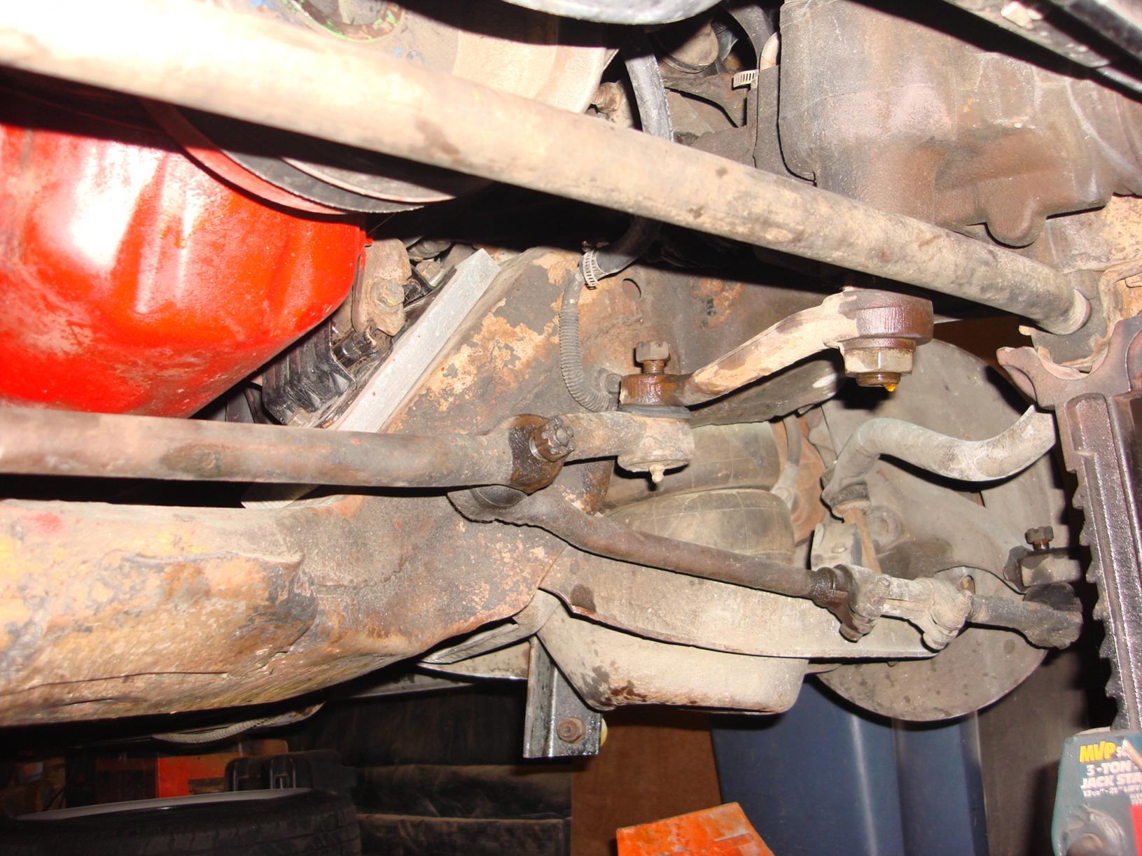

    The front end needs rebuilt, the center link is shot and the ball joints have never been replaced lol.
    Unfortunately it's a 2nd gen Firebird subframe. I really don't want to pay $200 for the center link, so I'll convert it over to $50 Camaro parts. :D

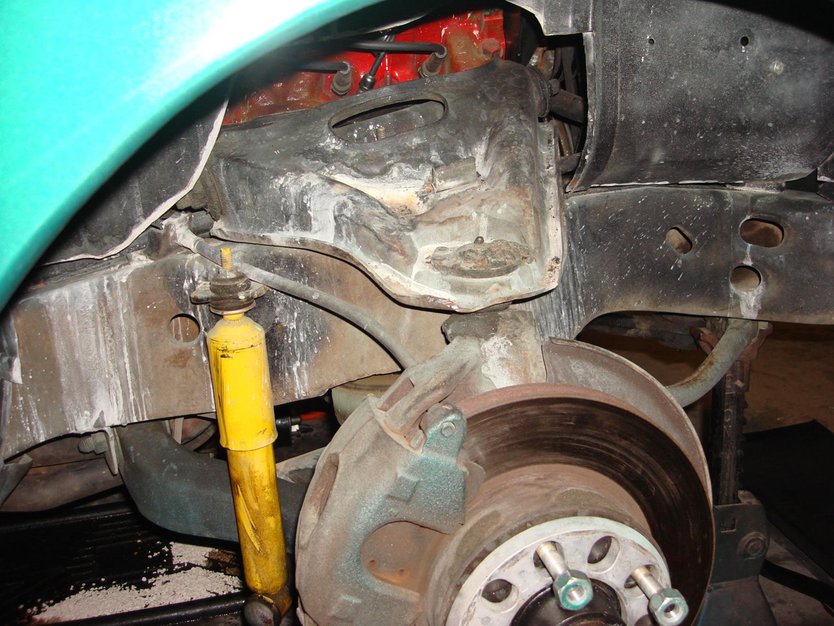

    I miss-measured for the front shocks, and I ruined one already.
    Probably because the tires rub them sideways.
    Is there any reason I can't put the shocks on the upper control arm?
    I could build a bridge from the frame over the top for the upper mount, like the 4X4 guys.

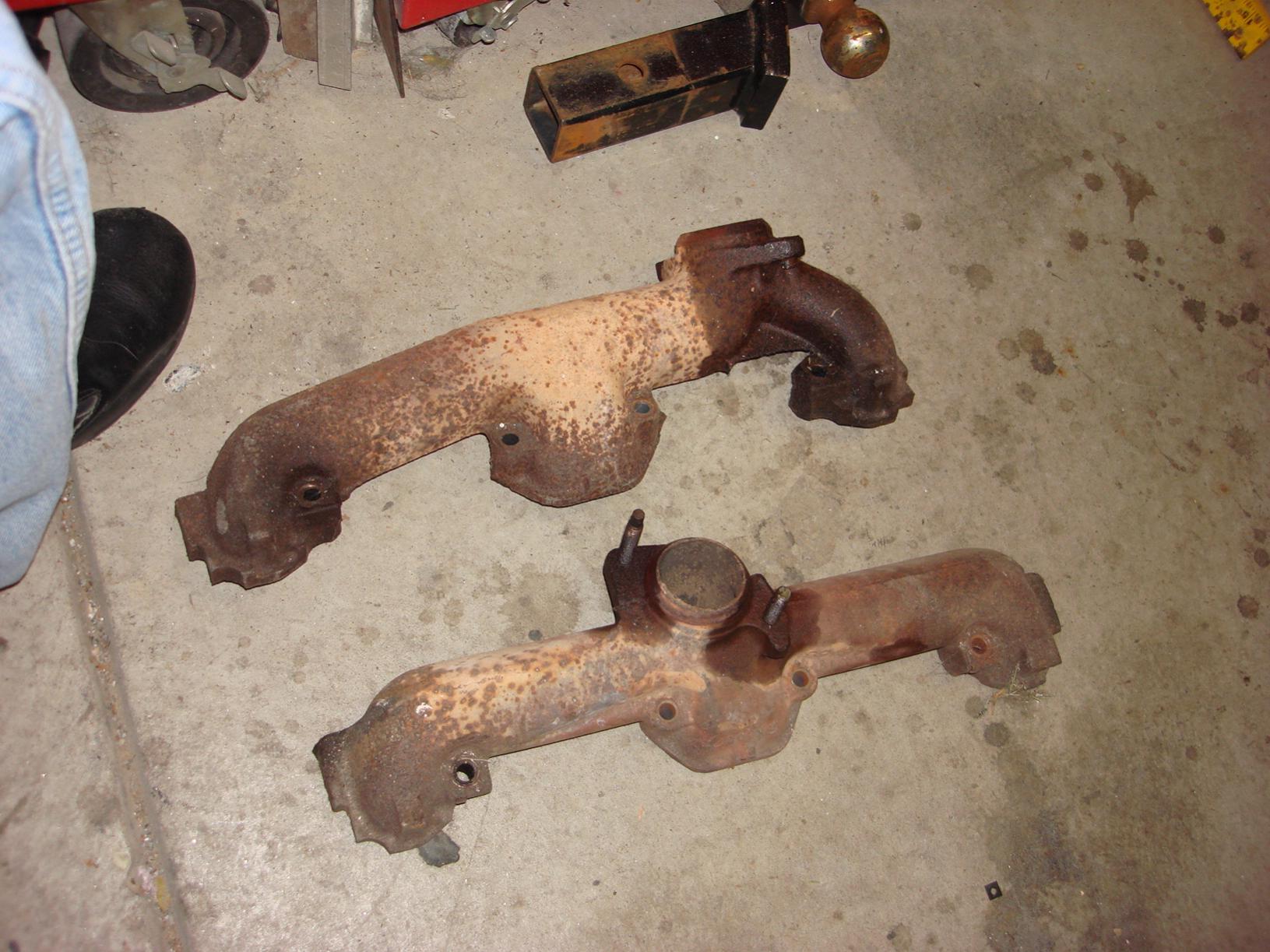

    And lastly, the headers that came with it are cooking the starter, so I found some stock manifolds, and I need to raise the mufflers up cause I drag them coming out of the garage lol

  30. redzula
    Joined: Jul 6, 2011
    Posts: 1,366
    redzula
    Not sure about shocks but the spring rests on the lower because that is the stronger arm from the factory by design. The uppers are not as strong but I don't see why they wouldn't be strong enough for the shocks. Maybe others have a different take.
