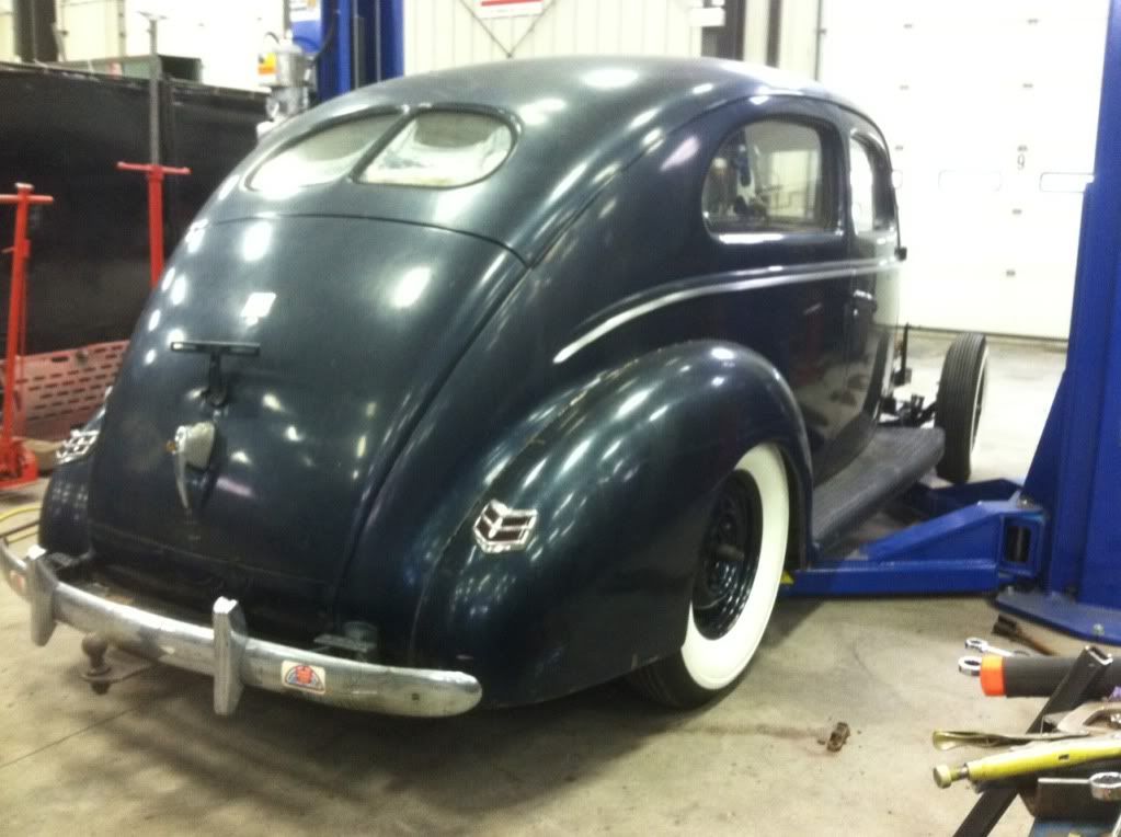

    Well finally getting to putting the sedan back together. Frontend is in, rear is lowered. Steam cleaned the motor for paint. now cleaning the underside from 55 years of sitting in a shop. Got all the new cloth covered wiring to install and should be on the road..

    Cool ride. I love 40 tudor sedans. How did you lower the rear so much?

    Dearched stock spring 2inches and reversed the eyes. its almost too low, did same on 35 3window last summer.

    It looks super solid, even some original paint under the floor!!
    Sits nice to, how close is the rear axle to the frame? I pancaked my rear crossmember 4 inches but my car doesnt sit as low as yours.
