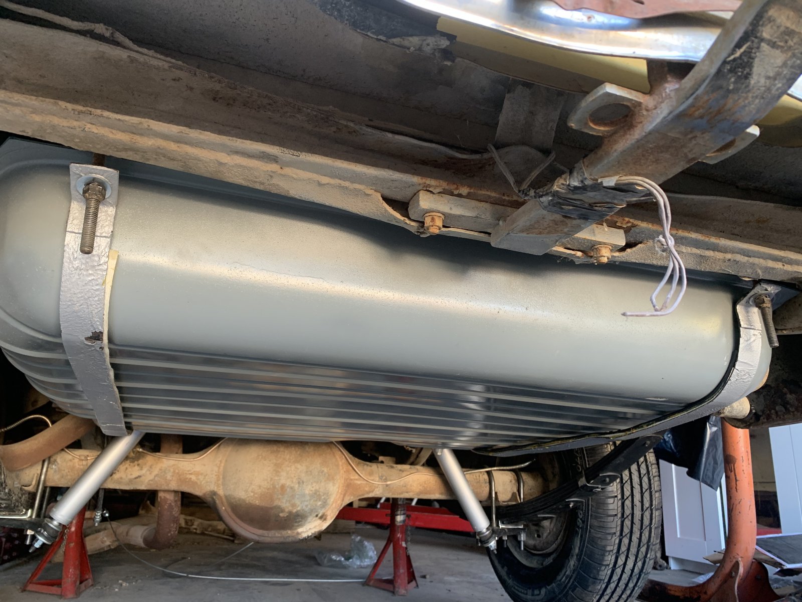

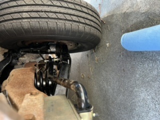

    One wheel down one to go tomorrow and then the front brakes and suspension will be done-minus the sway bar. I put self adjusters on both fronts and eventually the rears as well. Question, I bought a new tank from Auto city cl***ics and it is a bit smaller dimensionallly than my original. Is there supposed to be this much slack in the straps or should they be tight all the way around. At this point I am planning on adding some rubber to take up the slack.

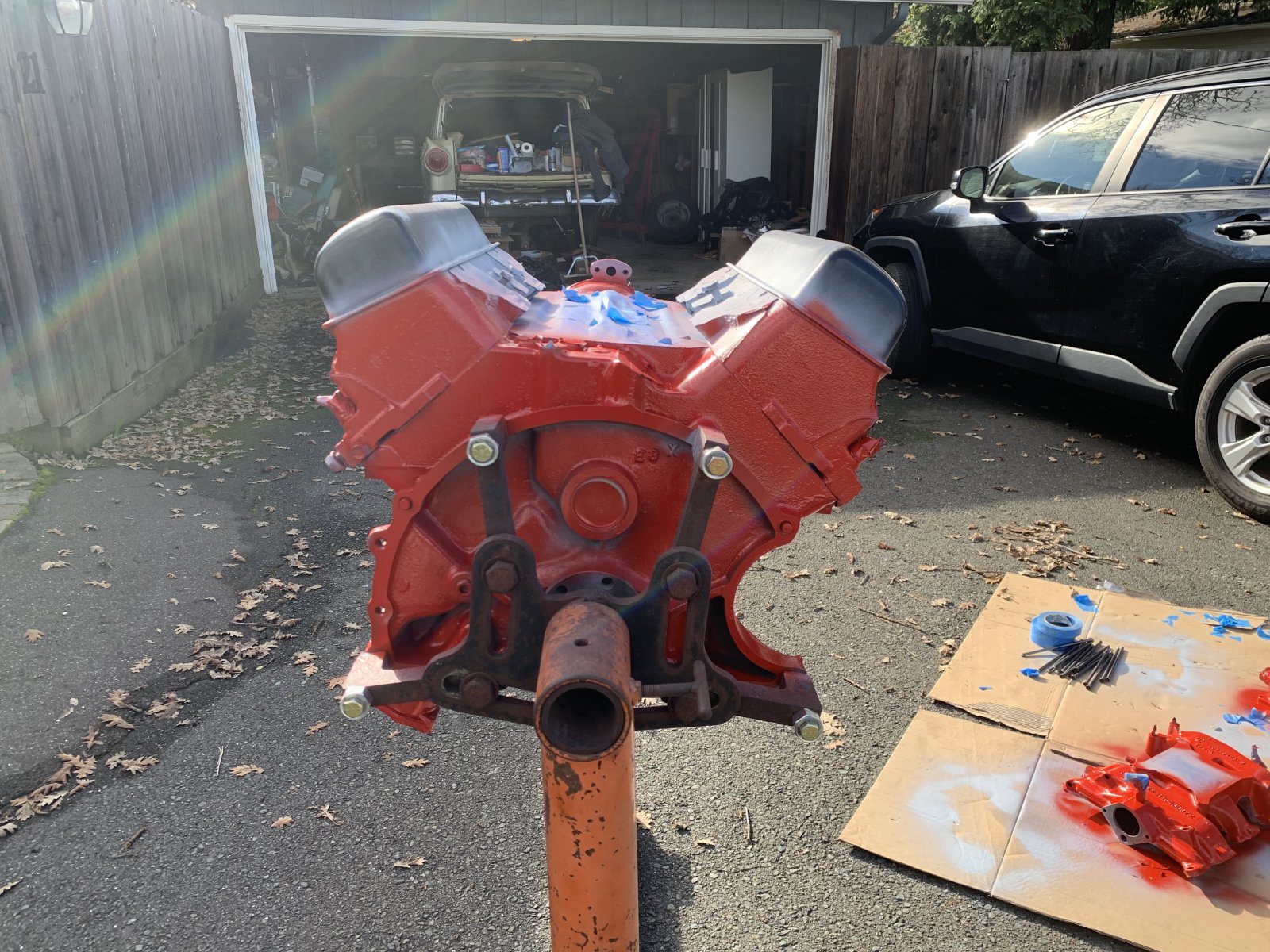

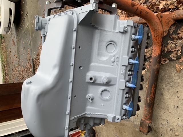

    In preparation to take the block and crank to the builder I tore down the rest of the engine today. Not all that bad actually. The cylinders and pistons were in really pretty good shape, same with the crank. The cam bearings on the other hand were all shot beyond belief.
    Mike

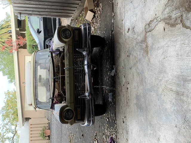

    Finally rolled her out today and hosed out her engine bay. She leans a bit to the left. Still need to add a few things though.
    mike

  9. I have never seen cam bearings roached out - that bad, or at all. What could have done that to those bearings, yet not done worse damage to the crank and all its bearings?
  10. 1930artdeco
    Joined: Oct 25, 2011
    Posts: 786
    1930artdeco
    from Lynden, Wa

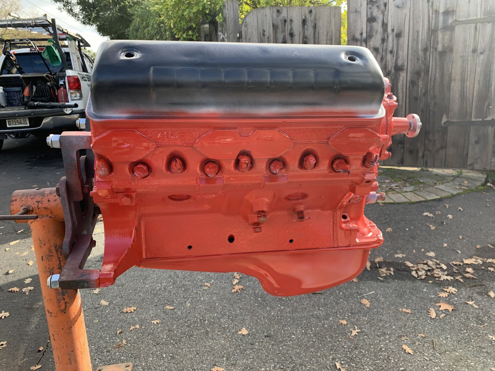

    Oh the other bearings were toast as well. Some of the mains were down to steel shells and it is getting turned hopefully this month or next. I will build it up over the next couple of months and then stuff it. After that all I will have is the rad and drive shaft.

    Ok, so I got the tank hung yesterday. I got her down tight but the new tank is a bit smaller than the original so there is some slop in the middle ….. and I added rubber to fill in the gap.

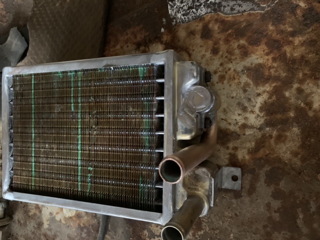

  14. 1930artdeco
    Posts: 786
    1930artdeco
    from Lynden, Wa

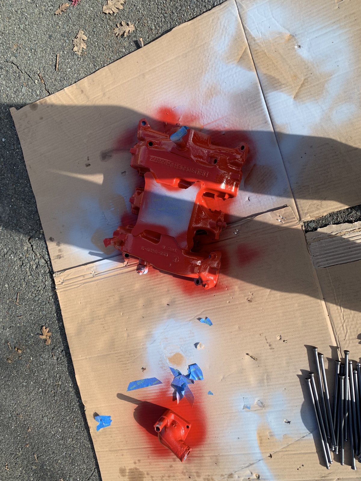

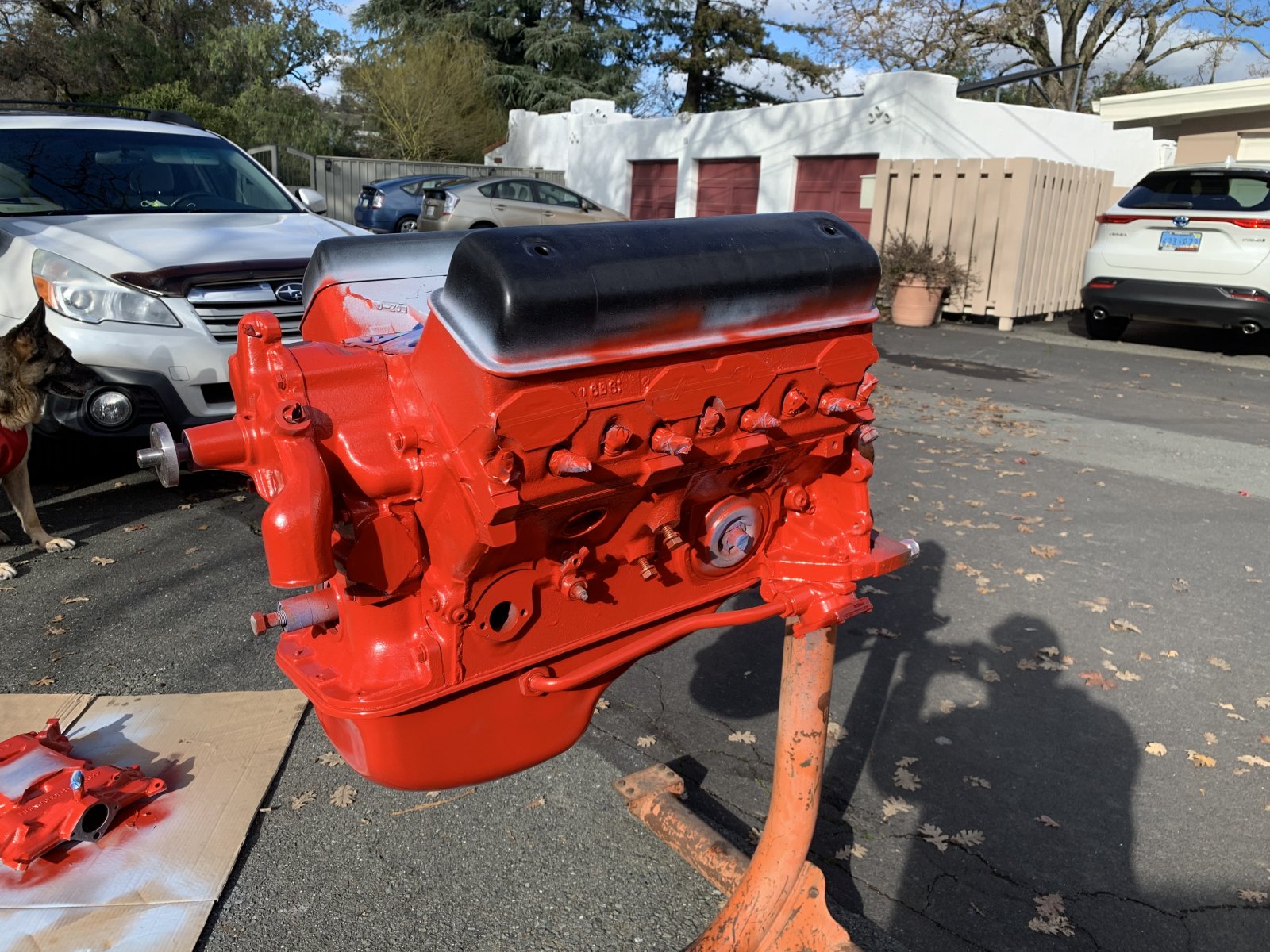

    Got my rebuilt heater core back today. Will have to do some creative pluming of the cable to the valve. Also started to prime the engine and other parts as well. Hoping for paint next week.

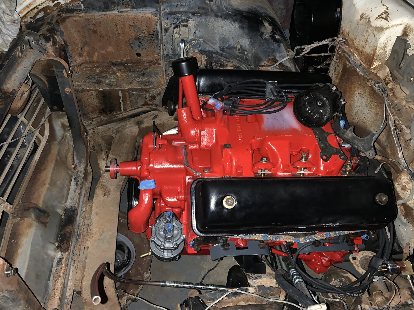

  20. 1930artdeco
    Posts: 786
    1930artdeco
    from Lynden, Wa
    I FINALLY got the engine and ****** in!!!!!!!took us four hours and a lot of new vocabulary words.

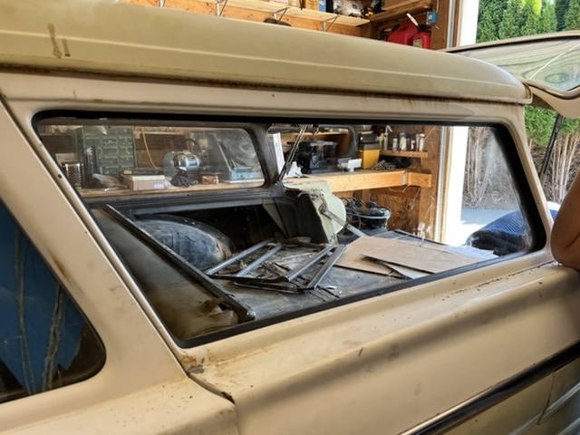

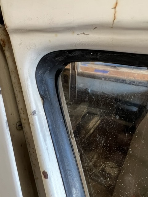

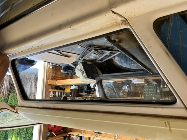

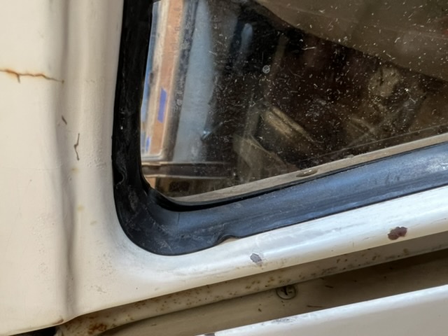

    Finally an update. Got the 1/4 window in on the drivers side. How do I fix corner puckers? It is on the upper forward corner. Have to do the p*** side next. Then onto the windshield and rear gl***.
    ffr1222k likes this.

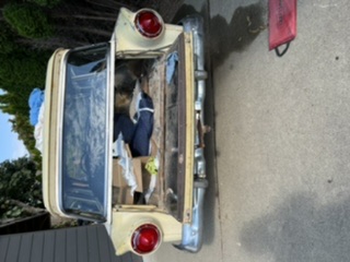

    Update, got both 1/4 windows in and sealed up! I also popped the rear window out and cleaned up. I have a new seal ready for it and the liftgate is actually in great shape with just a few spots of surface rust. Already hit it with evaporust to convert it. Will prime and paint it and then have the gl*** guys come out.

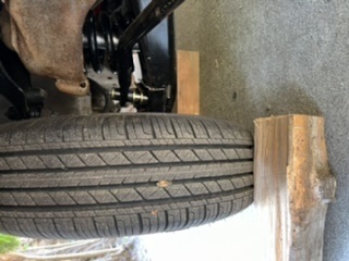

    Now for the next big issue-raising the body to replace the rubber body hockey pucks. Here is what I am thinking:
    1: Get a 2x4/4x4 and sit it along the rocker panels.
    2: Use a floor jack to lift one side up put two stands under it and move to the other side and repeat.
    Is this a good way of doing it? Or is there something that I am missing safety/break the car wise? I am going to cross post this in the 55-59 group as well.

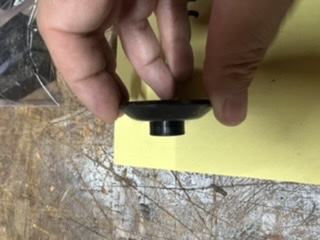

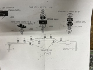

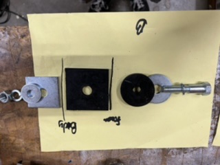

    Hi all, I need serious help here. I ordered a body
    mount kit for my 57 wagon. The instructions are not the best to say the least. So I think I have interpreted the A and B bolts correctly. Can someone verify that I have done this correctly. Also what is the rubber puck with the little top on it? They don’t ID them well and were to put them.
    thanks,
    mike
