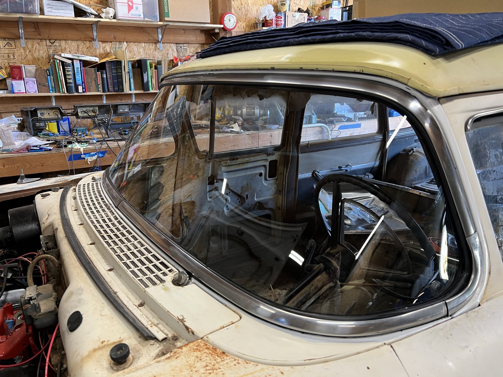

    Good news on the windshield front: trim was saved with no real dents or bends and there is NO RUST!!!!!. Bad news is I lost the windshield getting it out. I put a little too much pressure in one spot and crack…..☹️☹️. So have two questions: 1) should I order online or locally when they install it. And secondly, how do I get those tiny screws out. I have one that was so rusted I had to drill the head off to get the trim off. I can’t get my tiny vice grips on it as there is so little of it left.

    Got her front windshield in. Now I am Back to the wiring project.

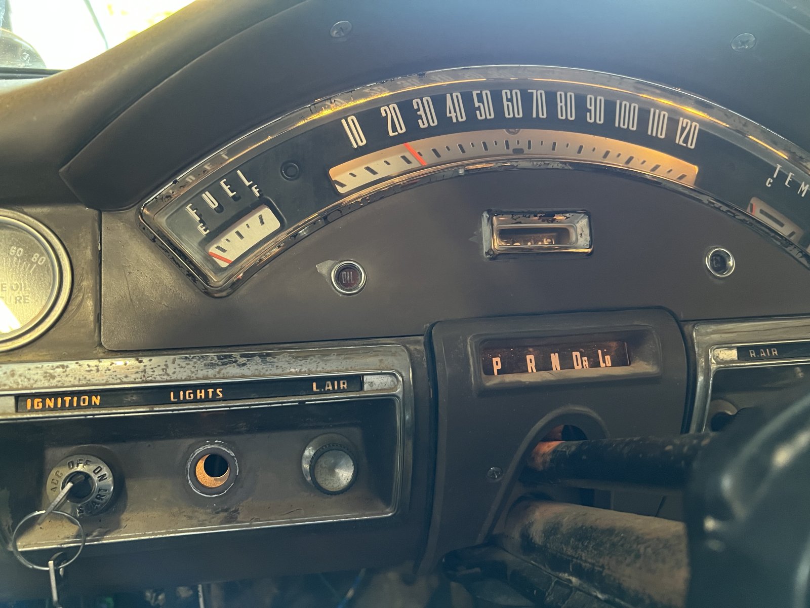

    The gauges had to go back to the shop for some minor tweaking and Rusty at Speedometer service was super helper with walking through things only to find out it needed the tweaking-will recommend him highly in the future for anyone needing service on their speedo.

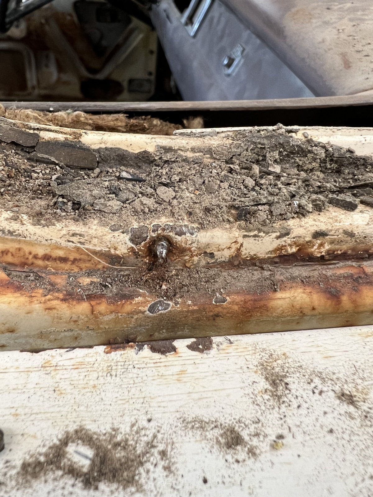

    Update: Well, I have learned a lot about welding, such as a new vocabulary, oh and some new skills at using a welder. I had replace the rear p*** floor pan, the front driver floor pan/toe board (although they have to come back out due to not knowing how they built the body on this car). Also replaced the p***enger toe board when I poked a hole in it. I am currently finishing the p*** rocker this weekend and will start on the p*** floor pan next-after I rebuild the O/D in the Model A. Then the rear p*** floor pan gets replaced.
    I have discovered I am not a body man, this learning on the fly by myself is for the birds. I really would like to take a cl*** but can't due to work. I have learned a bit from Fitzee's You Tube videos but a cl*** would be better. Once the floors are done she goes into the shop for some much needed mechanical fine tuning.
