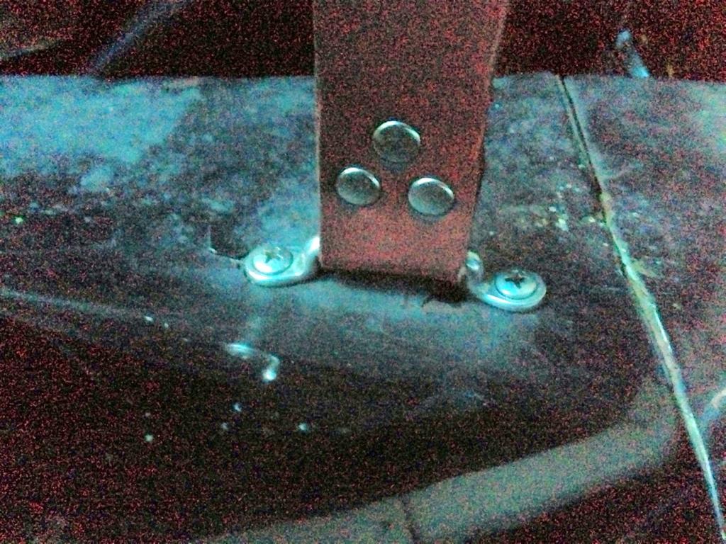

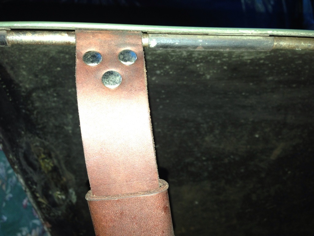

    I found your thread last week. WOW!!!!! Can you post a pic of how you attached your hood straps to the hood itself?

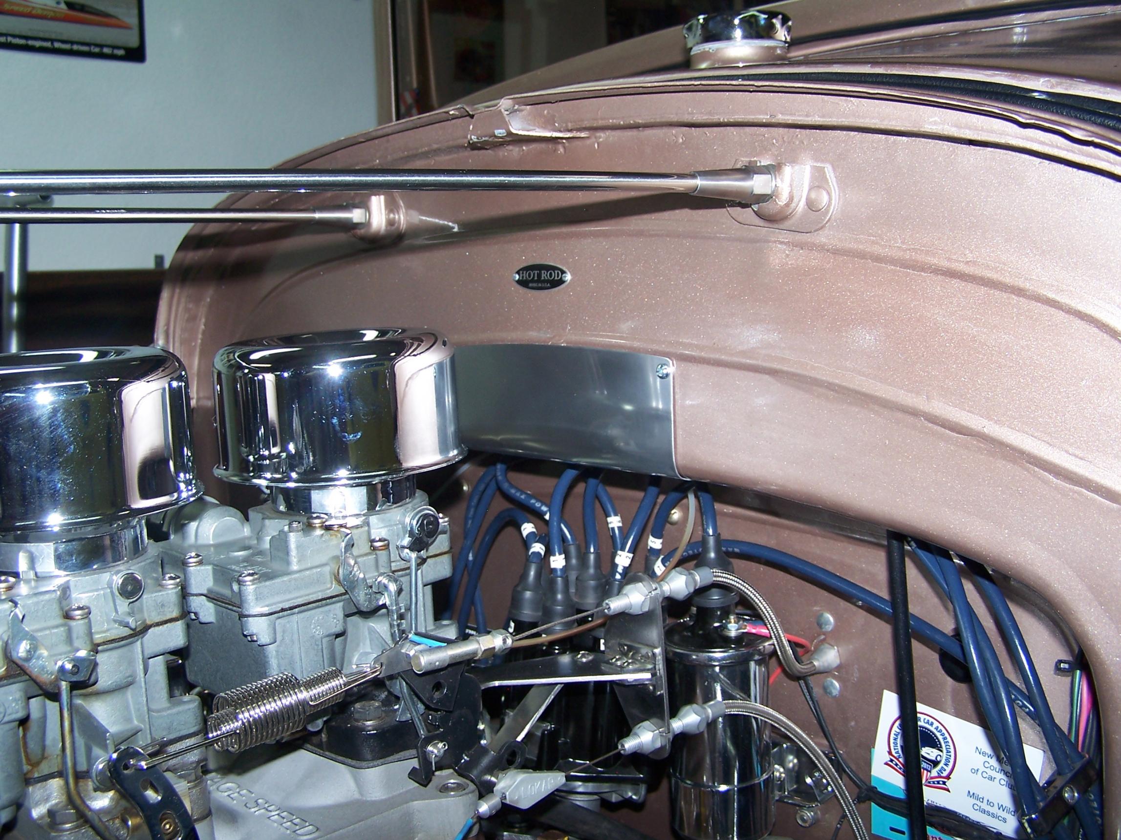

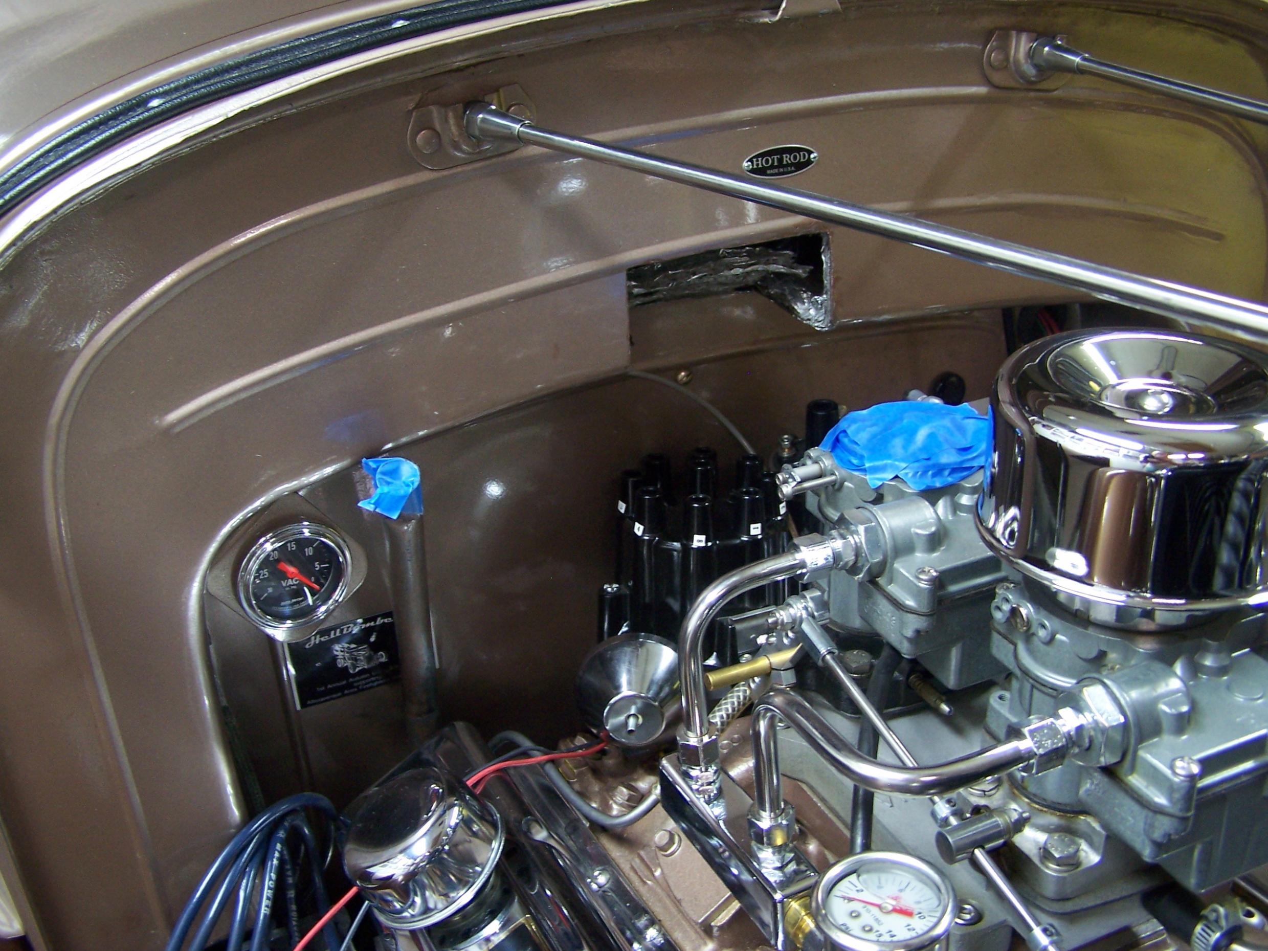

    Glad to see you properly modified the firewall. On my A Tudor I recently installed a Pertronix Ignitor II and had to cut and notch the existing firewall in order to remove the distributor, a difficult task in an already completed hot rod! I knew when I bought it that distributor removal would be a *****!:(

    Sure thing, I will take some pictures today or tomorrow, it was really easy.

    Honestly it was pure luck, it just barely cleared. LOL In order to remove the distributor I have to take the cap off and pull it halfway out then tilt it a quarter turn and pull then tilt. It's like a rubics cube but it comes out with the right combination.

    Here you go shoebox, not the best pictures but you get the idea. Really simple install. Drilled two holes for each lower mount. As for the top buckle, I used the stock hood rods that the of hood sides were hooked on by. Just ran the rod through the top belt loop.
    Hope this helps
