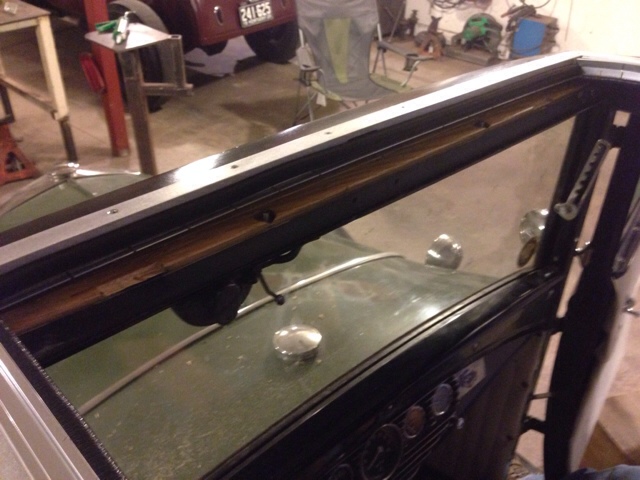

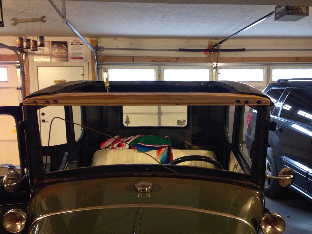

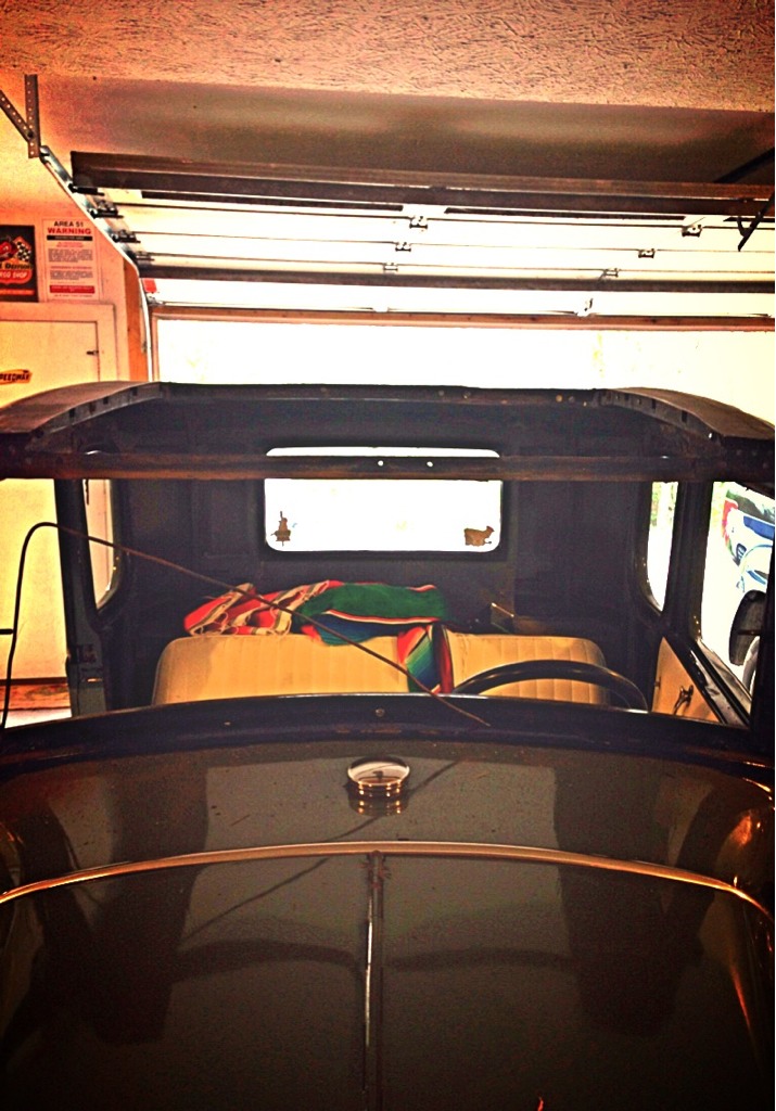

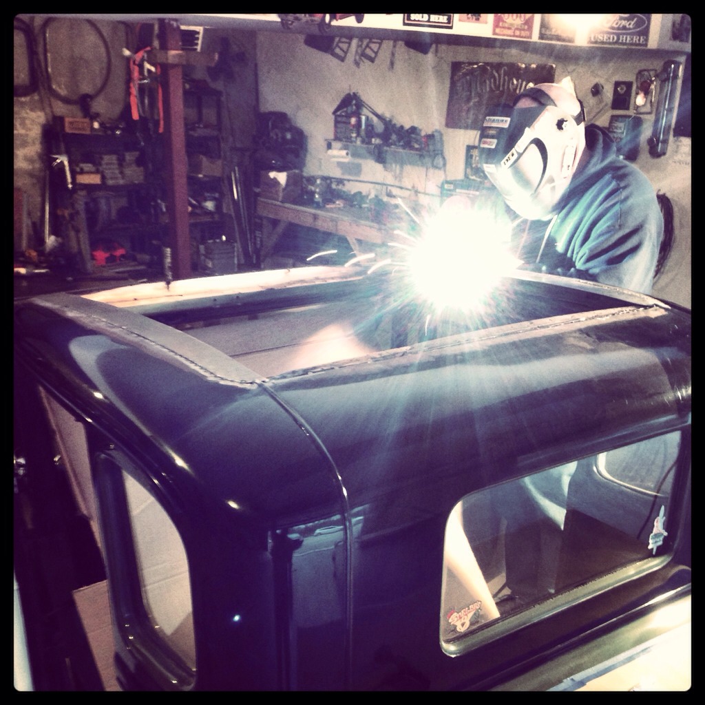

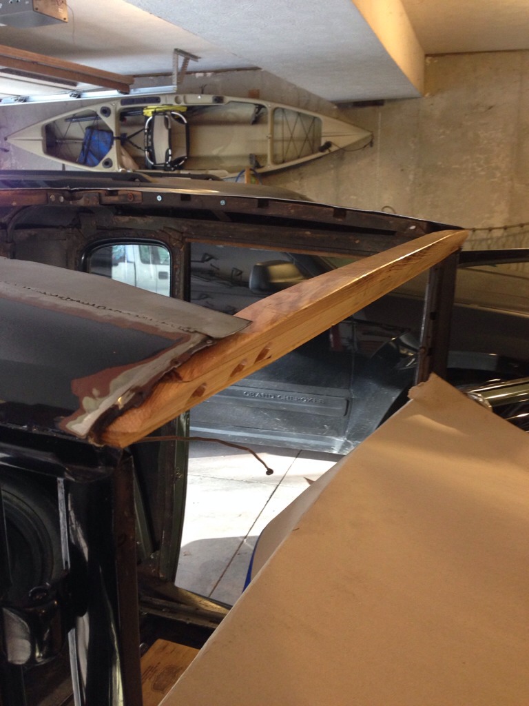

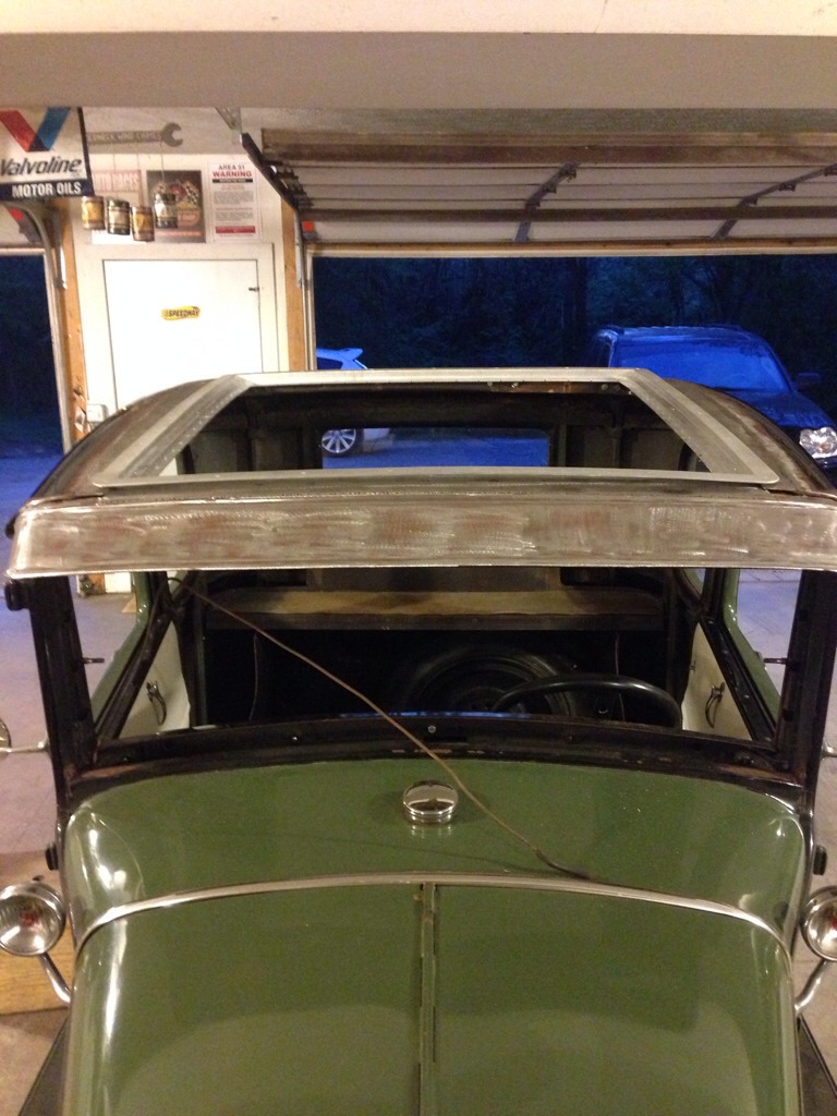

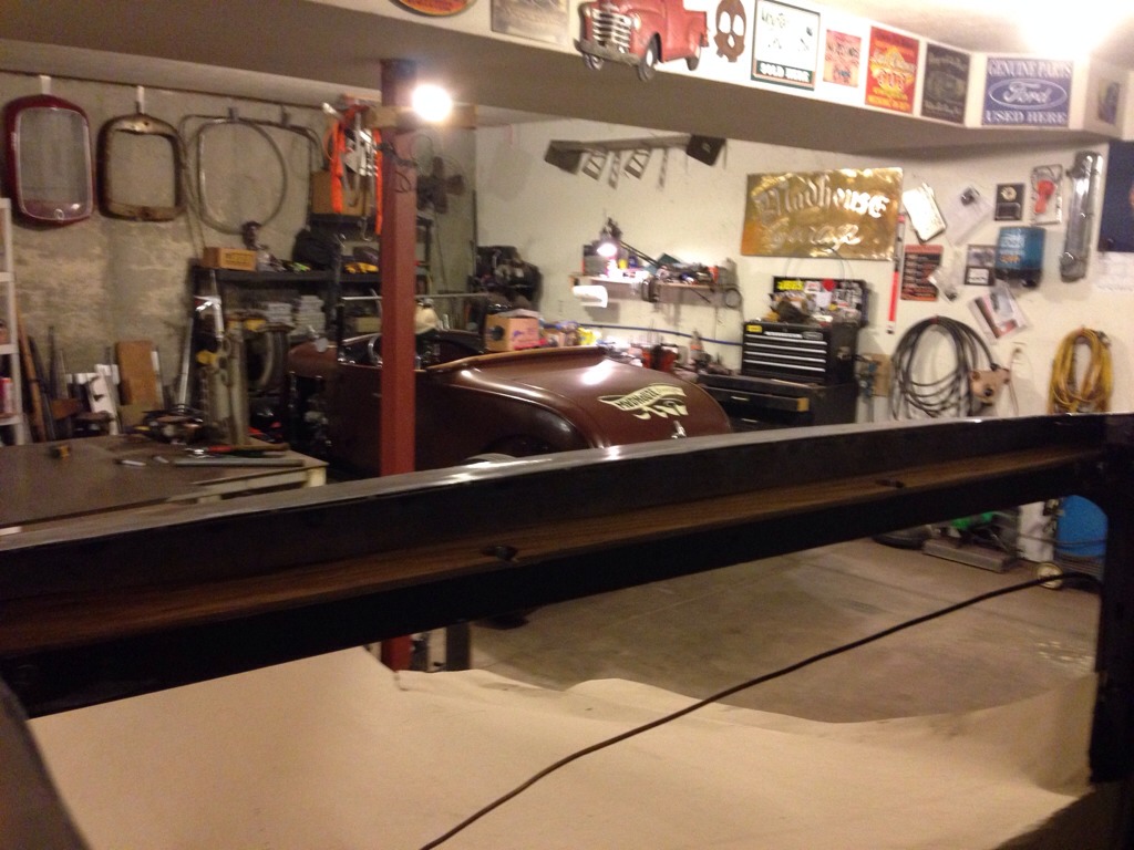

    Been pretty busy lately on the coupe. Started the sliding rag install and it has been a bear. Front wooden header was in really bad shape so I decided to replace that as well. I'm too cheap to buy a new one so we just made one. Things are turning out well, but still have a lot of work to so. I went down to Tennessee for the fall rod run without a top and added a few pics of that as well.
    Stay tuned for more updates

    Make sure you watch the with of the top frame whys you bolt it Down it tends to pull in on the sides when you bolt it down from front to back. I cut a couple wood blocks to put in the center and keep it in line then bolted it down starting in the middle and working to the front and back. I also had to flatten out the front header of the top to get it to sit flush when the top was closed

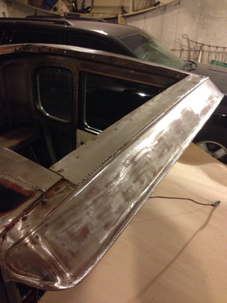

    Got the visor all welded up. Things are starting to move along

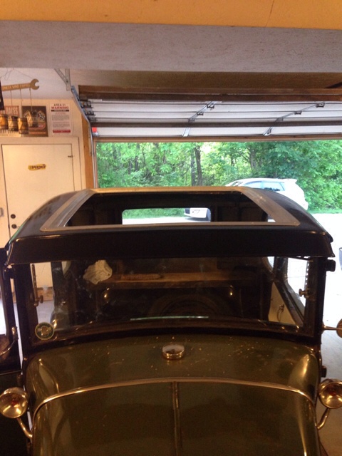

    Getting closer, got the roof in primer and test fitted the frame one more time. Things are looking good. Even got my girlfriend helping along with Mikes29 who has been a huge part of this build.

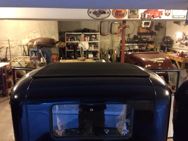

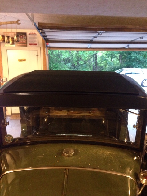

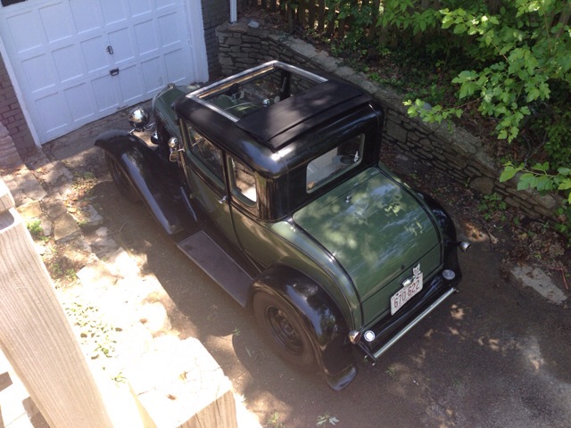

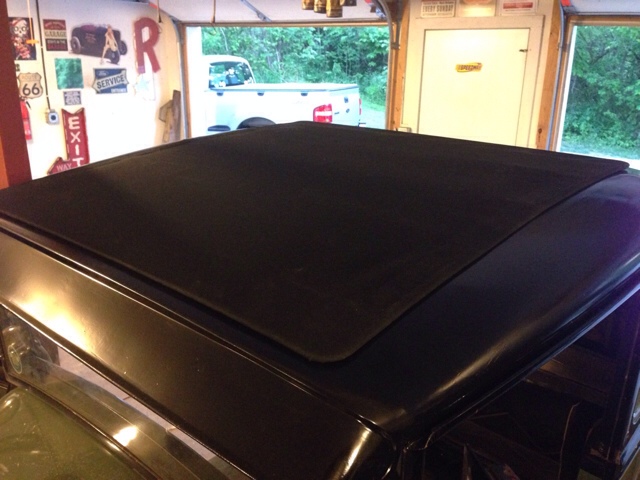

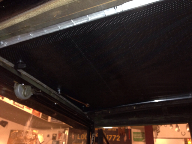

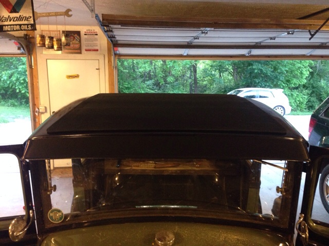

    Big update. I'm about 98% finished. I need to modify the handle a little bit and do some finish work on the headliner. I so those things after the roof is painted when I have more time.
    ImageUploadedByH.A.M.B.1400692108.181159.jpg ImageUploadedByH.A.M.B.1400692123.446916.jpg

    Just a few recent shots
