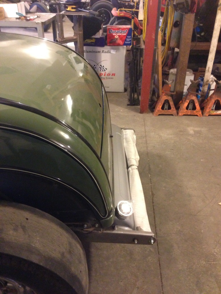

    A productive weekend with Mikes29. We almost have everything mocked up. Just need to finish the radiator, finish the 32 tank mock up and tear everything back off to finish welding everything and finish the firewall. Then on to painting the ch***is.

    Another weekend at it with mikes29. Tank mocked up and tacked. Front end done. Interior gutted, floor mocked up. Next up, mock up the rest of the steering and tear it all down.
    And a little sleek peek of what's to come.

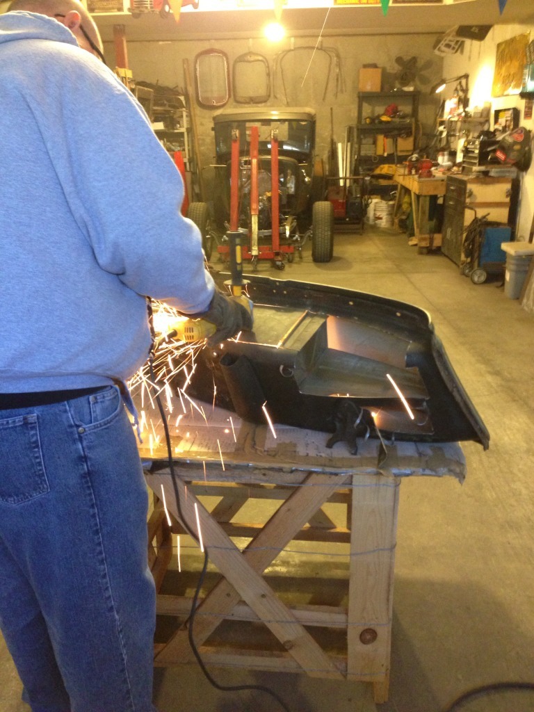

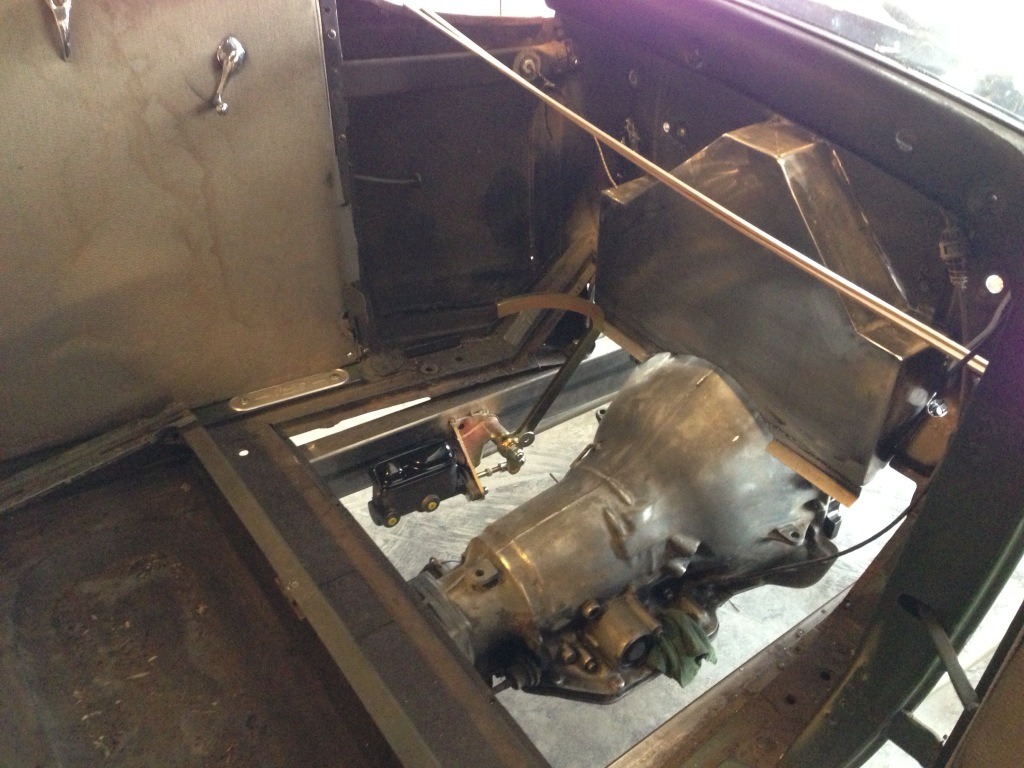

    The recess in the firewall looks good!!!;) I won't comment on that big *** hole for the AC...

    Haha My wife wishes it was for AC. It's the hole cut for a patch panels. There were several cracks in the firewall where the hood rod bracket was. We decided to just cut the section out and patch it. Once we pull the motor back out then the holes will all be filled in, smoothed out and painted.

    She is finally mocked up as the gas tank has been cut. Finished the steering and started test fitting he seat. Next up, complete tear down so Mikes29 can finish welding the ch***is and the firewall. After that then it's time to paint the ch***is, firewall and begin final ***embly!

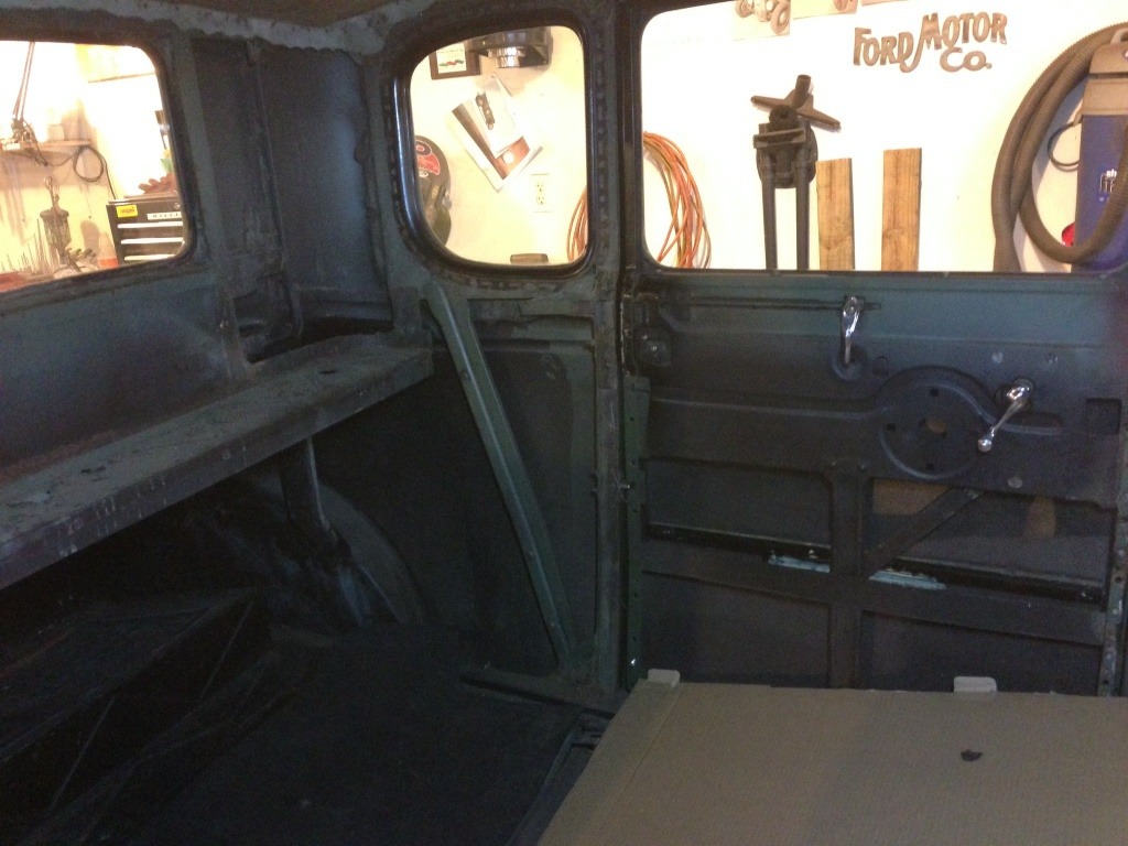

    Mike is you seat sitting directly onto the stock seat riser?

    Hey Joe, the seat is just sitting on 2 2x4's that are resting on the riser. Still need to fab up mounting brackets. The seat will fold down to give access to the trunk area and then flip up to access the storage under the seat. The plan is for black tuck n roll on the seat.

    I used a caravan seat as well. It is sitting directly on the stock riser with the exception of a piece of 1 inch square tubing along the front edge to kick the seat back a tad for some angle.
    It also served as a mounting point for hinges so I can tilt the whole seat up and forward to access the storage area.
    Its lined up even with the front of the riser as well. I had to trim a bout two inches out of the package tray.
    Im 6' with all the leg room I could hope for
