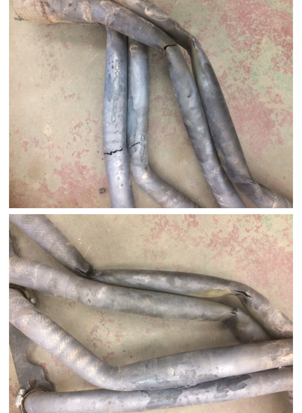

  13. I killed a set of full length headers on a break in. We backed it out of the shop, burped the radiator and headed out.
    We drove it from Jasper Al to Charlotte NC.
    No transmission cover. Could see the collectors glowing. Those things glowed orange to almost Atlanta.
    killed the short gl*** packs as well. Loud!!!
    Th400/410 gears.
    Was stuffing TP in my ears.
    Good times

  20. Timing set with both a light and vacuum gauge.
    But we did wrap the headers. Thought it looked cool. I’d imagine that helped with holding the heat on a break in.
    They stopped glowing on their own.
    I guess header wrap and hammering a fresh engine doesn’t do well
