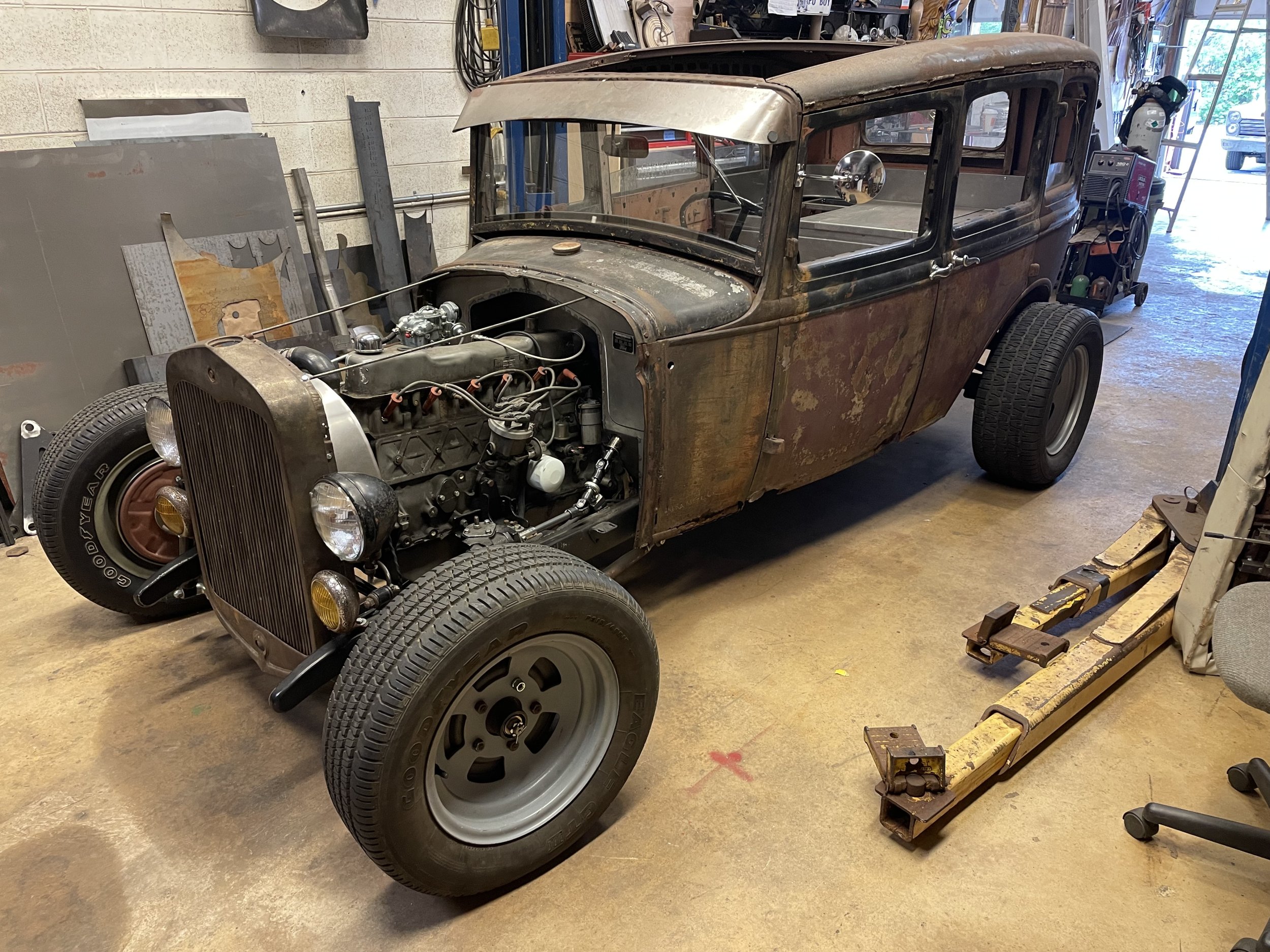

    Finally ready for DMV. My first ground up build, pretty excited to cruise it.
    Delaware requires an inspection for street rod tag, so wiper, seatbelts, horn, muffler, yadda yadda yadda. All the things that never entered my mind while building

    Do I see a 240/300 Ford? Be still my beating heart. Excellent choice. Be ready to shock some V8s!
    FWIW, My avatar champ car uses a 300 Ford six - with a crossflow cylinder head.

    Like how you recessed your firewall for the six…congrats and good luck!

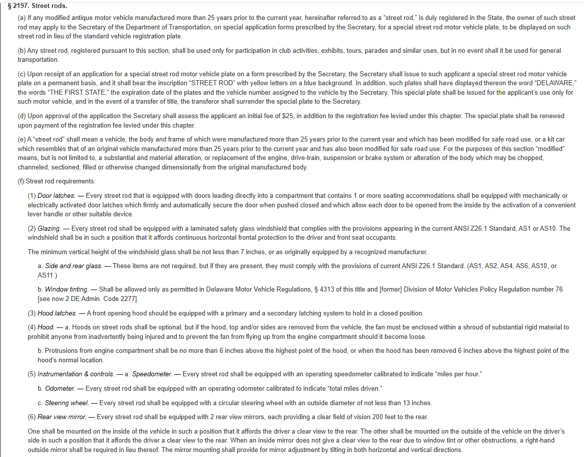

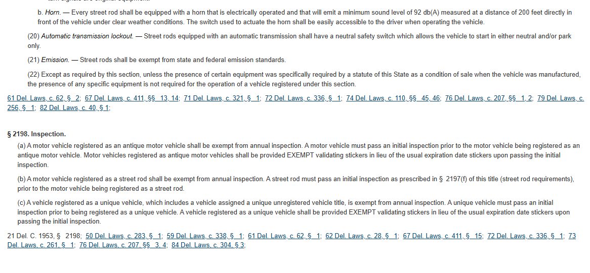

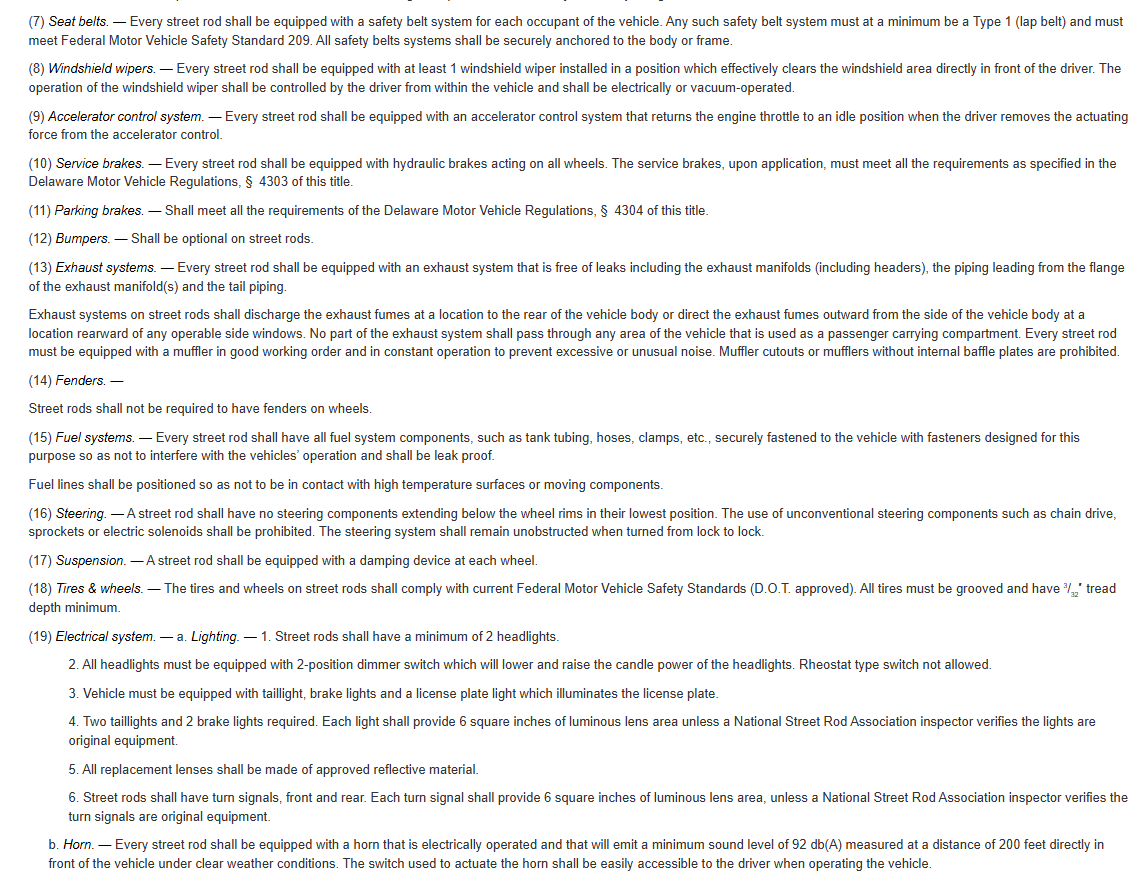

    You actually spent all this time building a car for the street and never one ******** time checked your states RCW's for what required equipment you had to have?
    Most are just common sense items although a couple of things such as exhaust routing don't go along with current popular in some circles setups. = No megaphone headers with muffler inserts in Delaware as it has to exit past the rear most window and that means out the back on that car. https://delcode.delaware.gov/***le21/c021/sc07/index.html

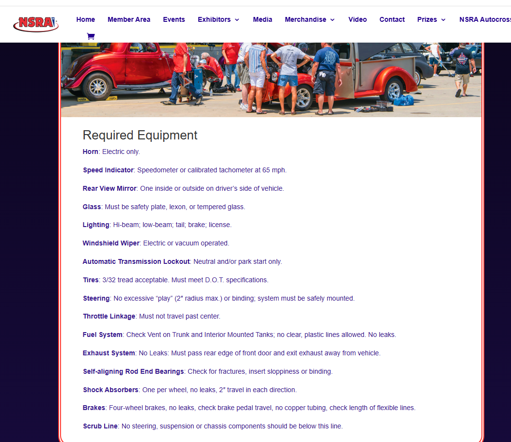

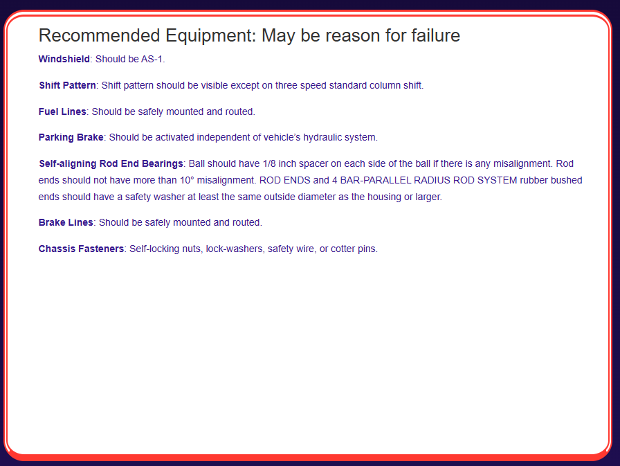

    Actually I can't understand why you didn't have it printed out and on the garage wall to check off on as you completed each thing even though I'd hope that you already have 75% of them just to have a safe to drive car.
    For years many of us have had the NSRA all 23 or their required safety inspection items on our shop walls as a reference I didn't find the all 23 list just the required list with a quick search.
    I'll say This though, If one's rod meets the Deleware street criteria it should p*** inspection in just about any state in the country without a h***le. A couple of things will get some guys undies in a knot such as the height restriction on engine parts but if you have ever met a guy on the road who's forward vision is fully blocked off to the right by a tunnel ram or blower you quickly understand that. Screenshot (1215).png Screenshot (1216).png Screenshot (1217).png Screenshot (1226).png Screenshot (1234).png

    Yup! It's a 300ci from a generator that ran a welder

    Ford 4.9L, thing runs like a champ i love it haha
