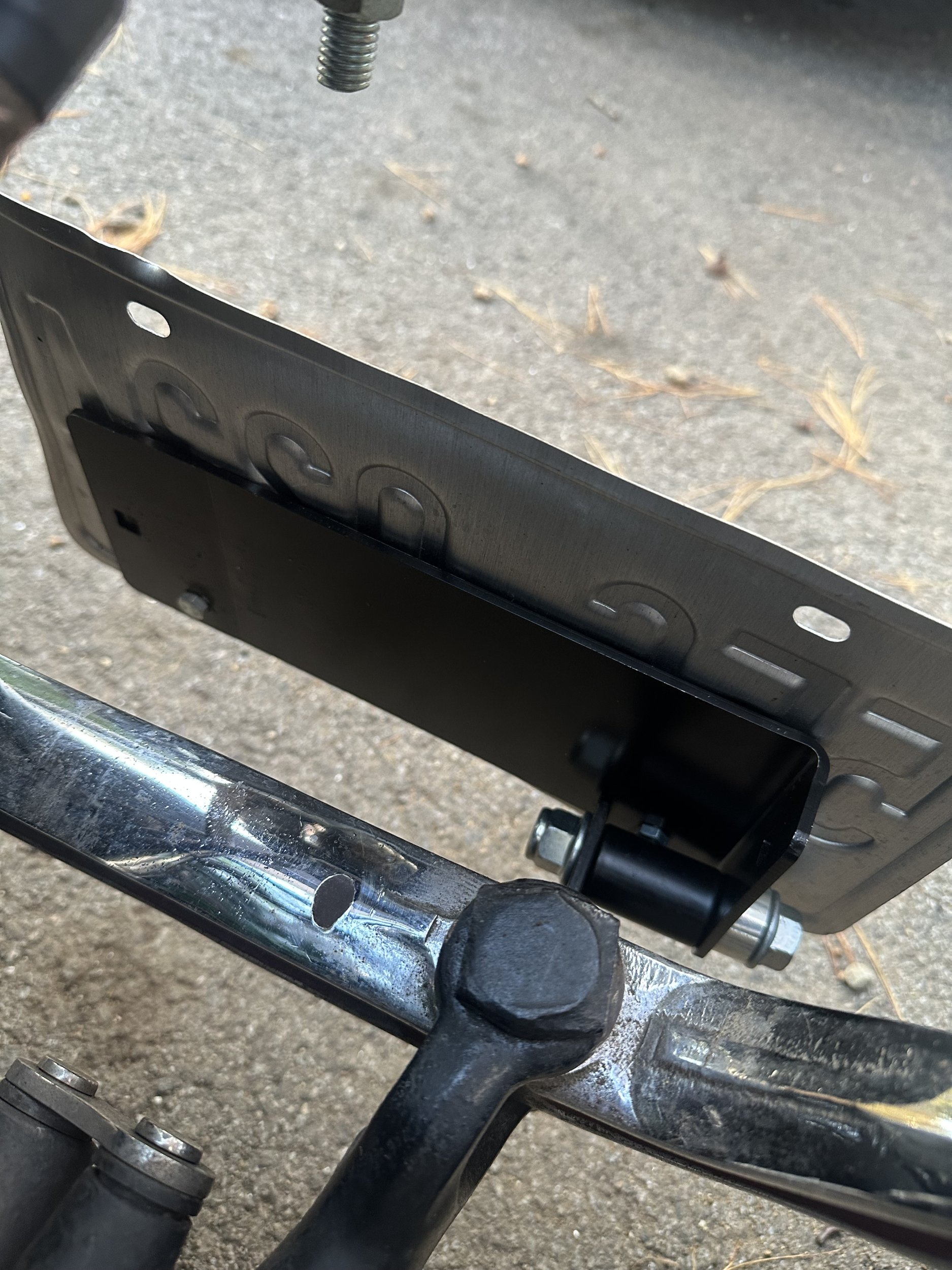

    Used some s**** from work to make a license plate bracket. It’s much better than the tie wraps that I had going around my front axle. Sometimes it’s the little things in life that make a difference. Lol. IMG_0003.jpeg IMG_0002.jpeg IMG_0001.jpeg

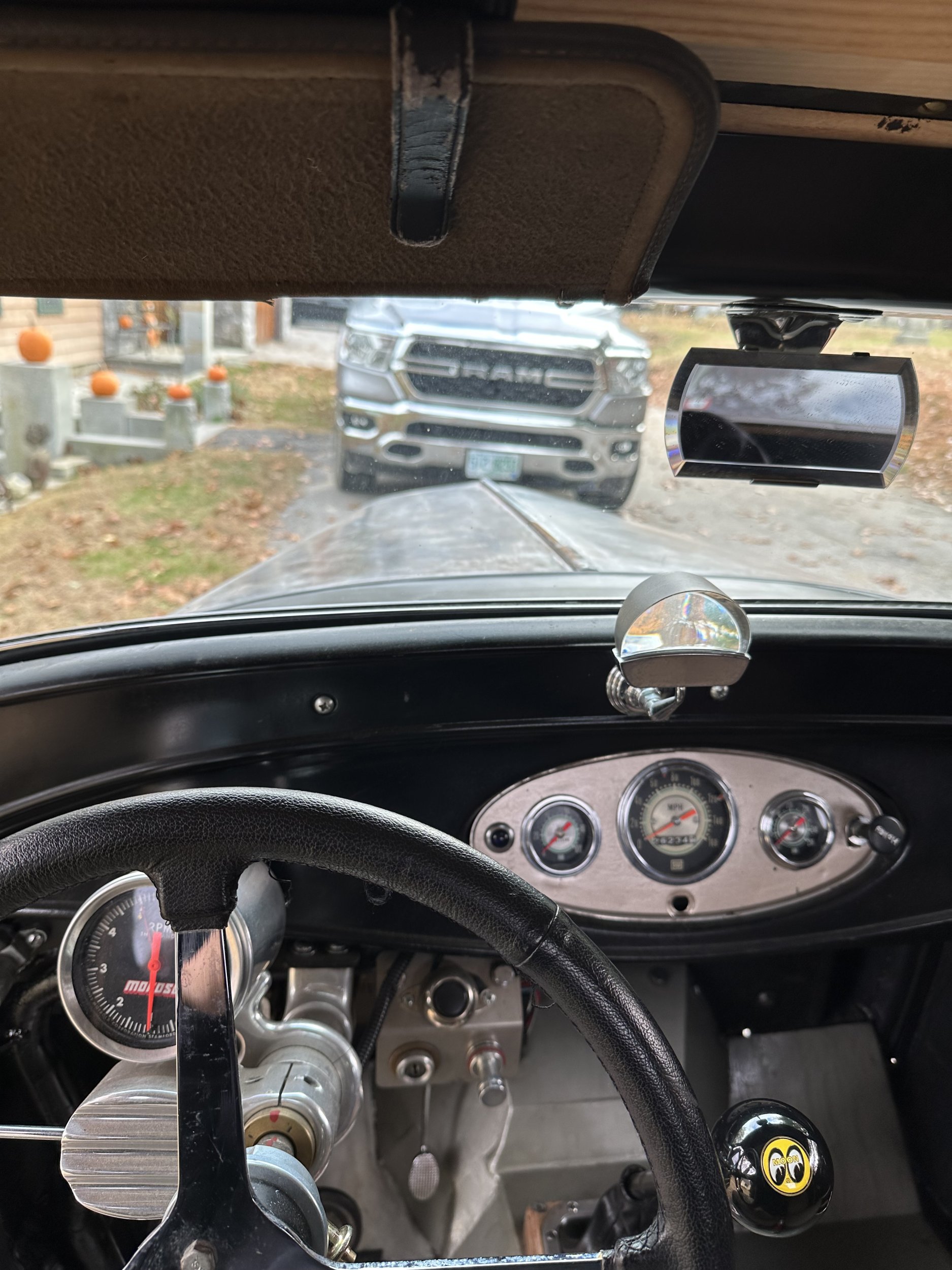

    Took the side off my hood today and stripped off all of the paint. Ready for louvers. I really like the look, especially from the drivers seat. I can’t see the engine from the driver’s seat like I could in my 29 Sedan. That one was channeled way more and the frame put the engine positioned way higher. Here’s a couple pictures showing the difference. Plus my 29 had a suicide from axle so I could see the front wheels too which was pretty cool. IMG_0651.jpeg IMG_0005.jpeg

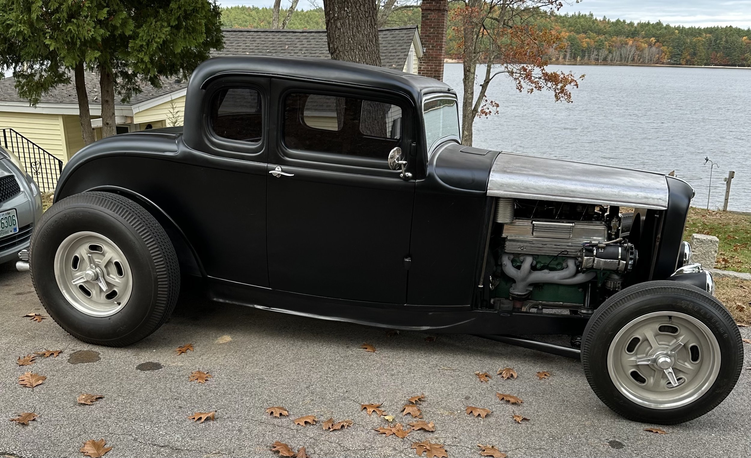

    IMG_0006.jpeg IMG_0007.jpeg Here is a shot from the side. I’m wondering what the best way to hold the hood down on the sides. I have a couple of ideas but looking for some input.

    Dropped my hood off today to get the louvers. They’ll be done by next Sunday. I’m excited about seeing them and installing the hood. I’m still trying to figure out the best way to hold it down. If anyone has any suggestions please let me know. Thanks.

    My favorite way to hold a factory hood top down is making a spring loaded deadbolt fit inside the roll where the hood side hing rod goes. Make a little catch on/in the fire wall and grill shell and it’s all but invisible. Seen in here on the hamb a time or two

    Great minds Tim.;) I did the same thing on my hood, off that particular thread....works great.
