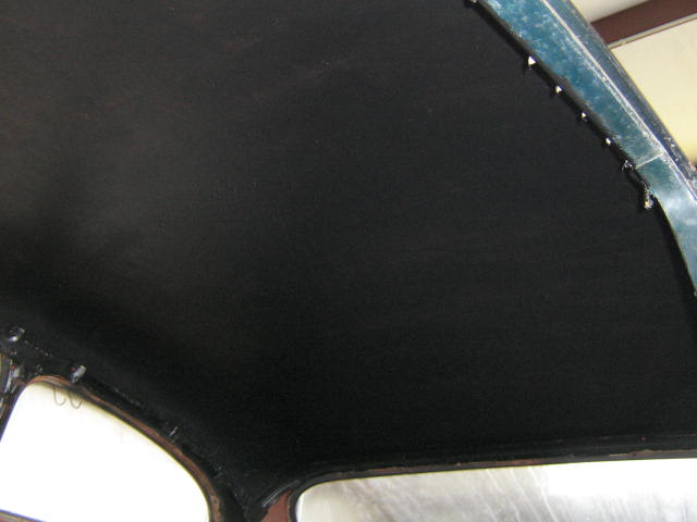

    Finished cleaning, priming, and painting the inside of the roof. Installed the sound deadening/insulation material. The interior is completely covered with the subs***ute dynamat material.

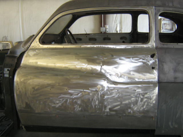

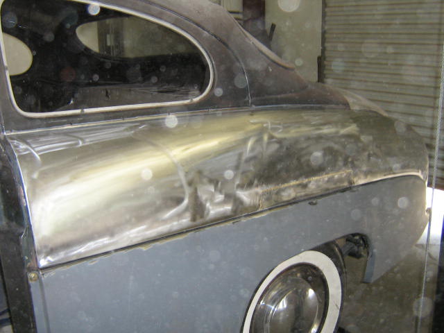

  11. enfieldjoe
    Joined: Jun 5, 2009
    Posts: 839
    enfieldjoe
    from Eustis, FL

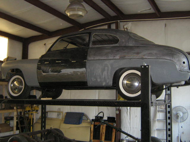

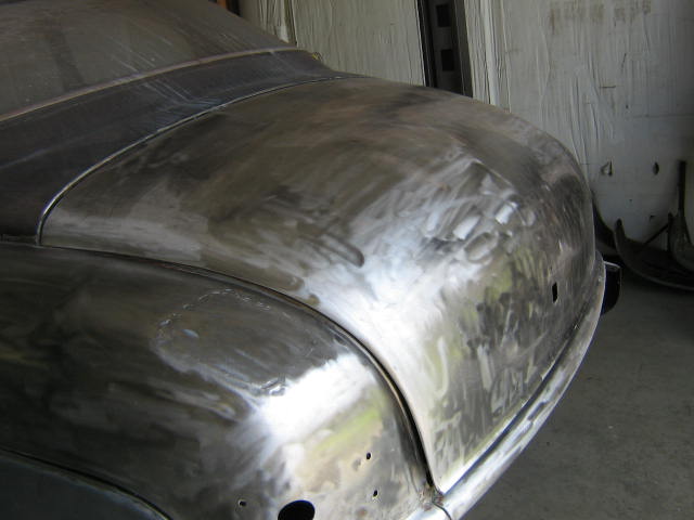

    Started stripping the green paint off the body today. Lots of primer and paint on this car. The sheet metal underneath looks very nice. Only some minor prior body repair work had been done on the left, upper, rear quarter panel. Ran out of stripper disks, so I did not finish stripping the roof.
    Any panel painted grey had already been taken down to bare metal and expoxy primed.

    Thanks Wes (Leadsled612). I also used contact cement on the Peel & Seal for the roof. Did not want that stuff falling down after the headliner was installed.

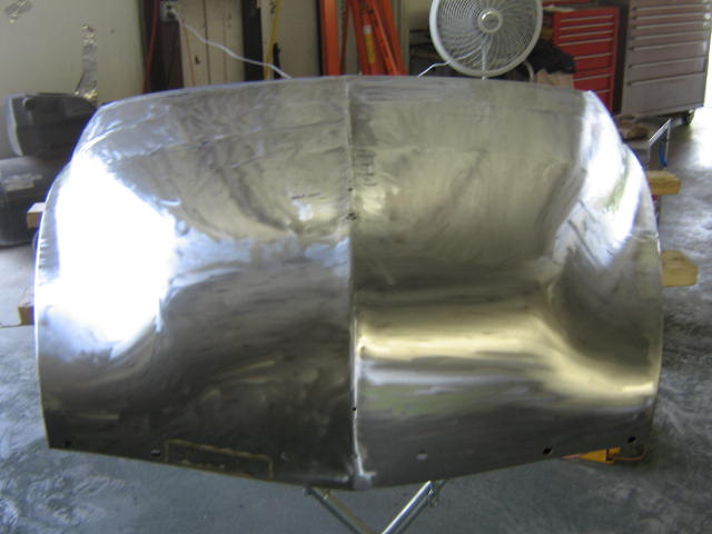

    Still stripping paint. Spent a couple of hours this morning on the hood. I really enjoy looking at 62 year old sheet metal. Aside from a prior minor repair on the very front lower lip, the sheet metal is pristine!

  22. enfieldjoe
    Joined: Jun 5, 2009
    Posts: 839
    enfieldjoe
    from Eustis, FL

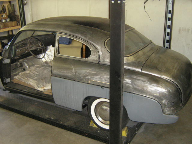

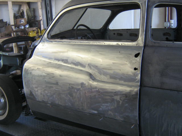

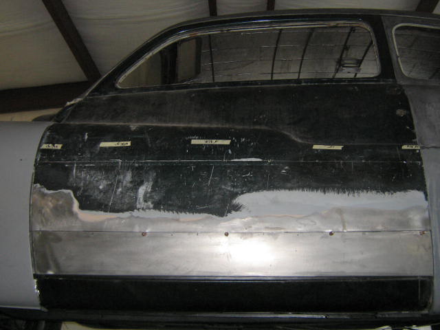

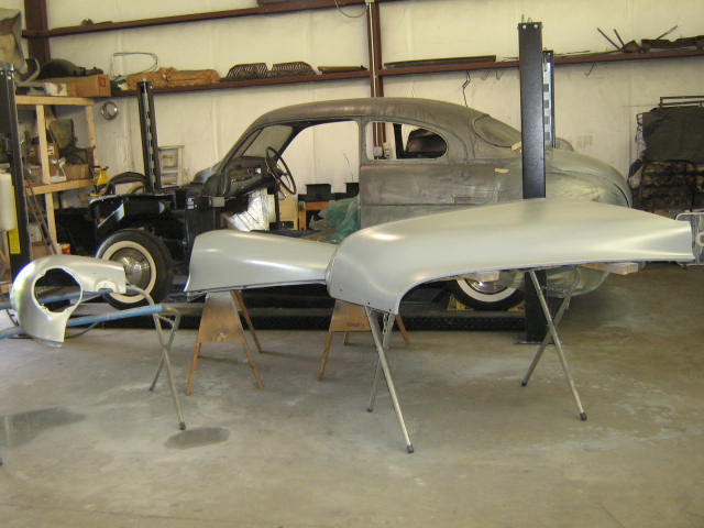

    Installed the patch panels on the doors. Then mounted the doors for a fit check with the door gaps, front fender, outer rocker panel, and quarter panel before final welding the door patch panels. Stripped the paint off the doors also. Getting closer to shooting the whole car in epoxy primer.
    The patch panels that Slddnmatt made for the door bottoms and bottom of the door skin fit nice.

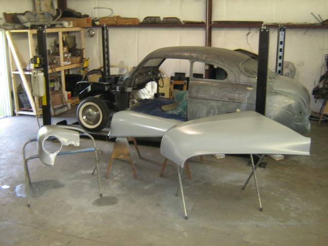

  23. enfieldjoe
    Joined: Jun 5, 2009
    Posts: 839
    enfieldjoe
    from Eustis, FL

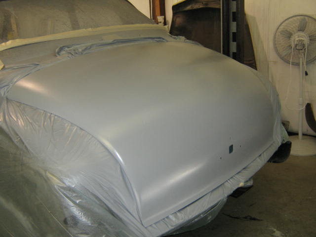

    Shot some epoxy primer on the front fenders, hood, and deck lid today with my new HVLP 3 Stage turbine paint system. Wanted to try a true HVLP because even a 3 stage DeVillbiss filter system on my compressor could not always deliver dry air. Lots of humidity down here.
    Got the idea from a thread on the HAMB. Lots of tech on which system to buy and how to use it. Works great with primer. High Build Primer will be the next material I try to shoot.

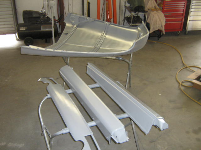

  25. enfieldjoe
    Joined: Jun 5, 2009
    Posts: 839
    enfieldjoe
    from Eustis, FL

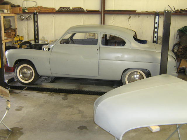

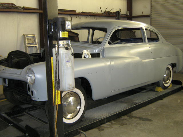

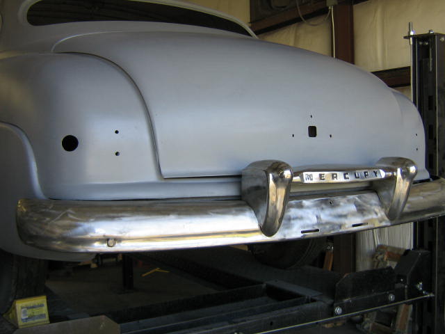

    Another major milestone met on the Merc today. Removed the windshield & rear window. Prepped the openings for primer. Media blasted the underside of the hood. Shot some expoxy primer on the body, hood, rockers, and rear valance. Now the entire body is in epoxy primer. Next step is to put it back together and do some minor body work on the left rear quarter panel before the high build primer.
  26. enfieldjoe
    Joined: Jun 5, 2009
    Posts: 839
    enfieldjoe
    from Eustis, FL

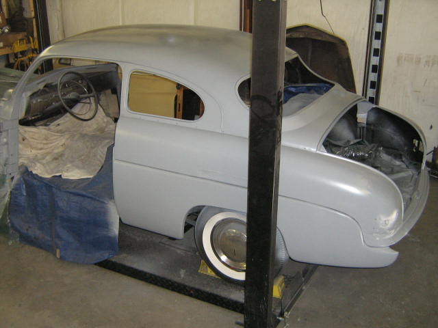

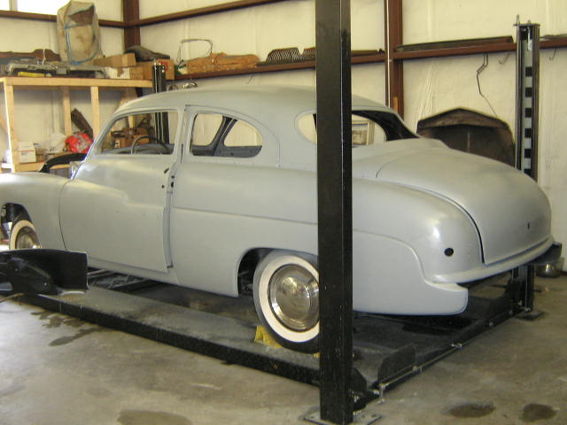

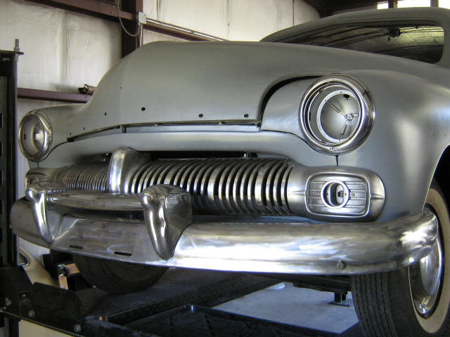

    ALL the bodywork is now finished. Nice gaps at the right places. Entire body now has several coats of AutoKote epoxy primer.
    The HARD WORK is now complete. Rebulding the front & rear suspension, fitting an OHV engine and automatic transmission is easy compared to all the sheet metal fabrication, fitting body panels, and shooting epoxy primer.
    Decided to sell the Merc at this stage, so I can focus on my Chopped 51 Merc that has been patiently waiting in the corner.

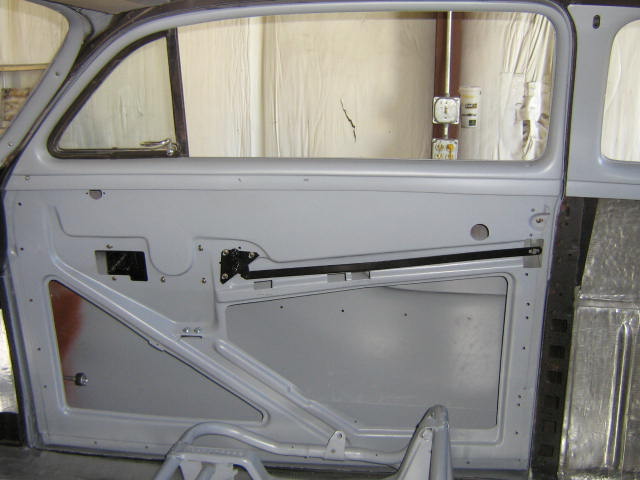

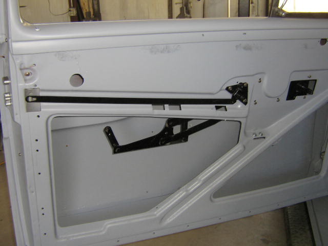

  27. enfieldjoe
    Joined: Jun 5, 2009
    Posts: 839
    enfieldjoe
    from Eustis, FL
    Finished installing the window regulator, door latches, and ***ociated hardware today. All interior window garnish mouldings have also been installed.
    The only task left is to decide where to go from here with this project. Making an effort to sell in this condition, but no reasonable offers at this time.
