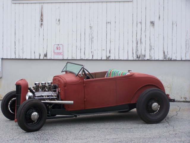

    Well I suppose these are never done, but it is done enough for me... finally bolted in the 32 tank and had to take it for a drive... got in such a hurry I some where forgot to put the cap on after filling it... but I am super happy to have it done.
    I took it out early today for the maiden voyage and I had forgotten just how much fun roadsters are to drive...
    A few little bugs to work out and it should be set, I am really glad my buddies talked me into the Muncie and SBC combo, I am loving the 3 pedals.
    Funny how its hard to get perspective until their out of the confines of shop space...

    did you pinch the frame at all?

    Jimmy2bottle,
    I did pinch it, in a couple of places. . . I like to try to get the reveal as tight at I can along the body line... on this one, if I remember it was in 3 places. I have lately been admiring the stuff the guys at http://www.rollingboneshotrodshop.com/Projects.htm build. Personally I think they build some of the neatest stuff around, I did my best to emulate the stance of the frame they put together.

    looks great! stupid question from a guy that knows nothing about working on frames...what exactly do you mean by pinching the frame?

    Pinching the frame just means "bending it". You can do this pretty much out of anything metal. You take a small cut (if a bigger pinch a very narrow pie slice out) and then bend the metal so the 2 pieces touch again, and weld them back up.
    Lot's of times with 32 rails which already have some curve in them if you line them up with the body of the car they won't follow the contour of the body line so they just need some pinching to make it work a little better for the eye.
