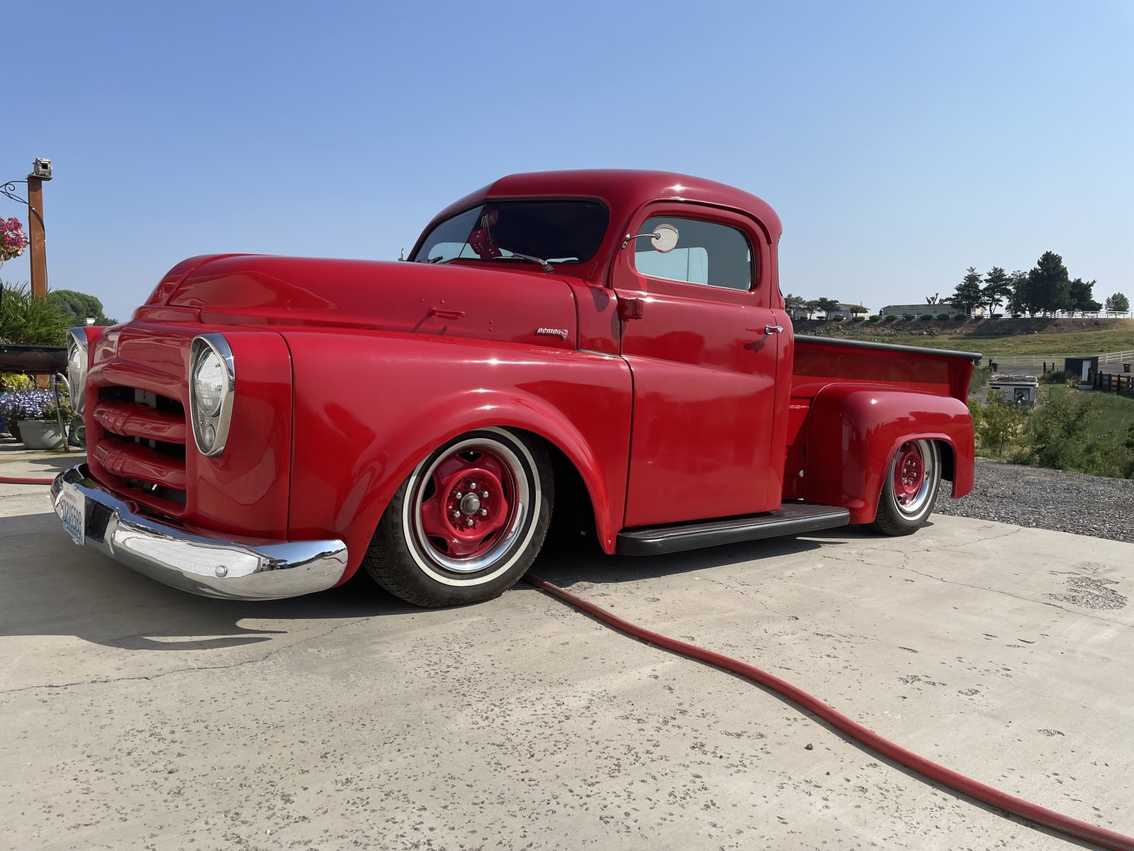

    Nice rig. I'm currently in the process of doing one as well. Did you notch the back of the cab over the frame? I currently have the front nearly in the same position as yours according to your photos anyway but I think the rear of mine sits to high and gives it too much of a rake. Maybe it's on here somewhere and I missed it I'm new to this site so still trying to figure out how to navigate.
    Tow Truck Tom likes this.
  6. Yes. It’s notched.
