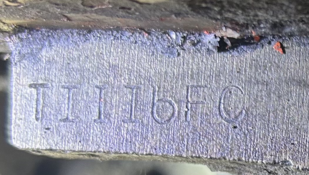

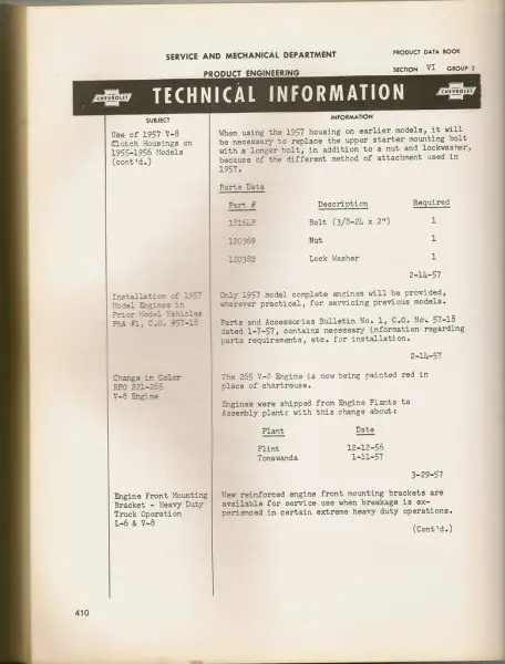

    265's made in the Flint planted were painted chartreuse into early December 1956 and the end of November in the Tonawanda plant, then they were painted Orange like a 283. They call it red but it is Orange. The stamped code ending in "C" identifies it as a 265 but I did measure the bore and it is 3.75". Attached is the GM memo stating the color change.

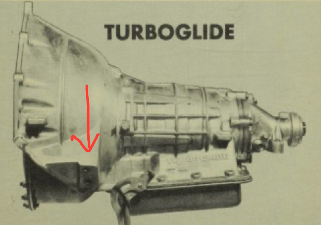

    Looks like the 57 265 still mounts from the front, as I don't see side motor mount holes in the block. If that's the case, then the 57 265's probably were never equipped with Turboglide, as I don't believe the aluminum bell housing had provisions for motor mounts. Block mounted starter holes are probably absent too.

    Here’s a 58 (tailhousing mounting point) unit that still has 57 bellhousing mounting points. IMG_4704.jpeg

    Yes that does look like the mount holes. But does the 57 265 have the block mount starter holes or do they use an adapter plate to mount starter?

    57 265's were two barrel, stick shift applications only. No need for side mounts or starter pad bolt holes.

    Yes, that clears up everything. Funny, you could get Powerglide with 235, but not with 265.

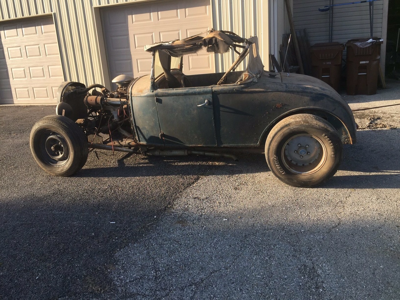

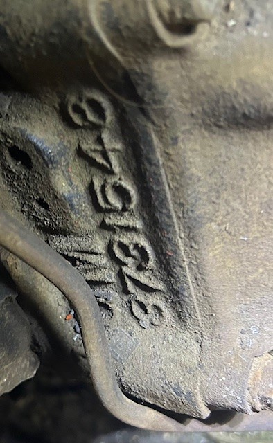

    I've got an early small block that I'm trying to identify that was in this old model A roadster when I bought it. It's got an old iron powerglide attached to it and no side mounts. It has straight across valve covers and I ran the numbers on those and they were early sixties. The valve covers were staggered bolt covers that were old chrome and had been redrilled to put them on the early sixties heads. It's got a four barrell carburator that was from a 1960 Dodge so it was obviously pieced together from what they could find.

    57 283 obviously someone put later heads on it

    What Moriarity said is the case, 57 283. If it were a 265 the last letters would be C, CD or CE for a car and L, LA, LB or M for a truck.
