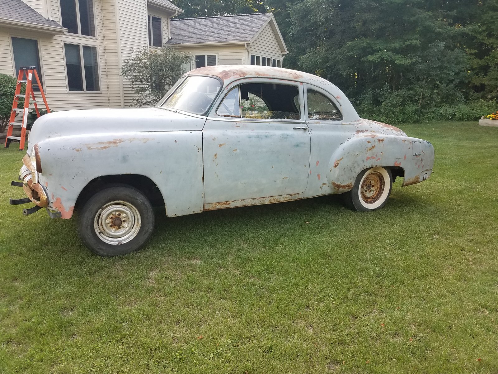

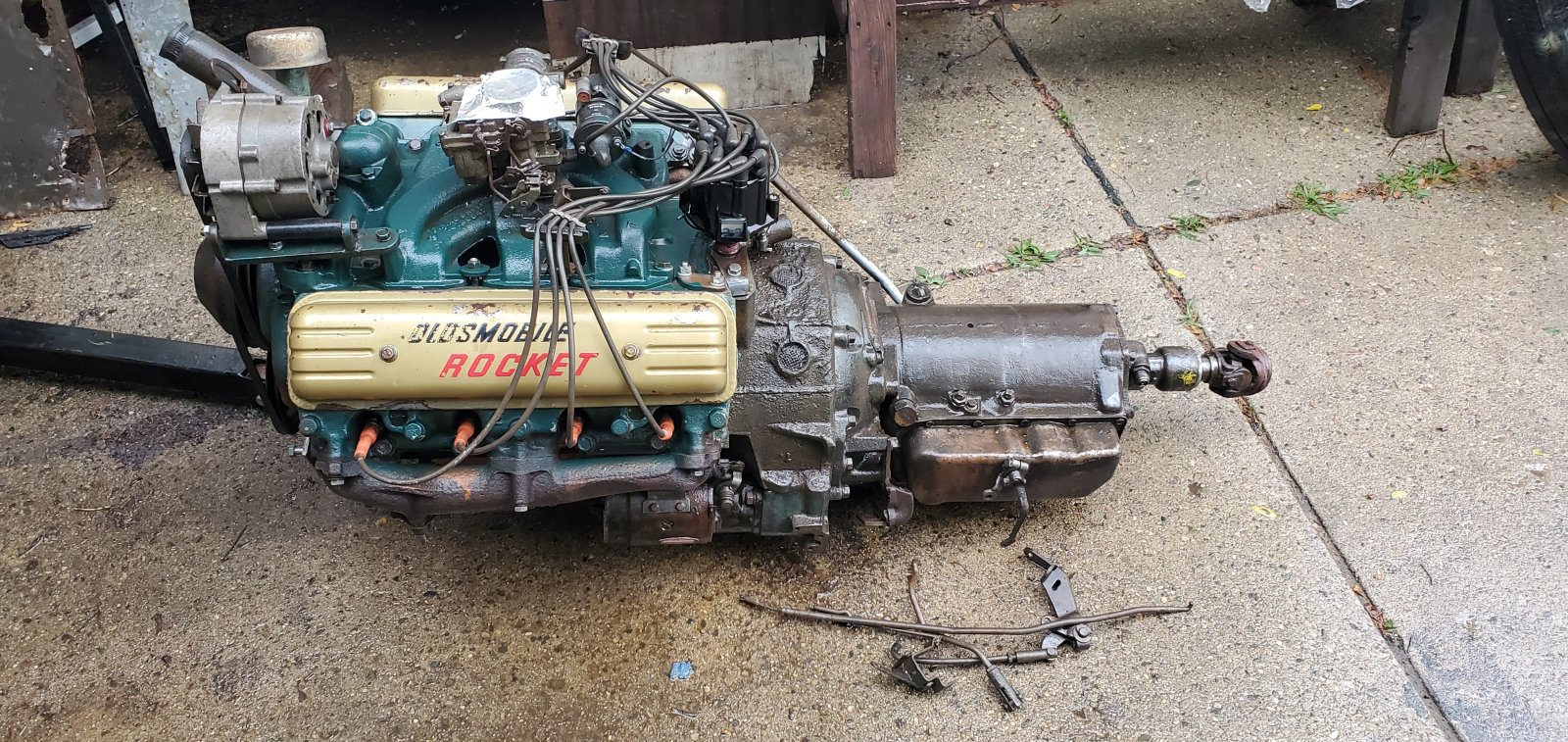

    Three years into my 52 Chevy Business Coupe build I believe I've found the perfect Engine\Trans combo. But first ill bring ya'll up to speed, bought the car 3 years ago and proceed to redo the body, new floor,inner & out rockers, quarter panels,door bottoms Etc... Now that I've completed that I ordered a straight axle kit from Ron Pope (last week) and started to look for a period engine trans Combo. I found a 58 Pontiac 370 with Hydro-Matic from a member on here problem is, its in North Dakota and I'm in Michigan. This brings us to yesterday when the stars aligned and I was able to pick up a complete Olds 303 with trans that had been sitting tucked away for years. Its turns over freely and looks to have been gone those at some point in its life. Even came with all the linkage and mounts.

    as dirty as it is on the parts that are hard to clean, it probably has a bunch of miles on it. If you can start it up and see how it runs, how much blue smoke comes out, etc that would be fun and informative. If it's not too bad, you might want to get it in the car and set up, but plan on going through it later when you're done with all the metal work on the body, etc.

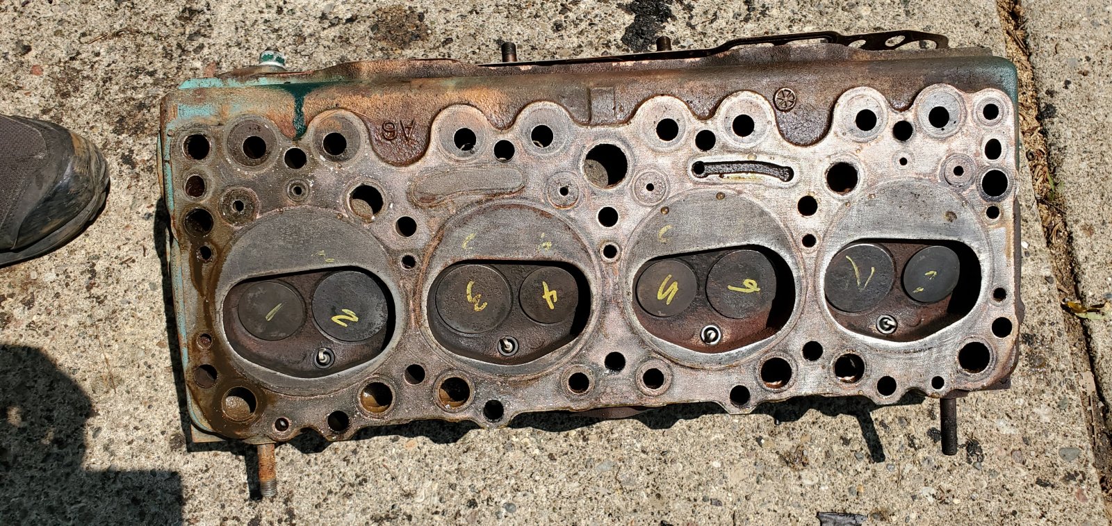

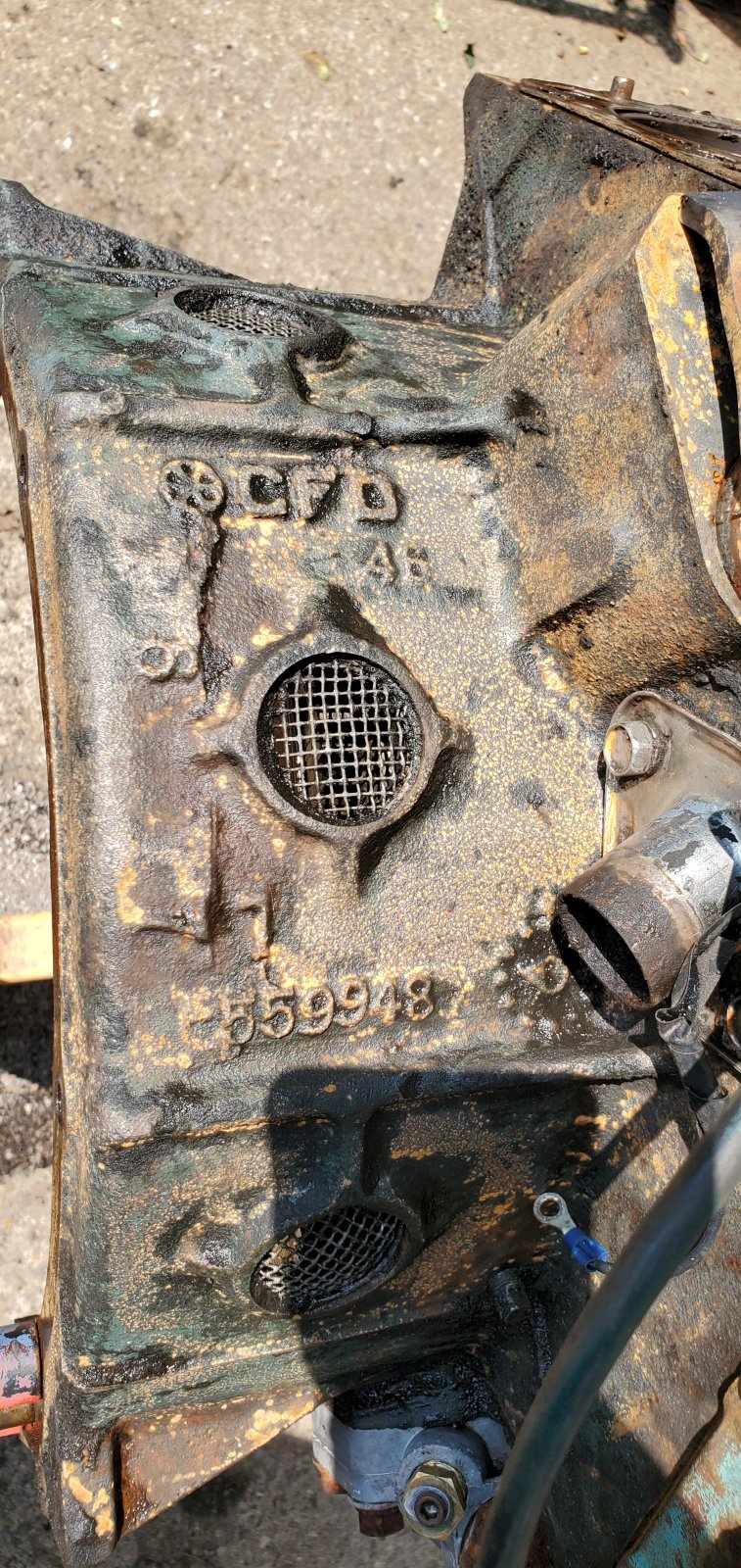

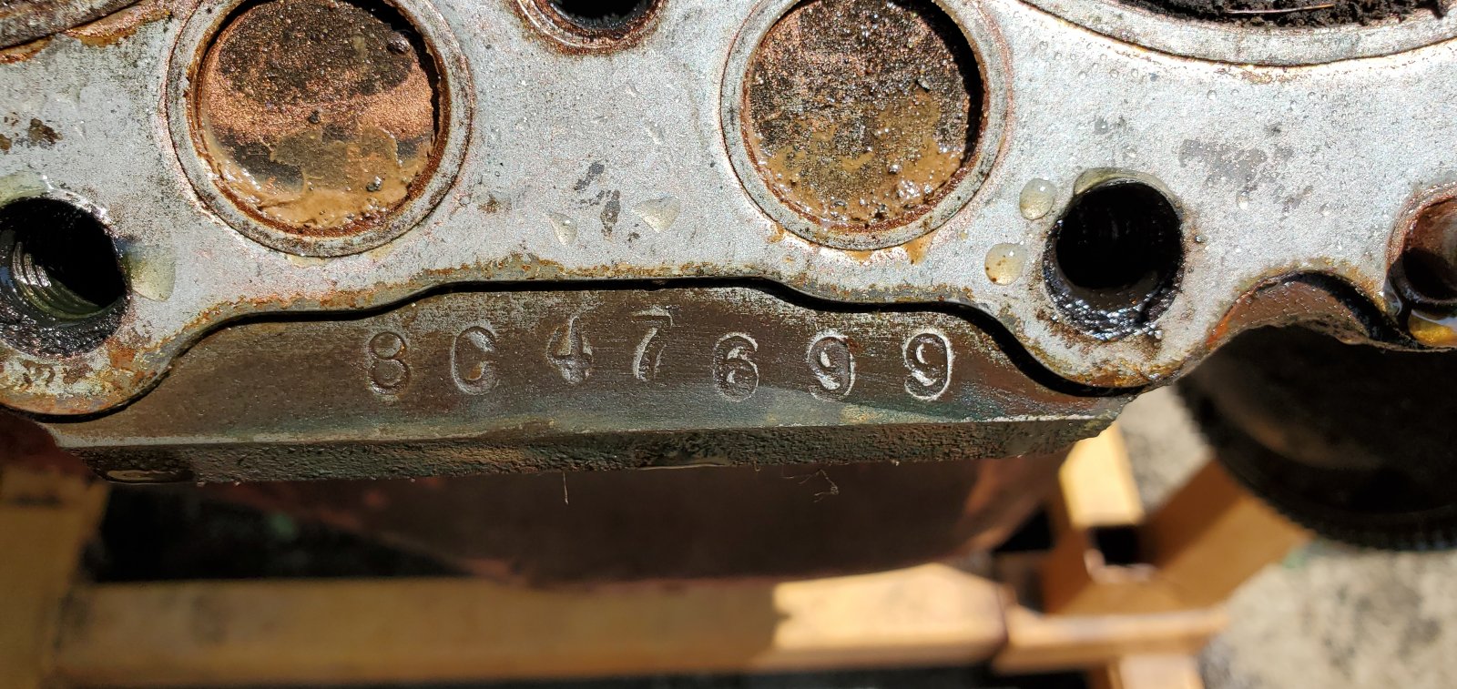

    Well here's what she looks like inside, can anybody identify the year from these numbers.

    Do you plan on getting the car running and drive it awhile to shake it down before final paint? If so I guess you could try to get the engine running and maybe put it in. Yes, it looks like the heads have been off based on the paint stick dots. That vintage engine heads came off for valve jobs all the time, so don't infer that much more than that was done. Your biggest part of the project may be getting the trans sorted out if you are planning on running it.

    8C should be a 1951 303?

    Just a question, the last pic in the first post shows two bolts sitting at an angle along the rocker shaft. I guessing they are for the valve covers? But as I look across the head I don’t see where they bolt in to.
    Just curious.
  8. 1twisted1
    Joined: Nov 26, 2011
    Posts: 184
    1twisted1
    Yes these are the valve cover bolts
    Budget36 likes this.
  9. Budget36
    Joined: Nov 29, 2014
    Posts: 15,436
    Budget36
    Thanks. Where the heck do they screw into? I’m not seeing it in the pic. Lol.

    Small bolt hole next to the head bolt

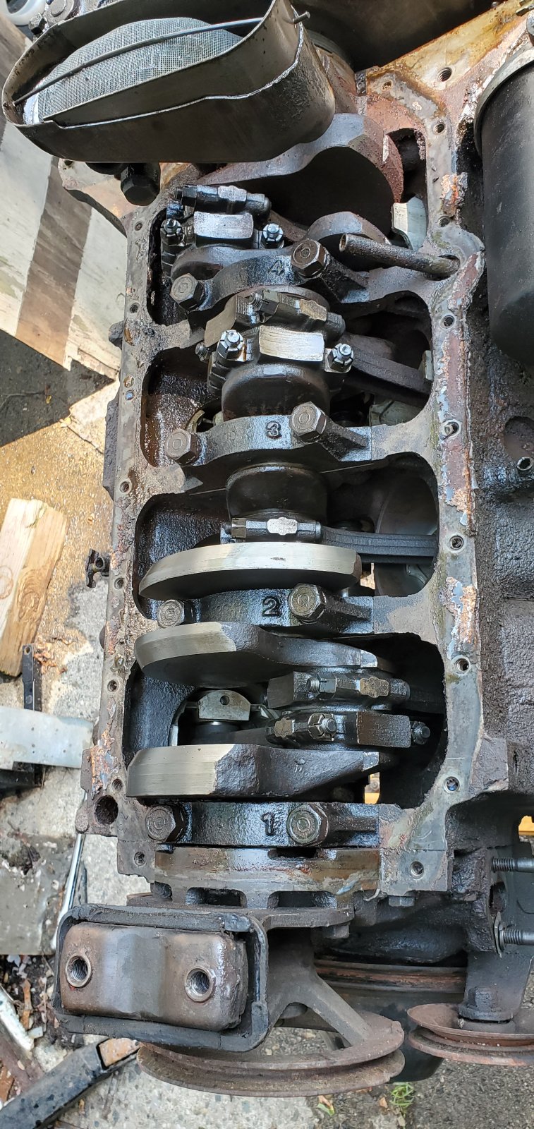

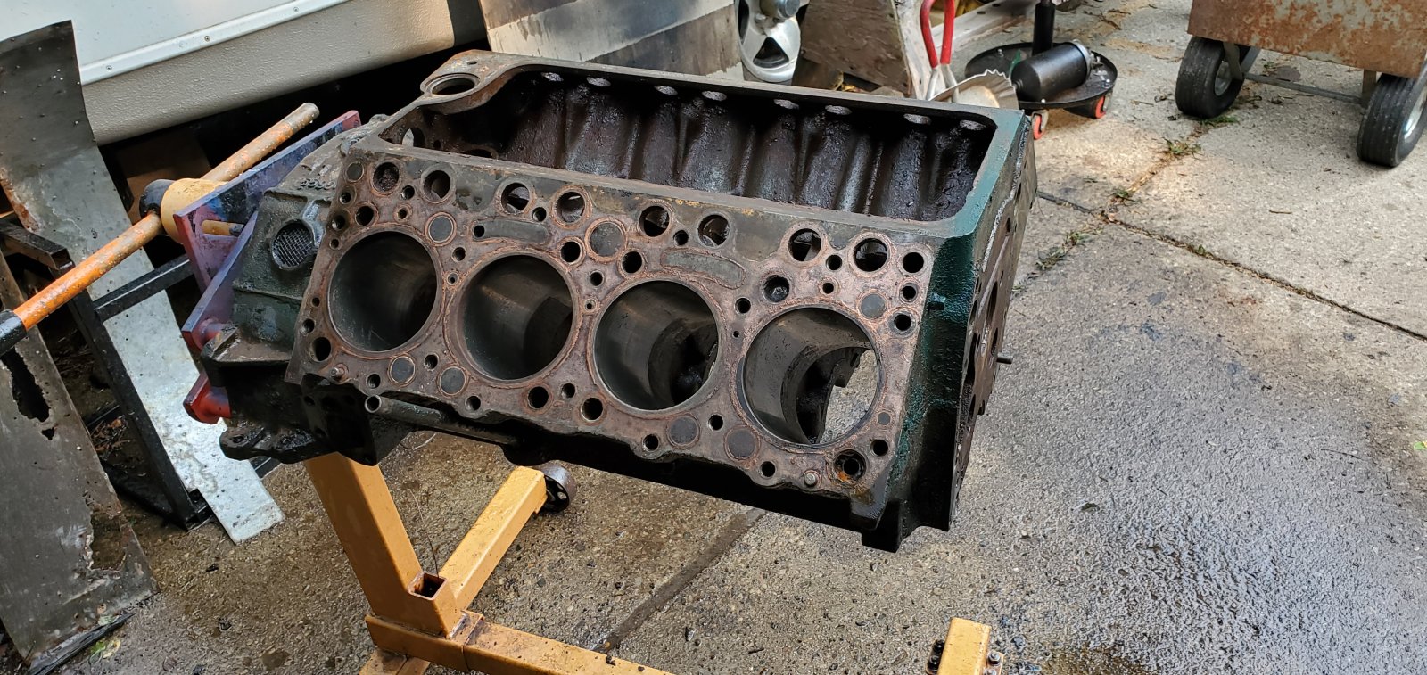

    Well just like with what happened with the body I saw something i didn't like and apart she came. Glad i did, 5 lifters where stuck internally, four pistons had broken top rings, the bottom end was covered in rust and pan was full of sludge. block still had the factory GM pistons and is stock bore with wear. On the plus side all bearing surfaces look great.

    You don't see them because those bolts are screwed into the holes where they belong.
