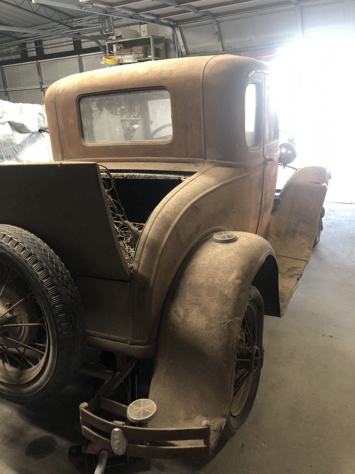

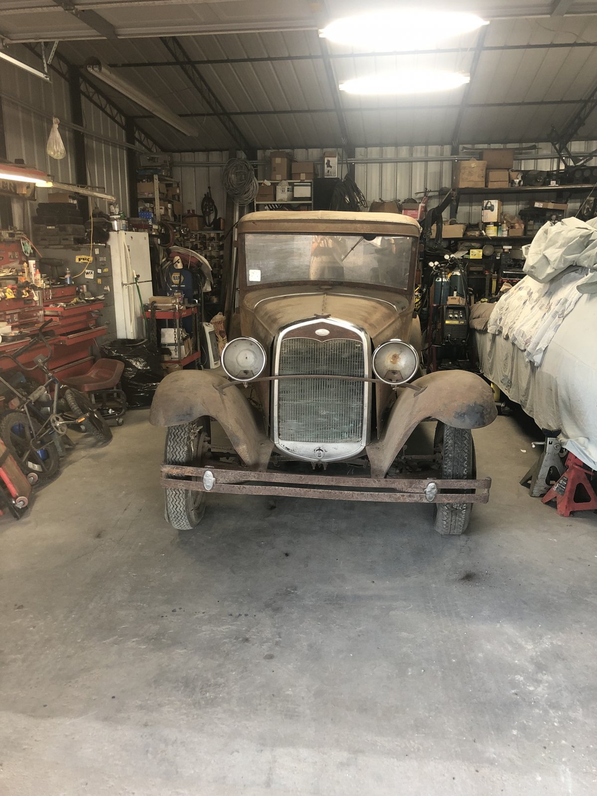

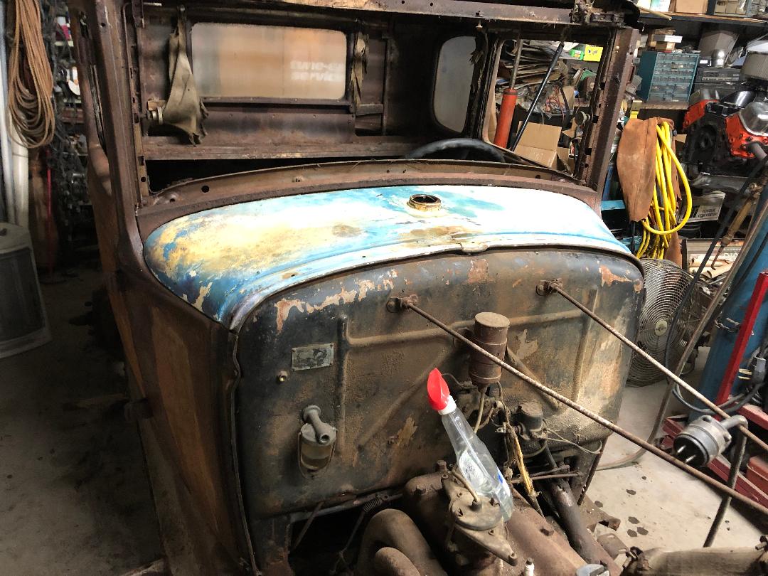

    Been a member here 13 years today. This one will be Hamb Friendly. Going to soup up the banger a bit, clean things up & straighten it out. 138ACCA2-6283-4B11-9A49-CF9EB0FA841F.jpeg 117A0818-B96D-4640-B25C-FF6B9D811BF4.jpeg 138ACCA2-6283-4B11-9A49-CF9EB0FA841F.jpeg 6FF63226-034D-486D-B120-9624719E584F.jpeg 117A0818-B96D-4640-B25C-FF6B9D811BF4.jpeg 138ACCA2-6283-4B11-9A49-CF9EB0FA841F.jpeg

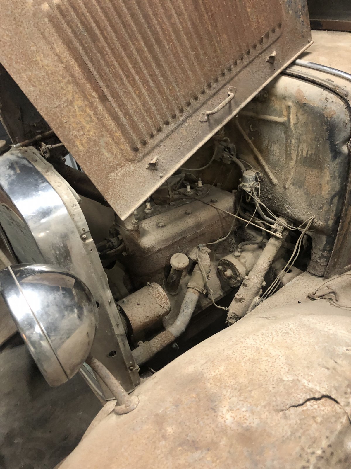

    Major accomplishment tonight. Engine was stuck. Filled the cylinders with Marvel Mystery Oil, some that I have had for about 30 years or so that was in a metal can. I think it was different in the metal can before they started using plastic bottles. Probably had some real good carcinogens in it that got left out of the newer stuff. After just 24 hours I was able to turn the engine by hand like it had never been stuck. Went through a couple cans of PB Blaster on just about everything on the car. Be great if I could fill a small swimming pool with PB & soak the car in it for a few days.

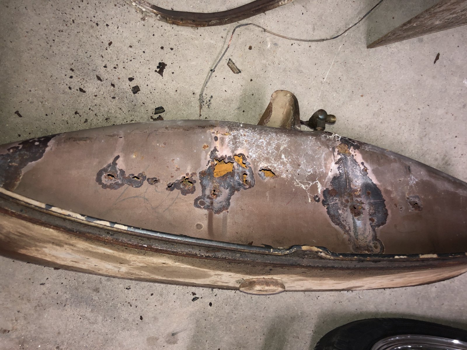

    Got started with the tear down. I’m going to need a gas tank. If anyone sees one for a 30-31 please let me know. Where’s the best place to get some replacement pre shaped floors pans?Need piece behind front seat & under rumble seat. Also going to need rear wheel wells. The wooden seat front seat frame is in excellent condition & both front & rumble springs are reusable. I will go back with the factory seats. What covering is acceptable for a traditional hot rod? I’m going to use the banger but soup it up. Want to get a crankshaft with counterweight or put them on the one that is in it & have the engine balanced. Would also like to have inserts if that would be traditional also. I have a lot to learn about building a traditional rod but I’m at the right place to get the information that I needed to do one. BC47994B-670D-43F6-8EC4-E0B115FF3ADA.jpeg 063EC224-736D-4363-8926-31BD964268D3.jpeg 34F61FA1-4890-46CC-BCCF-076CB8709E32.jpeg 7D44CD42-E924-4AAD-B037-F115B3735145.jpeg 024339A0-0741-4883-B8E1-8C071E8DFEBD.jpeg 876A8F88-22D6-4042-AB59-192B9F75A306.jpeg

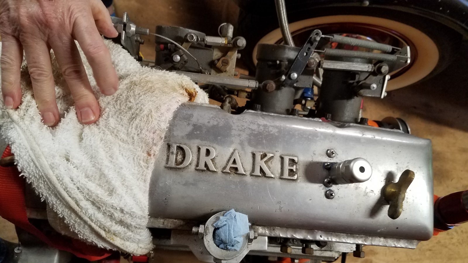

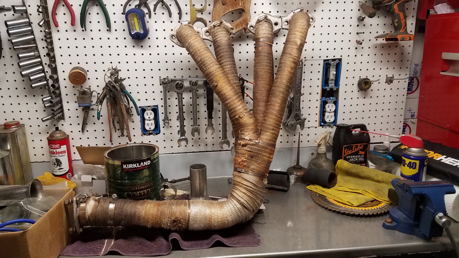

  14. What part of the Country are you in? I have a good solid tank. If you want to save some time and have a Kick *** banger. I have one with a Drake overhead conversion and Hilborn injection. It will get you to town in a hurry. Live wet and ready to go. Matter of fact it set a L.S.R. in stock body Model A. It already has a balanced crank and insert rods. I think you may need to split the wishbone to get the header in.

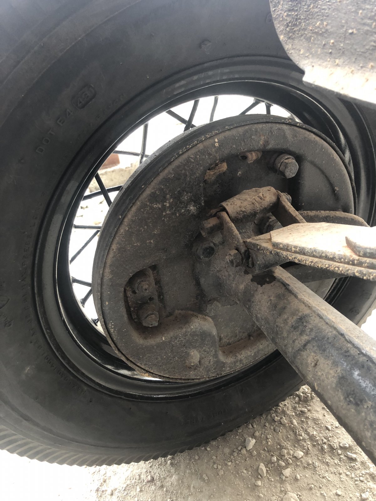

    I think I found a gas tank. Also another 31 coupe ch***is with a good running gear. This guy bought a running 31 Ford Coupe & is having a aftermarket ch***is built for it. He also said he has a set of 16 inch factory spoke Ford wheels with new tires. It's going to be about a 900 mile round trip this Saturday but I'm going to go get it all. Everything on my ch***is is wore out. I'm going to dis***emble all of it. The king pins are loose in the axle & I'm suspecting the king pin holes are wore out in the axle. No big concern there because axles are easy to come by & they can be repaired also.The batwings are shot, bushings wore out & they kept driving it. People had to drive with wore out parts back then because money was scarce. My Dad & Grandfather told me plenty of depression stories but that's a whole other topic so I'm going to stay focused on the coupe. The speedometer shows 81,000 miles. My car doesn't looked like it was ever in a wreck so I'm thinking it was driven until it wouldn't go anymore. The roof was filled in with galvanized metal that looks like it was some kind of old water tank or feed trough. Whoever did it screwed it on with metal screws then leaded around it. Personally I think they did a good job. There wasn't no bondo back then.It has a seam in it but it is off center from the body center line. I'm going to paint it flat black & it isn't going to be a trophy winning show car so I might just leave it that way for now. In my opinion it will give it some character.Not bragging but I'm capable of welding in a 1 piece roof or replacing the wood & going back with a soft top. I'm one of those people that does almost everything myself that I can do in my messy shop. If this other ch***is is a runner that will make getting it on the road a lot faster. It's going to take me some time to gather parts & get machine work done to build a good engine. Model a roof 2.jpg Model a roof 3.jpg model a roof 4.jpg model a roof 6.jpg Model a roof5.jpg modela roof 1.jpg

    I'm still droolin on the Drake!

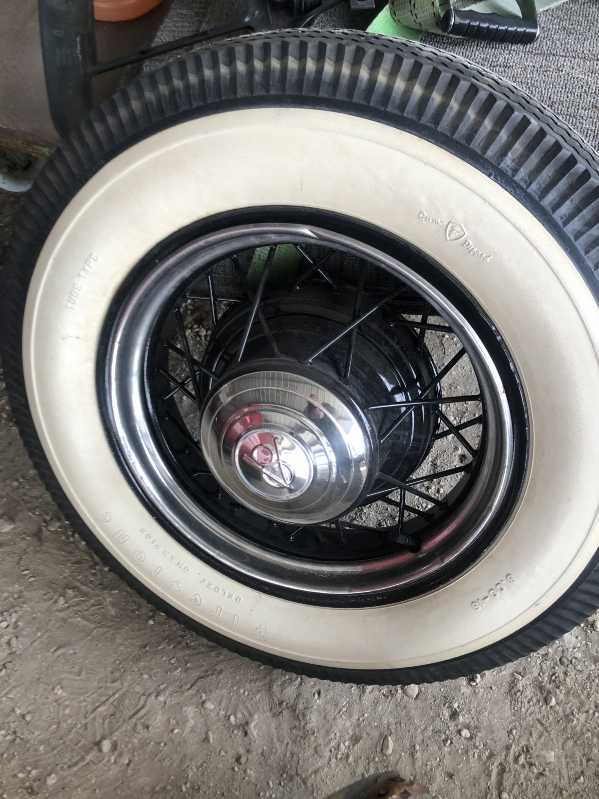

    Got a good gas tank!!! And a good spare gas tank!! And a better dash than what I have. Also a better than what I have ch***is. Plus it has juice brakes. Also some nice wheels & tires.Going to clean it up & make a few changes. Very nice man that sold me the parts. He is building a 31 Model A street rod & having a ch***is built & this is some of his leftovers. I swapped him my rusted out tank for his good one. He definitely a good car guy because he didn’t want to cut the bottom out of a good A tank. He was looking for someone like me that he could swap tanks with. I asked him if he ever got on the Hamb & he didn’t know anything about it. I helped him set up a user account so if y’all see Dan Estes on here please welcome him aboard. He has some very nice rides in his stable. Thanks again Dan if you see this! 0204F644-971A-40A6-8E7A-E8E3B3DFA705.jpeg 2E79672E-A760-46D6-8BFA-E534C036B6FA.jpeg 13BE6C94-9AA7-4C60-ACD1-13DB025D0DBD.jpeg 2CB8F0B1-E5F7-47F7-A5BB-0618CBE484AB.jpeg 9417423C-3E26-4C7D-862D-20D9FC27D25A.jpeg 9617B846-4858-4594-A085-FCB059341237.jpeg 2EE0458B-6698-4793-BE05-7678B22E2089.jpeg 23C9827B-9DEF-47FF-AAEA-0C814B6BA894.jpeg

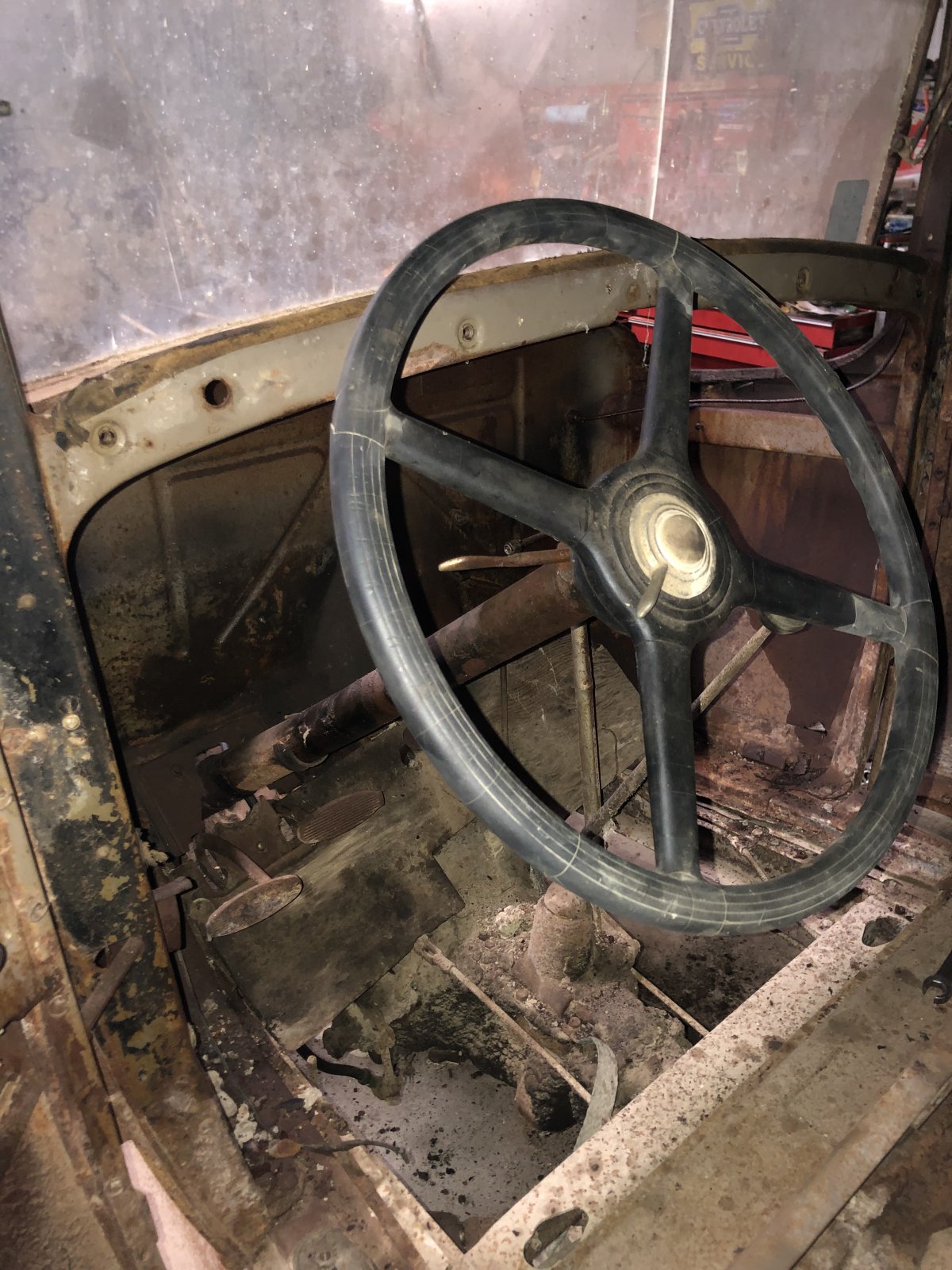

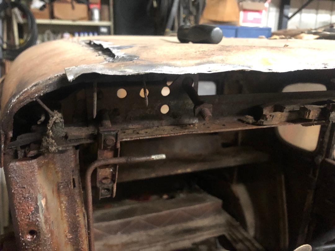

  28. Robbie Horn
    Joined: Jan 13, 2009
    Posts: 194
    Robbie Horn
    from Axtell

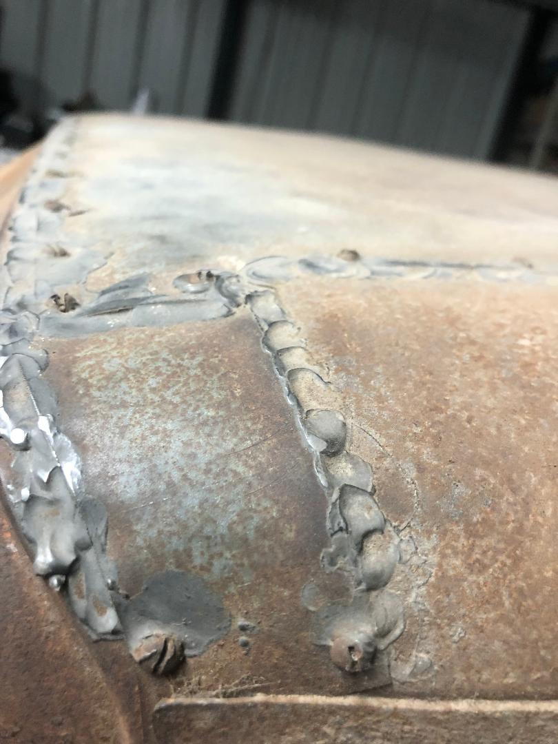

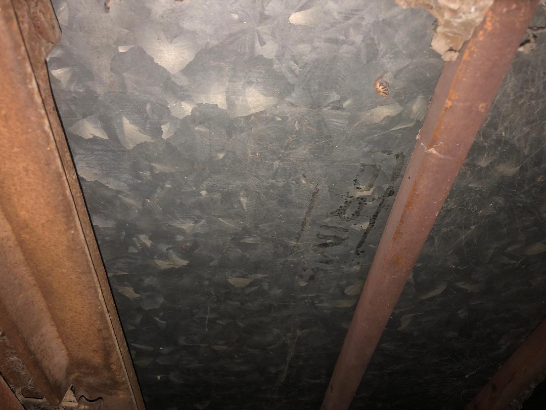

    After some serious contemplating I realized that to do this right I need to replace the header wood behind the windshield & probably all the roof wood. To do this the visor & windshield has to be removed.So I got out the can opener & removed the home made galvanized screwed & leaded on roof filler panel. I'm going back with a factory vinyl or what ever that stuff is soft roof. It gets hot down here in Texas & this one will never have a ac & a metal roof makes them more oven like in the summertime. I will be driving this thing on the streets ( and on the drag strip,going to see how fast it is), it's not going to be a trailer queen. I got the rear fenders off & the running boards off. Thanks again PB Blaster. The running boards look like they can be reused. Instead of straightening out my fenders I'm looking for someone that is building a fender less creation & has a nice set of steel fenders up for sale & latch onto them. I also test fit the new to me 901 miles, one day round trip gas tank I acquired this week. looks like it fits pretty good. If everything goes right I should have it ready to start sandblasting this weekend, weather permitting. Model a 7.jpg Model a 8.jpg model a 9.jpg model a 11.jpg model a 12.jpg
