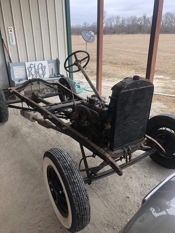

    Got some progress made this weekend. Got the body sandblasted & primed inside & out. Going to put it on my runner ch***is next. sand2.jpg sand1.jpg IMG_4671.JPG

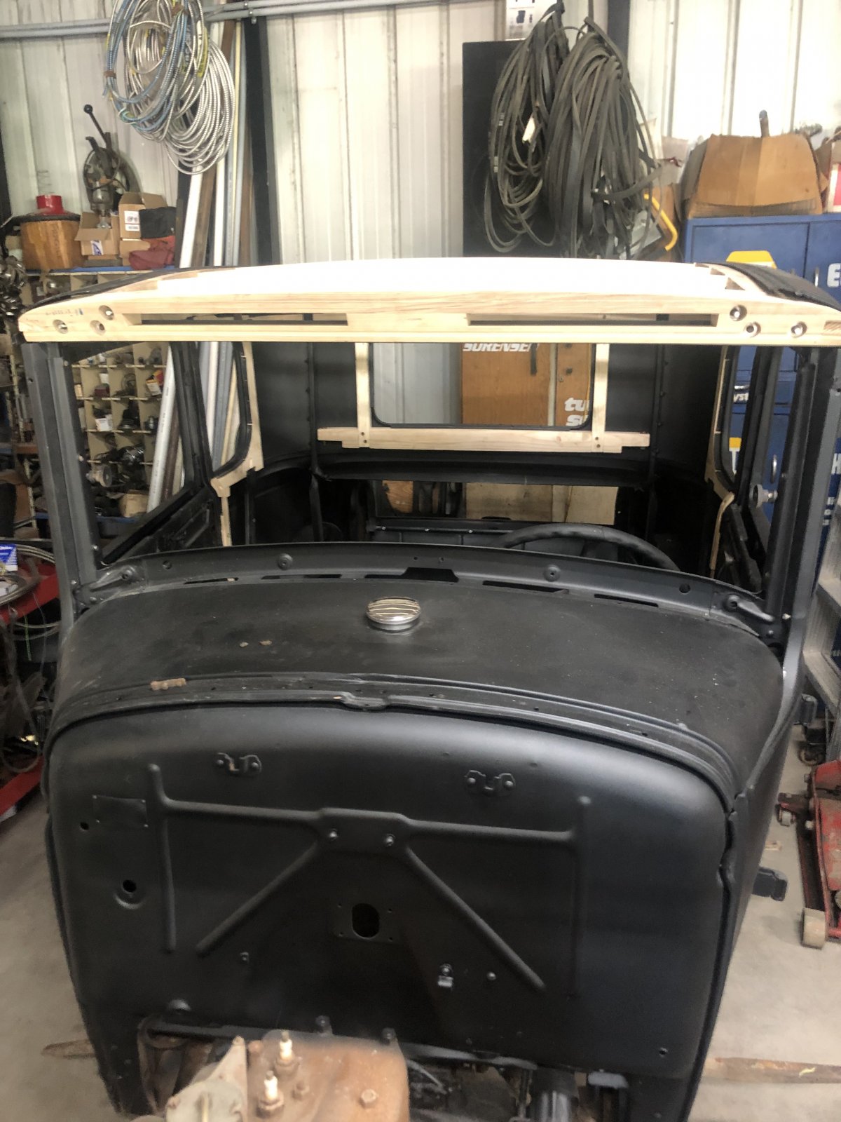

    Update! New rumble & floor pans installed. New lower & upper wood installed. Currently working on the ch***is. Just installed new king pins. Waiting on reverse eye springs to lower it a bit. Still going traditional with banger engine. Got juice brakes from a 40 Ford.

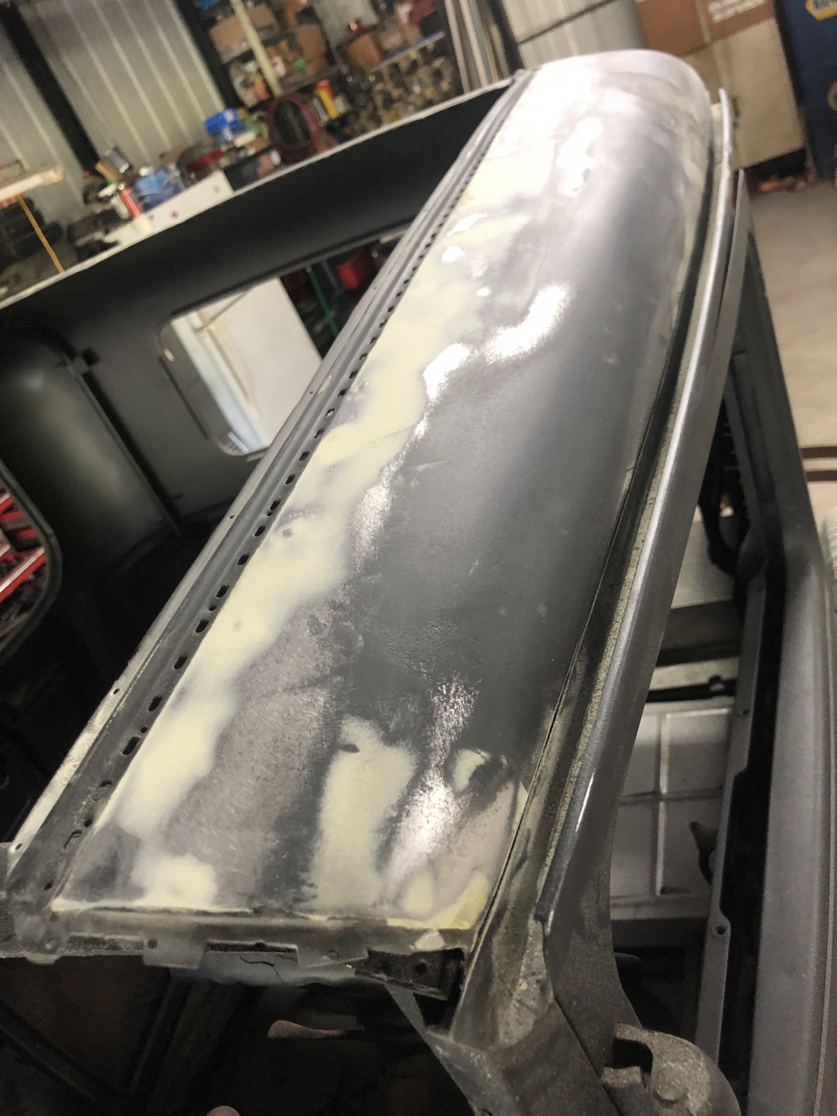

    Photos of how I repaired the holes in the roof from the previous metal cover that was screwed on & leaded around. I’m going back with a stock roof. 4DD1FB34-F0A6-4914-810E-F182A3A32B7F.jpeg 4E387840-474E-4A45-8525-5D612A35F1A1.jpeg F7D79B49-3EFE-4965-ADC7-FD5CC03109CD.jpeg 59D37784-6719-4A73-AA73-C825AE96F406.jpeg 297D74F0-8FB1-41C1-BE91-2F7ADEB6BAA1.jpeg E4039F40-DEA1-41FD-99D6-30B1CD576348.jpeg

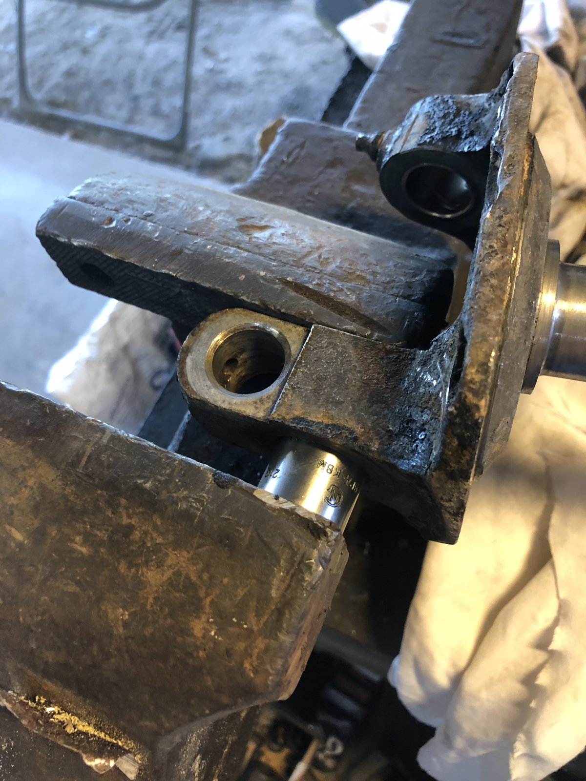

    Pics of installing & reaming the king pins. Used my vise to press in the new ones. Borrowed a reamer from my cousin that he inherited from a family mechanic that worked on Model A’ s long time ago. It worked excellent. A1AFB156-EF65-410F-86AA-E81A3D06DA3F.jpeg DC14B111-9E42-44CA-96A3-0CEF2F05D0FE.jpeg B39D31BF-B0D4-4760-B607-4519DD8854A2.jpeg AB4EAFD4-9CC0-4FE3-99D3-53523E7DD630.jpeg 7B0572D0-B1FD-40AE-8F15-F902E126B559.jpeg 03D75D84-27E7-4D20-AB35-16602808661A.jpeg
