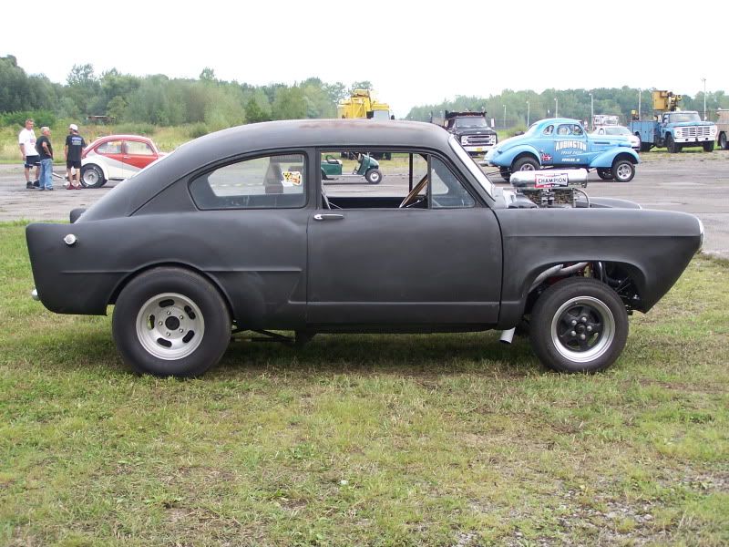

    Look at that little squeak of the front left off the ground lol
    The contact of the slick looks pretty good though
    staging lane

    Car looks great even with the battle -scarred quarter panel. 1.5 sixty footer is good. Great to see that left front wheel off the ground. Glad your having fun (finally!) (not sure about the pit bike... :D )
