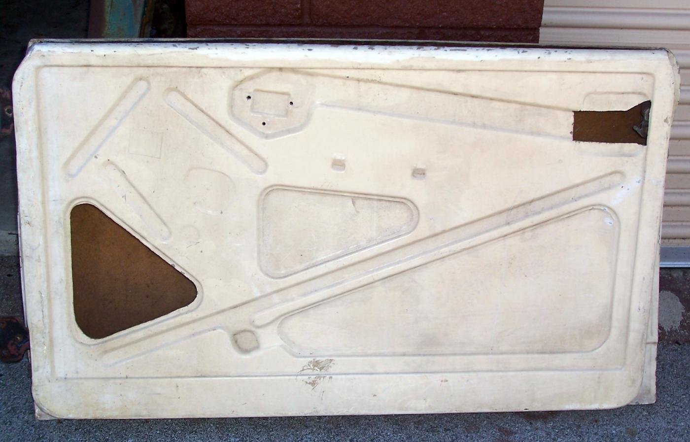

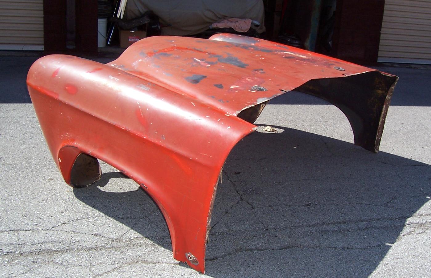

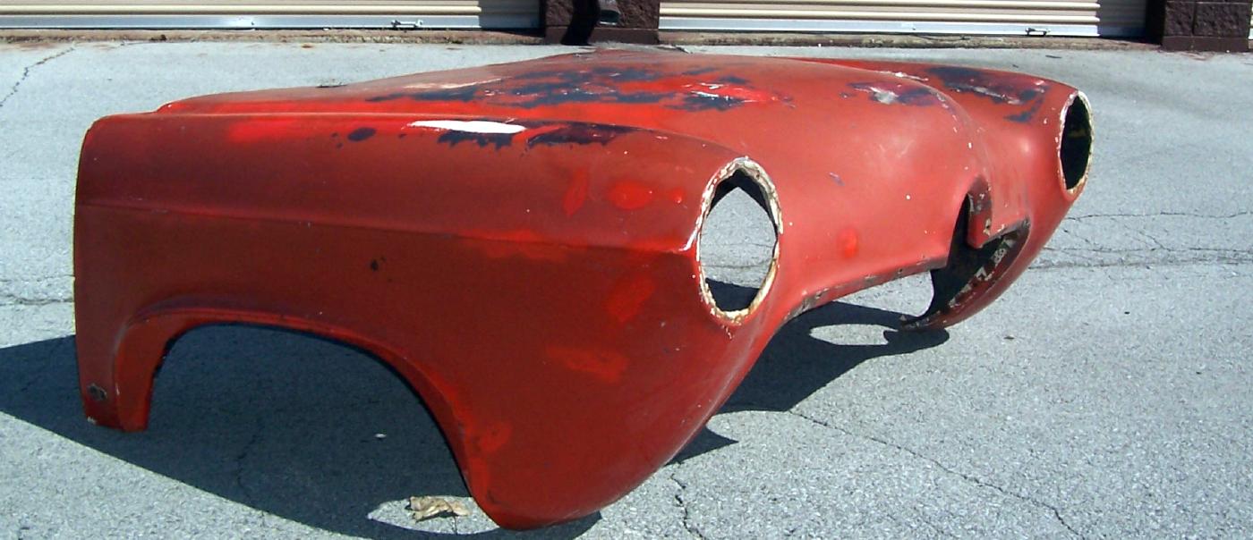

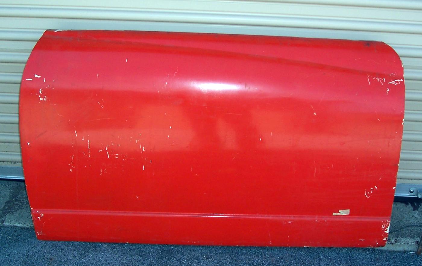

    Thanks to the cl***ifieds here, and a good friend for picking them up for me, I now have a fibergl*** one piece front end and a pair of doors. This stuff is much lighter than the steel and was on a car in the past as a lift off not tilt.
    So over the winter I will replace the front clip, two doors and one quarter....wow

    Hey Phil. Nice find. Front end looks to be in good shape. Nothing like losing weight to go fast. What does the car weigh now ?

    It was 2360 without the hood so right at 2400, hood is light. I need to loose MY spare tire and then we could really be light weight ha ha
