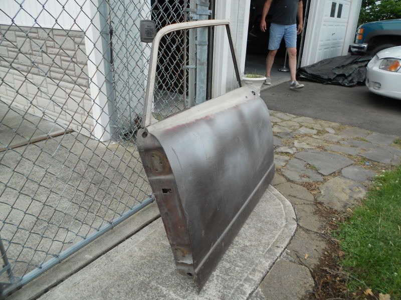

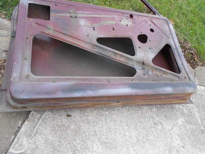

    Devin, I am using the top of the window frames out of the original doors which have the gl*** tracks all in one. The regulators and door latch stuff bolt to inner door panels just like stock.

    Yes they do, they extend almost to the bottom of the doors, you can just make it out in the stock door photo on the right side. One bolt at the top and one at the bottom on each side. The frames that came with the doors have the vent window track cut out for what I presume for use of one piece window.
    The round holes are for the bolts

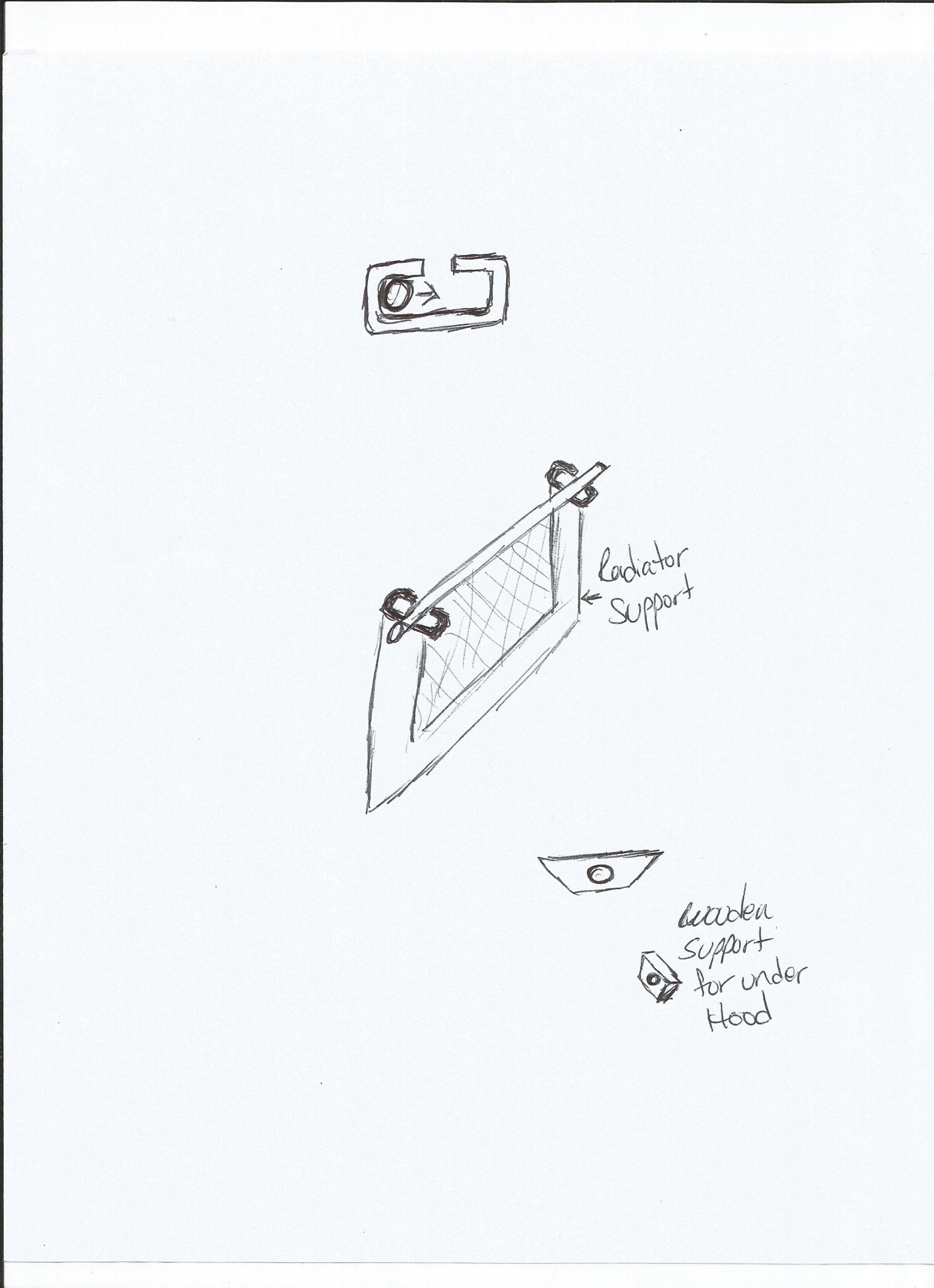

    This is how I want to do it. Weld a "C" plate on top of my radiator support which will have an opening in top just wide enough for the tubing to slip through.
    This "C" bracket will be about 5 inches long, the opening will be in the middle so will allow the front to be slid forward past the opening and then be able to tilt. All the way back is in the closed position , once again on the other side of the opening. If you slide it forward to the opening and lift up, the whole front clip will be able to be removed.
    If you notice the lower half of the rear of the fenders are cut off and capped original fenders and at the bottom with a latch. The front should slide forward on the capped portion then be able to tilt without interference.
    This should be pretty light as it will only have one piece of tubing and the two brackets. I will weld a washer on each end of the tubing just on the outside of the brackets to prevent side to side movement. The tubing will be attached to the under side of the hood via standard fibergl*** and wood method.

    Good idea. Just have to make sure the nose slides forward enough so that the front of the fender (frt lower) clears the front tires when opened.

    That will be the same effect hopefully, I cannot put a slide forward hinge at the frame on this because of the Eelco tank. It prevents doing any kind of cross bar in that area, lot of stuff going on in that area too, tank,radiator and trans cooler.

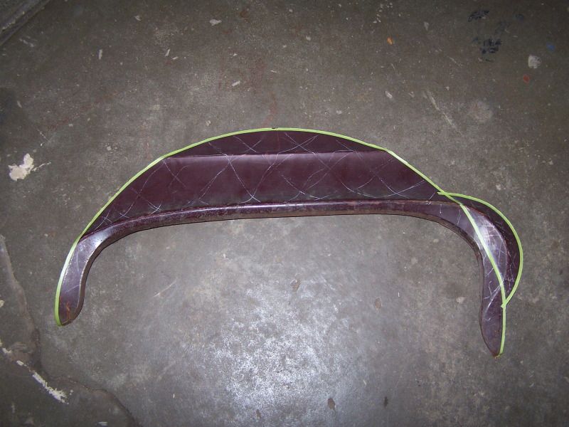

    I drug the camera out to the garage today, didn't do much other than sand the first coat and apply a second. I also fabbed up some wooden blocks to hold the tubing for the tilt part and figured out a way to make it adjustable up and down.
    Here's the section I cut out, this time around I knew I needed to cut that extra part out of the fender with it.
    Here it is with the first coat of filler, these fenders will drive ya bonkers with all their curves. I checked out several other Henry J's and they all look the same after the radius is cut. The top of the cut is further in than the middle and the front of the fender has a bulge that the rear doesn't. Bonkers !
